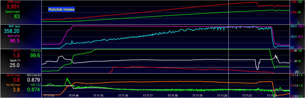

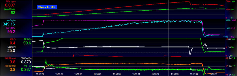

Here is a snapshot of the runs for each. You will see the commanded EQ (white) and the WB (green) lines. If the MAF output is not skewed they should sit on top of one another. The Rotofab intake did NOT upset the MAF calibration in any meaningful way. I am very impressed and to be honest did not expect this.
Rotofab did an EXCELLENT job keeping the MAF from getting screwed up. The vertical cursor is where COT kicked in.

Concrete information here and when paired with dyno results will be irrefutable. Thanks for this testing process Tim anxiously awaiting final overall results.

What about maf accuracy beneath the torque curve, where the system will spend most of its time? Great work!

The part throttle area looked really good. Nothing to really comment on there.

So what is happening when CoT kicks in? Knowing CoT is kicking in on both stock runs and Roto-fab runs now, where on the dyno the stock runs were not seeing it kick in.
Either or, just wondering what is happening.
Doing a ton of runs today while I can. I want to make sure the car can cool and relearn the new systems. Unlike the dyno, I am doing 3 cold starts and drives and putting 30 miles between each system's install.

The threshold when COT turns on is a calculated temperature of 1697F. Above that temperature it will start to progressively add more fuel to cool the cats. It starts out very small so impact is of really no consequence on a street blast.
I will be very curious to see your stock and Rotofab logs. I know you don't have a WB hooked up but I will be able to tell from the injector pulse widths if you are dumping extra fuel.
