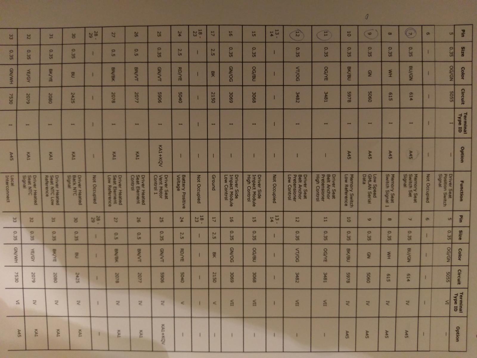

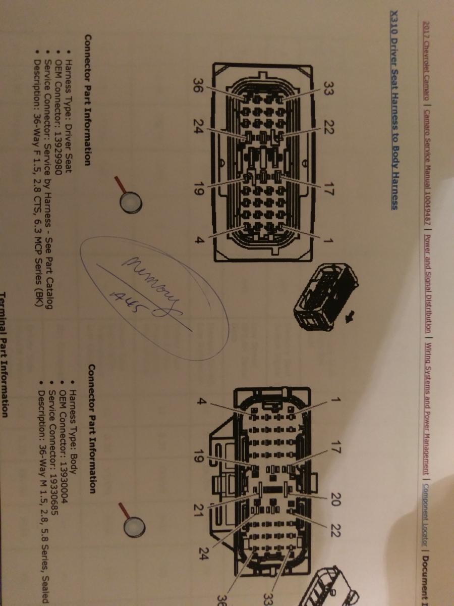

Here's the drivers side.

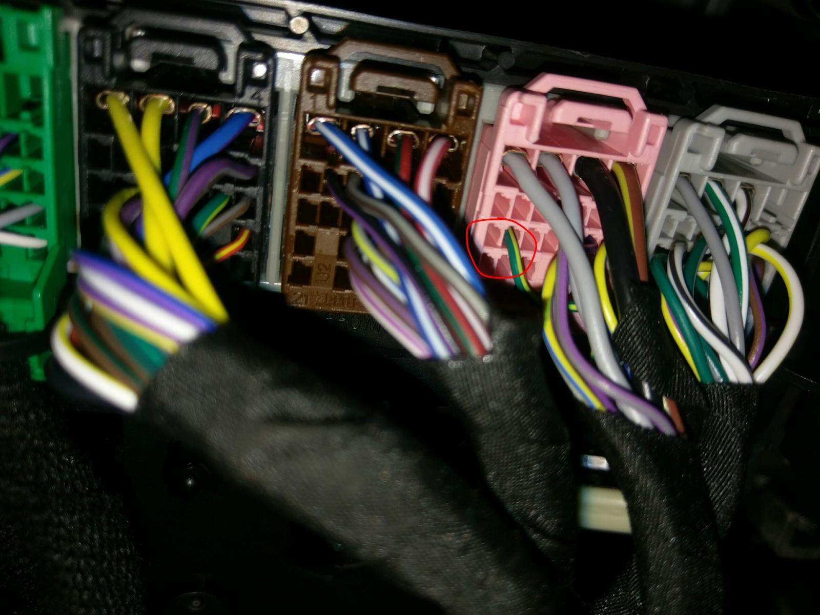

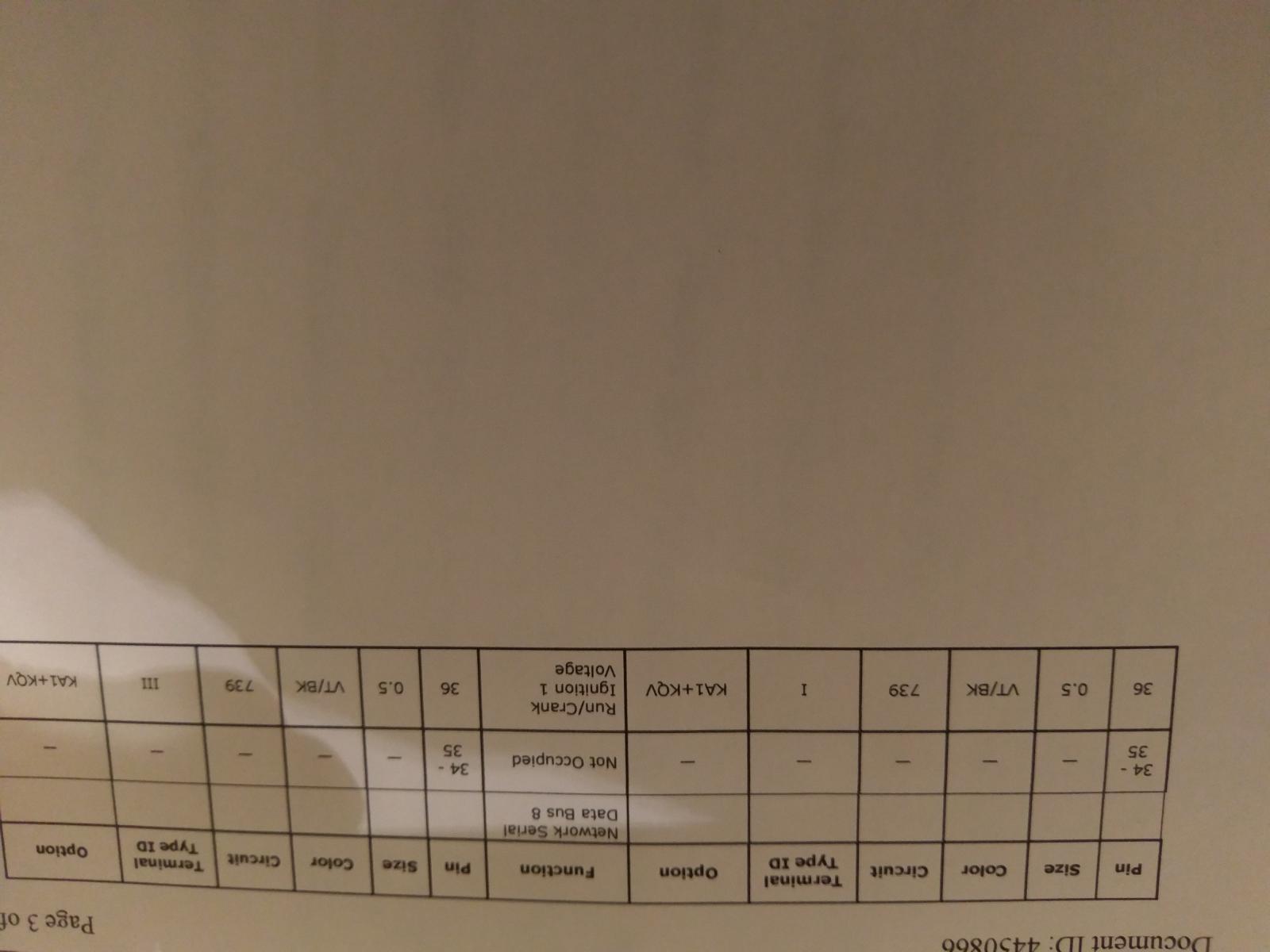

According to the BCM circuit diagram bus2, pin 9 on connector 6, is only used for heated seats and auto trans indicator.
Memory seats use bus8 or 11.
This is from a 1ss. Missing bus2 wire. To the left of GN/YLW wire.
