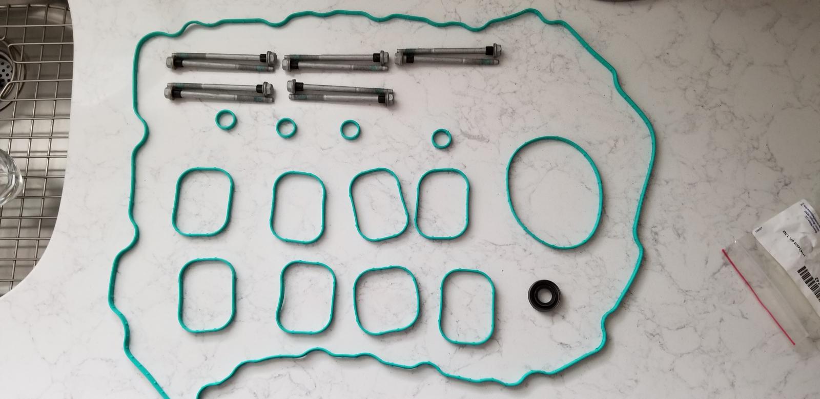

The lid bolts are reusable, it is the supercharger to head bolts that are one time use.
M6x195mm.
Something to think about on those bolts:
1) they have a sealing washer between the bolt head and supercharger housing
2) they have a 'centering/anti-vibration' insert just below the bolt head
both of these can be reused, with perhaps some sealant, but they may effect the torque of the ARP bolts. IMO that should be discussed with ARP to see what they say

there are two different ones, 15 of the 'regular bolt' type and 5 of the bolt with a stud.
the threads are M6, i don't know the length, but they're all the same length below the head. pull one of yours out and measure it.
the pic is representative of the bolts..........they're some spares i had.

GM 12679527 bolt and gasket kit, it has everything you need. Not sure about the availability/lead time for you though
