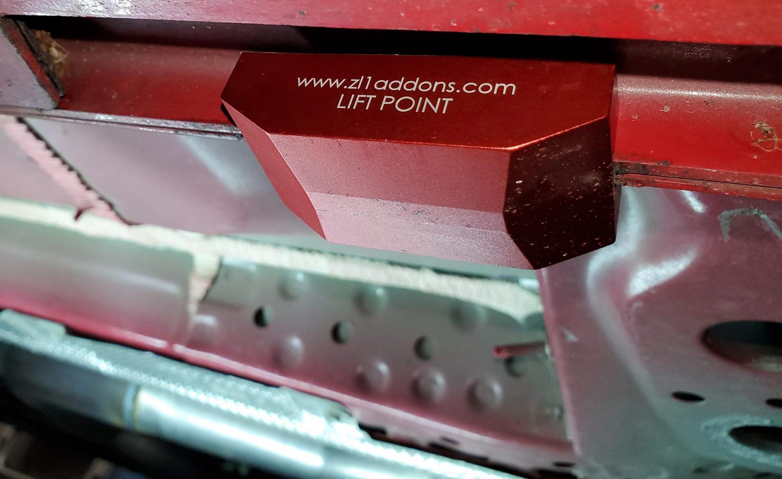

1: I lost one on my last car so I use loctite red (permanent) but in all honestly blue should work fine, just use something on the threads
2: the ends of the set screws are flat so it wont dig in to paint unless you use so much force you bend the allen wrench
3: have only had my SS vert a week and haven't had my car on my quick jacks yet so cant tell you the best way
Here's a couple pics of the jack pads installed
joekd is offline   Reply With Quote

Thanks!
When you lost one, did it do any damage? That is my big fear about leaving these on, but I know a lot of people do without issue (I will certainly use blue Loc-Tite)
Nope, didn't even know I lost it until I went to lift the car and saw it was missing
ZL1 addons was great, they sent me a single replacement at no cost
