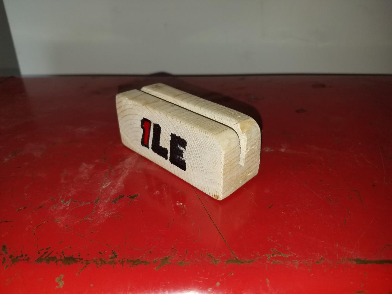

Rainy day today so I decided to custom make a jacking block for wheel swaps...
Just a piece of 2x4 CROSS CUT so load in across grain. Works perfect. Holds in place and comes off easily after jacking.
Dimensions of kerf are 1/4" wide at top x ~ 5/8" deep - tapered (cut with sawzall to get the taper). Length of 2x4 section is 1 1/4" long (1/2" land + 1/4" kerf + 1/2" land). Lands and bottom of kerf all bear load.
Sanded and "custom" lettered! Doubles as a business card holder!!!

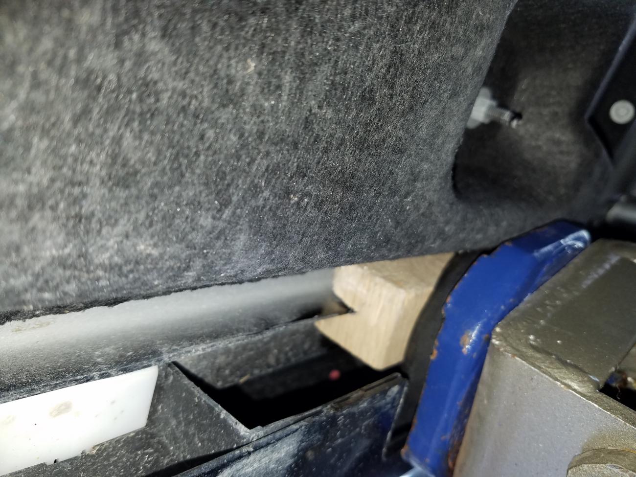

I use it with a hockey puck and low profile jack...

Got the stock wheels and tires swapped back on this afternoon. Worked great.

Posts: 669
Originally Posted by MAGAUSA View Post
Good to know it comes off easily after jacking...
Trick is get the kerf big enough so it comes off easy, but still holds while positioning jack and puck...1/4" at top tapered to about 2 blade widths (1/8" or so) at bottom of ~5/8" deep kerf was about where I ended up after some trial and error...
Test fit along the way to figure out exactly how deep to make the kerf, as well as determine how much material to take out of the tapered kerf so it "grabs" to hold in place during positioning, but still releases easily after jacking...
