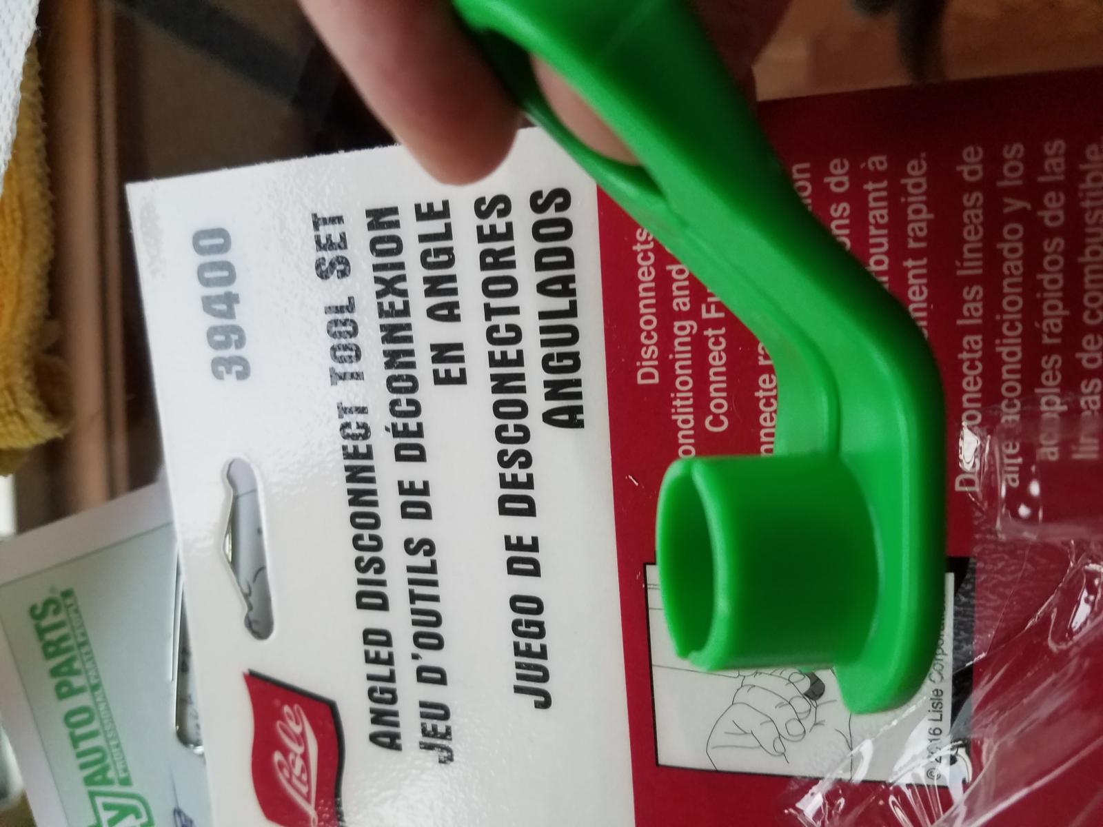

Ok, so I got this tool to remove the hose. Fits perfectly but it's not working. Is there a trick? I have other sizes as well, but this looks like the right one.

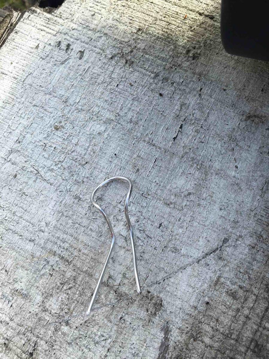

Most have had good luck using a fuel line disconnect tool of the right size. You can buy kits of the tools in different sizes at your local auto parts store
I've also been able to do it with just a bent up piece of welding Rod.
