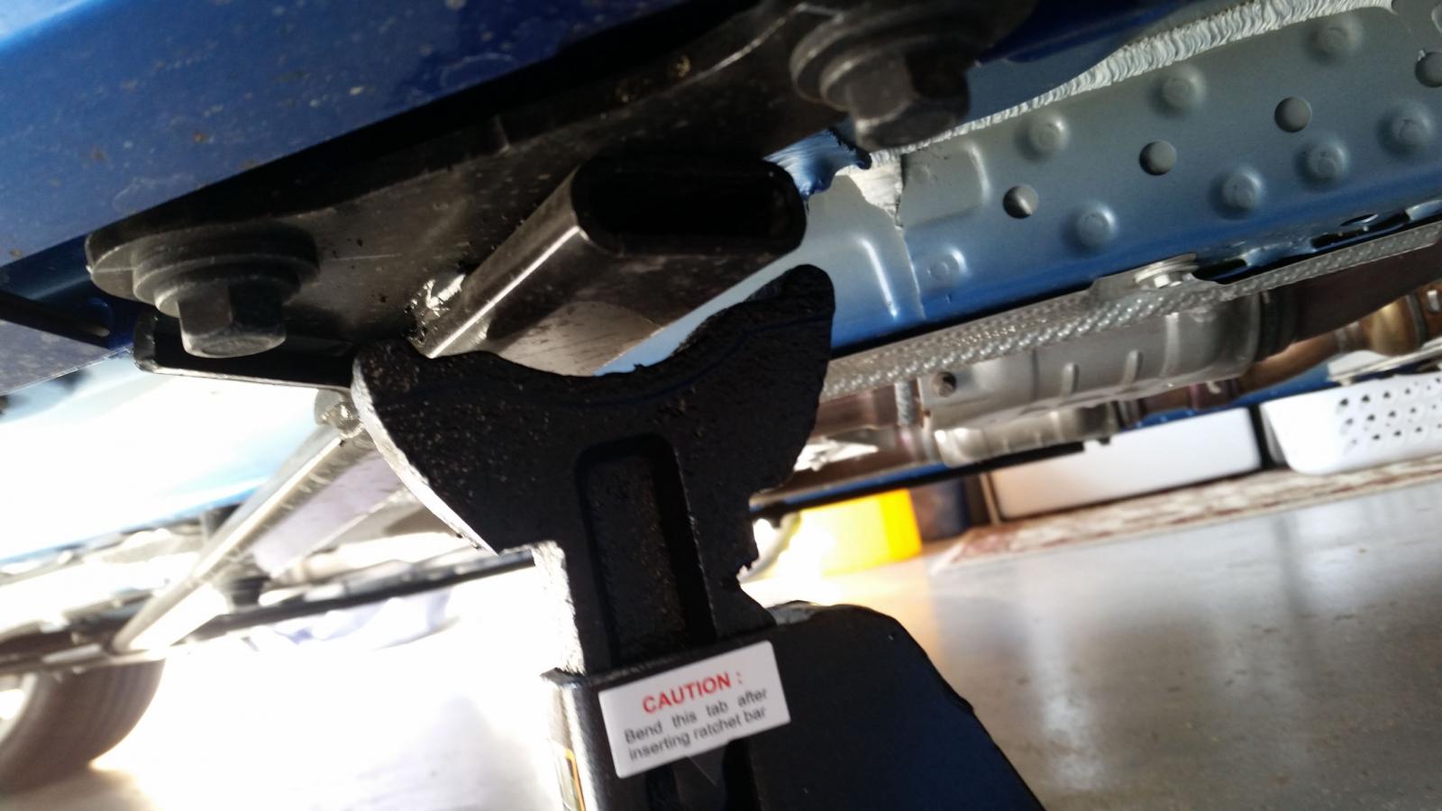

OPs profile says convertible. If so, the brace needs to be on the car for normal use.
There are two sets of pinch welds near the front wheels. The brace covers one. Use the other to jack the car. Then put your jack stand under the brace at the point where it bolts to the body.
