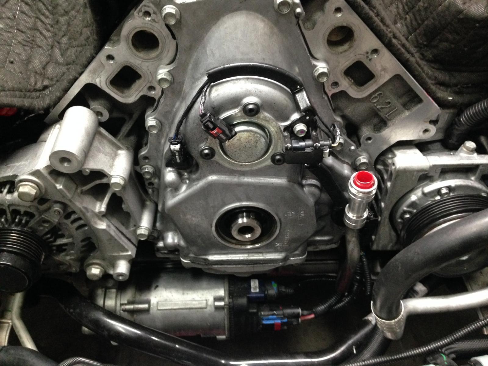

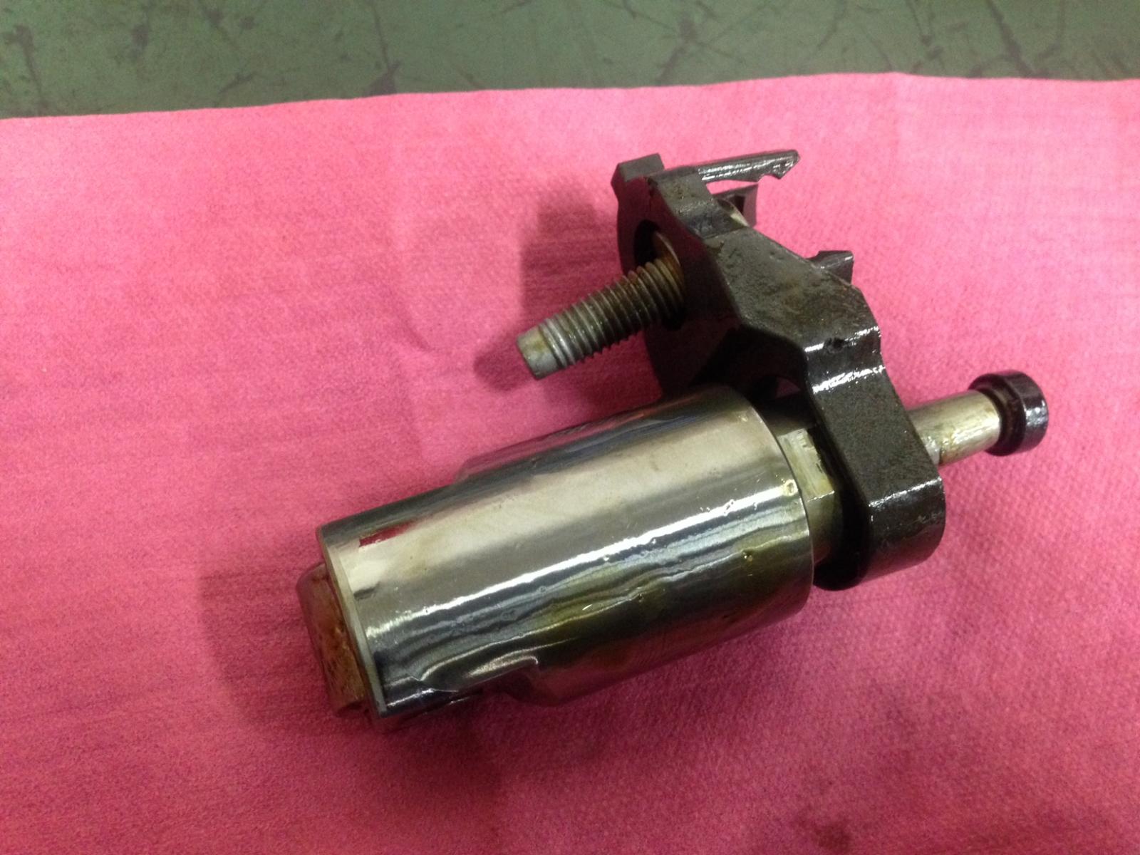

1, Cam coming out
2 New cam in
3 Phase limiter installed
4 shot of the parts shelf
This is a daunting task compared to the Gen 5 cars, Man we got spoiled LOL
I will keep you posted at the project progresses.

Looking at the picks why does the oil pan need to be dropped? Also if you did drop the pan, did you have to remove the K member? Thanks
Old 01-05-2017, 12:06 PM   #3
JANNETTYRACING
JANNETTYRACING's Avatar
Posts: 15,453
We did not drop the pan.

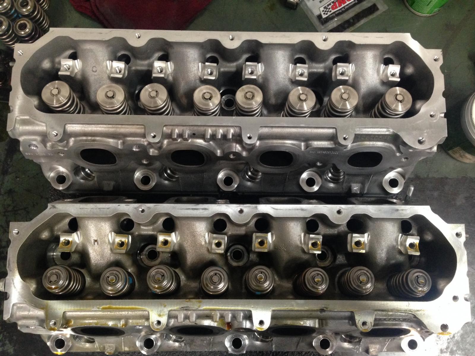

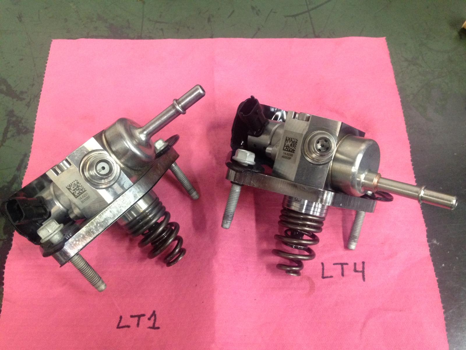

Going back together, setting spring heights, installing valve springs, AFM plugs new LT4 pump, lash cap installed, LT4 injectors installed , next the heads go back on.
Ted.

Hit a little bump in the road the head gasket are wrong new ones came in today or the heads would have been back on yesterday but still had plenty of other things to do to keep us busy on this project.
Ted.
