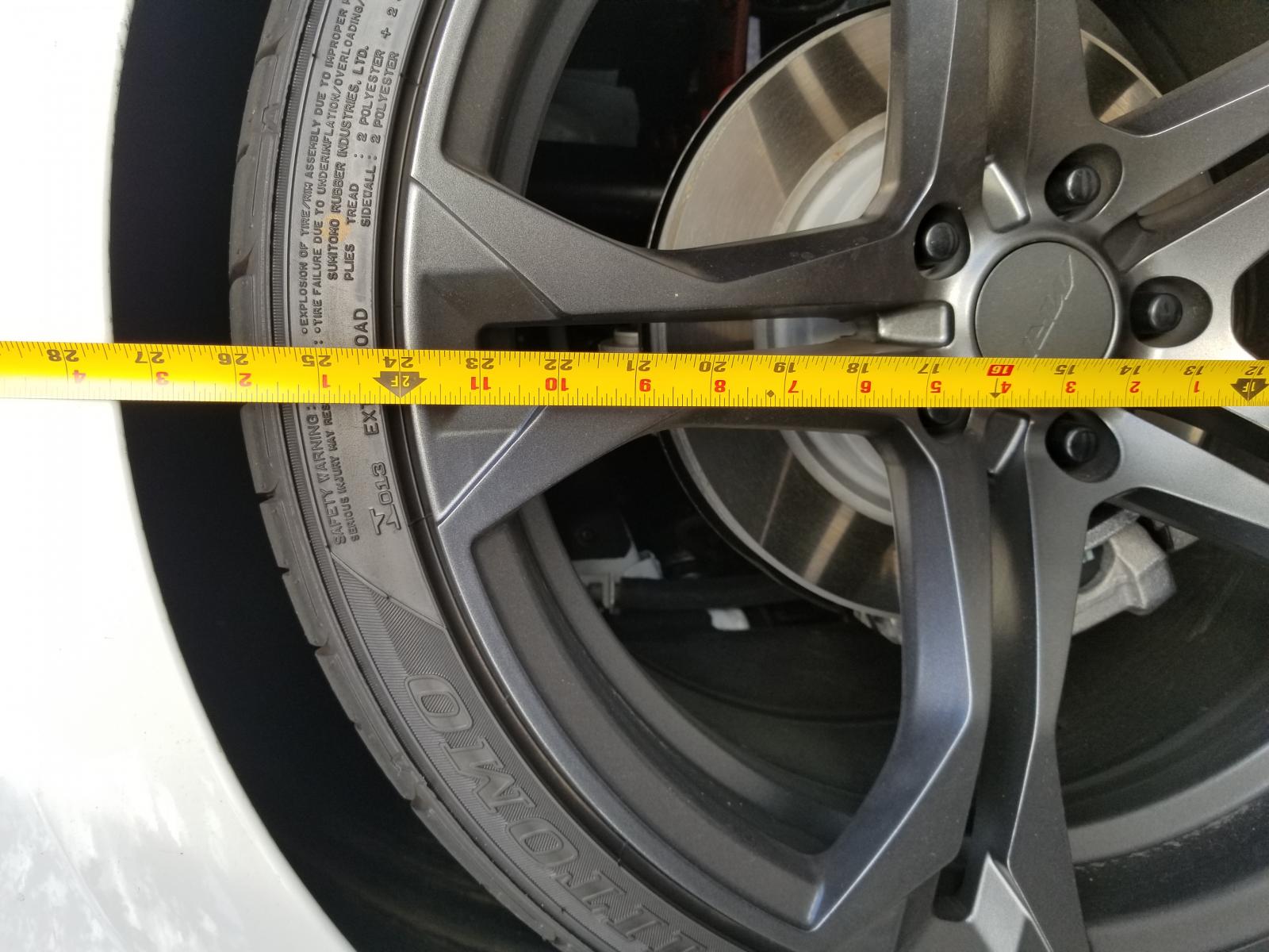

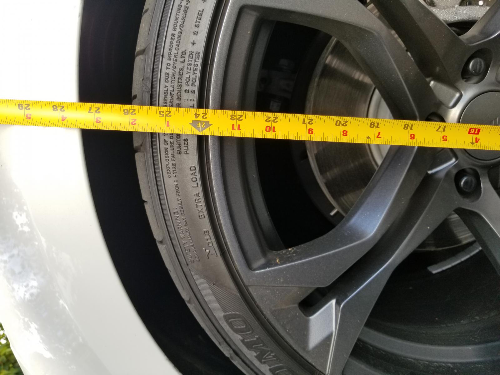

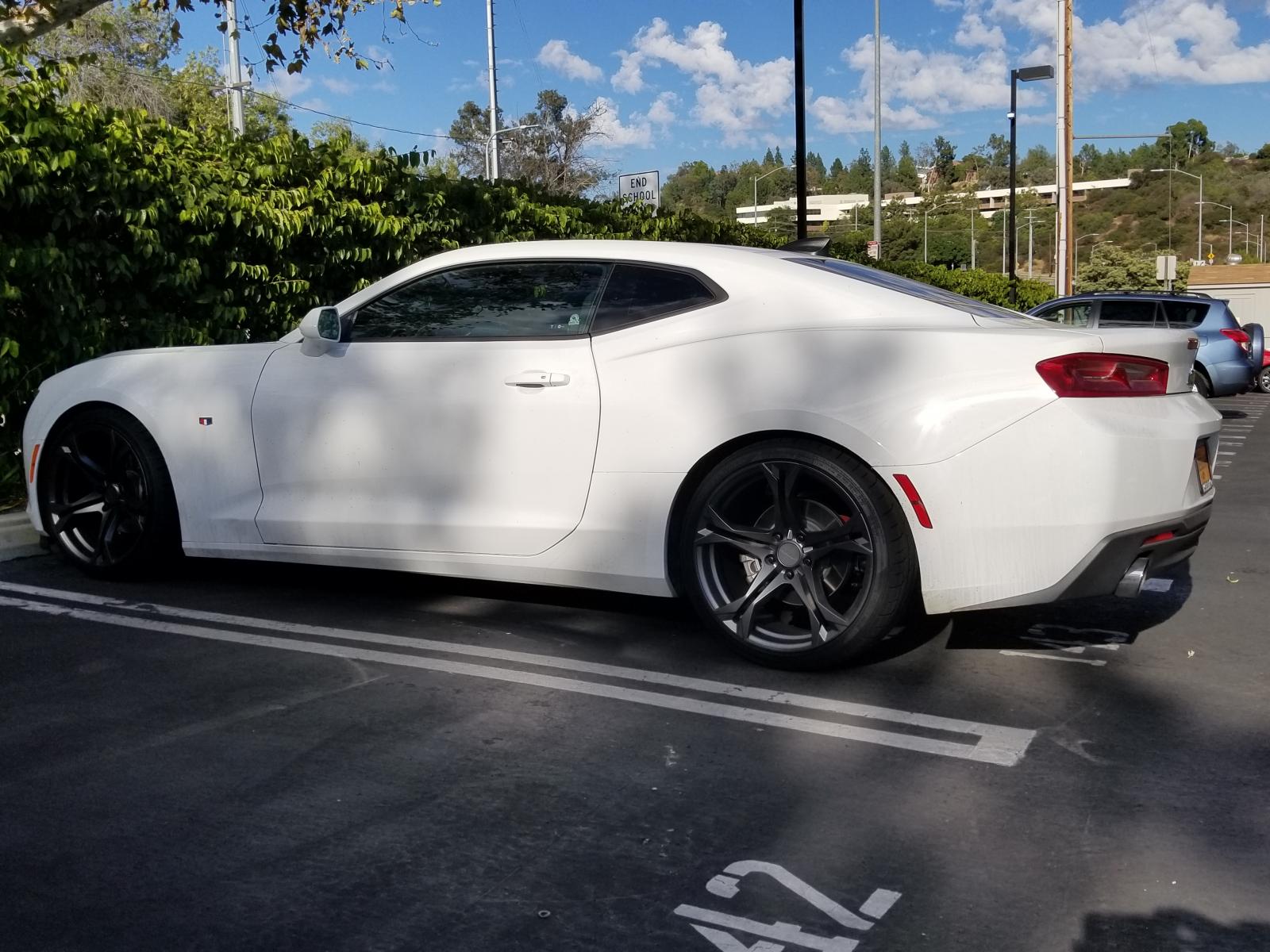

Update after install
Likes:
The drop, 1" in the front and 1-1/4" in the rear.
The ride is much stiffer and in my opinion AFE got it right for street use. In that as a daily driver on bad streets it's tolerable.
Where these springs come to life is in the corners in comparison to stock. I have AFE swaybars front and rear set in the middle hole riding on
HTR Z III - Size: 285/30ZR20 square setup. It corners hard now and predictable at the limits of adhesion, but it's a strain to stay seated.
New seats now have taken priority over other upgrades.
If anyone is considering these tires, as they are the best bang for the buck (IMO), just remember water is like kryptonite to these tires.
Dislikes:
Currently going over speed bumps I hear clunking in the front and will be
talking to the installer about this and a follow up call to AFE.
The tire pics didn't post in the correct orientation where the end of the tape
measure is touching the ground and drawn up centered on the wheels.
1 Front tire
2 Reat tire
3 Body

Originally Posted by cooper1965 View Post
Did you do a square wheel by any chance, or is that the standard offset with square tire size?
Looks great!
Square wheels for a 4 tire rotation. After seeing the full body pic again, the
tire offset is deceiving and appears to be tucked into the wheel well which it is
not.
