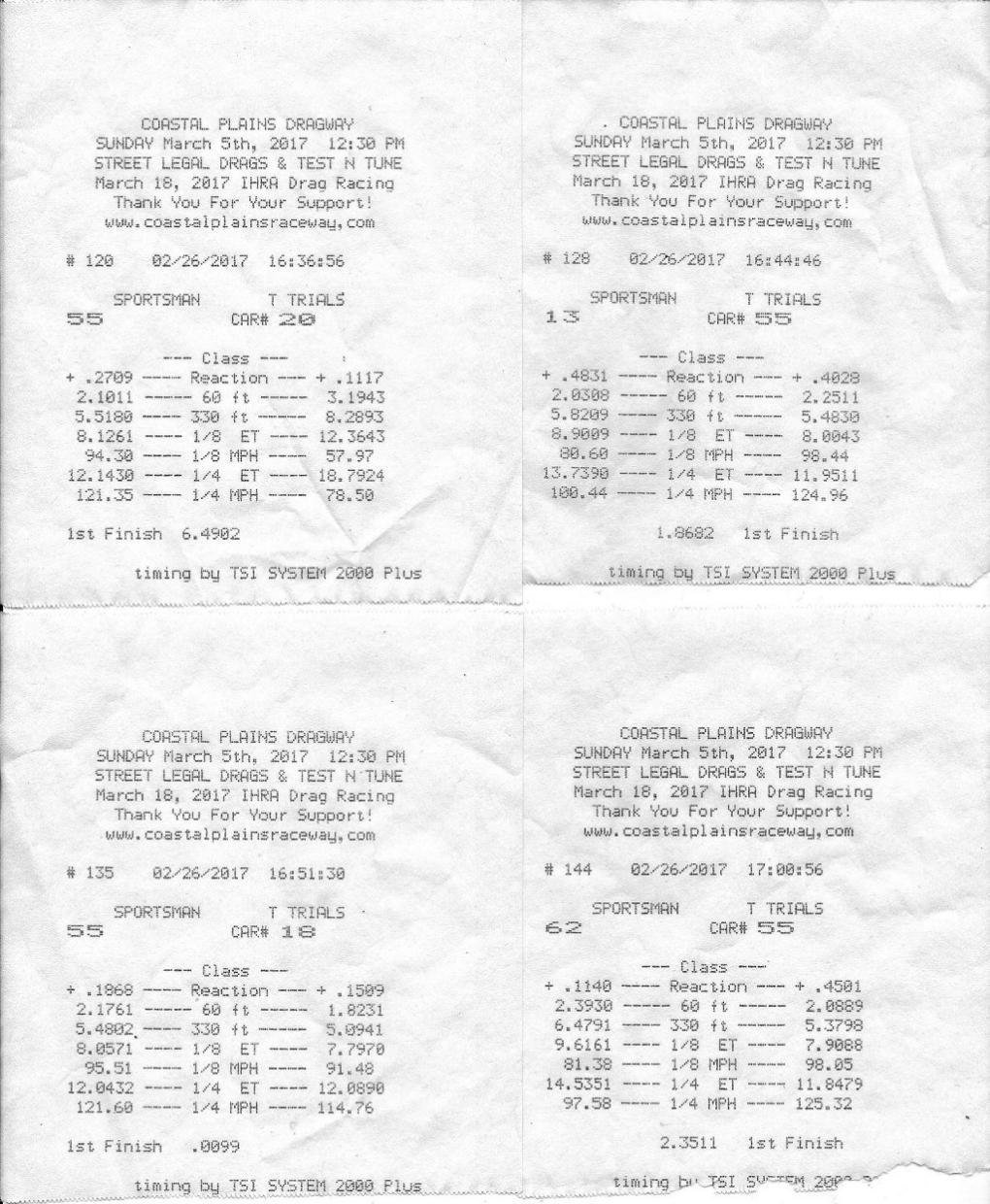

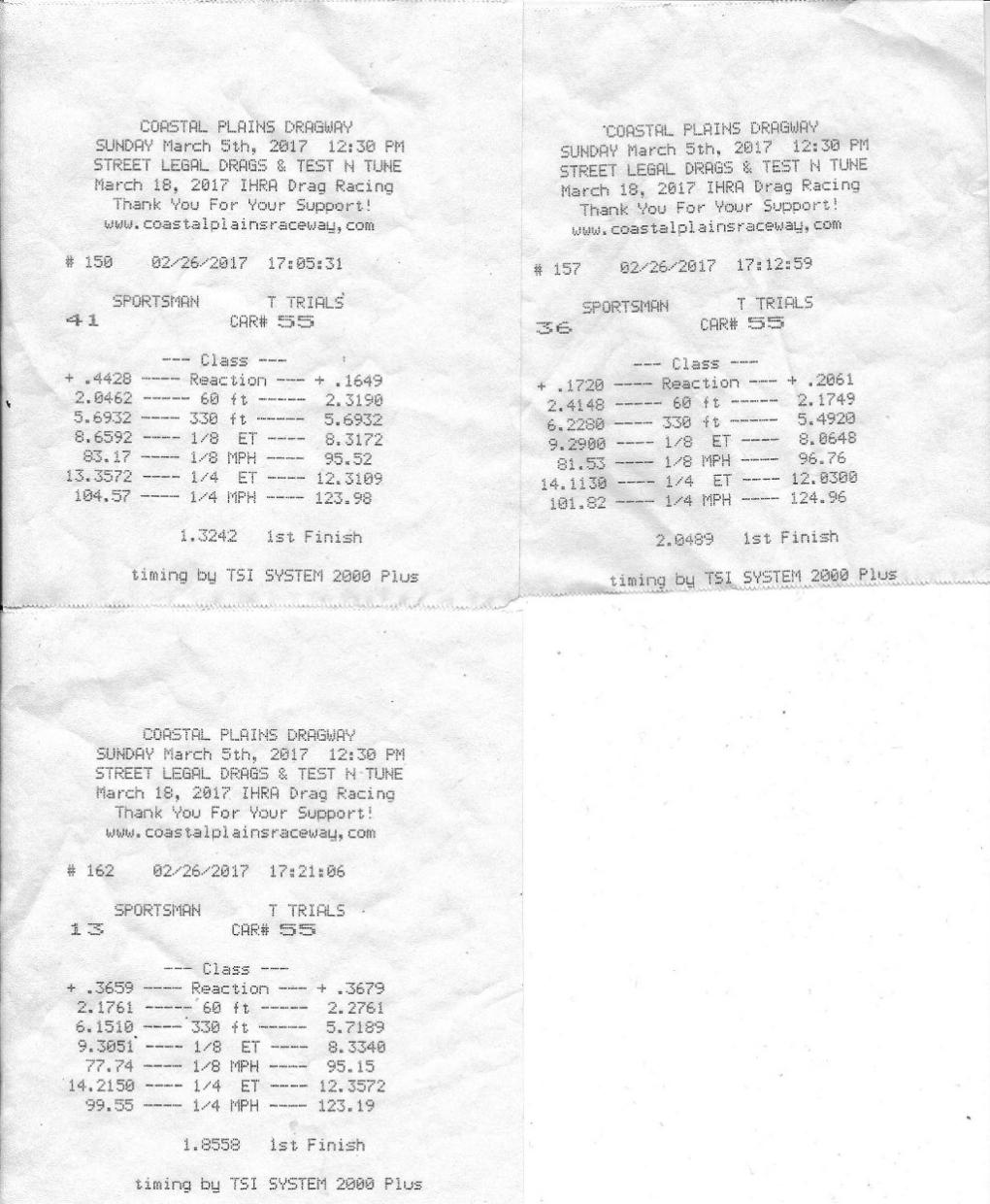

Time Slip Data:
(My 6th Gen ZL1 was #55)
Code:
2017 6th Gen Camaro ZL1                      Opposing Lane
Seq  Time      R/T    60 ft  ET      MPH     Opposing Car         R/T    60 ft  ET      MPH
#61  15:36:28  0.1002 2.1947 12.0897 123.98  Ford Fairlane? (yr?) 0.8478 2.0213 12.3262 114.54
#74  15:55:09 -0.1060 2.4240 12.2818 122.02  Unknown Car          0.0960 1.8078 12.0938 114.24
#84  16:02:16  0.2210 2.2169 11.9969 124.96  Nissan Z? (yr?)      0.3110 2.6410 15.7561  90.67
#91  16:06:31  0.2518 2.3240 12.1062 124.96  Unknown Car          0.6510 2.3339 14.3569 104.88
#120 16:36:56  0.2709 2.1011 12.1430 121.35  Ford F250            0.1117 3.1943 18.7924  78.50
#128 16:44:46  0.4028 2.2511 11.9511 124.96  Ford Focus (yr?)     0.4831 2.0308 13.7390 100.44
#135 16:51:30  0.1868 2.1761 12.0432 121.60  Nissan (model?)(yr?) 0.1509 1.8231 12.0890 114.76
#144 17:00:56  0.4501 2.0889 11.8479 125.32  Ford Mustang? (yr?)  0.1140 2.3930 14.5351  97.58
#150 17:05:31  0.1649 2.3190 12.3109 123.98  Unknown Car          0.4428 2.0462 13.3572 104.57
#157 17:12:59  0.2061 2.1749 12.0300 124.96  Dodge Neon (yr?)     0.1720 2.4148 14.1130 101.82
#162 17:21:06  0.3679 2.2761 12.3572 123.19  Ford Focus (yr?)     0.3659 2.1761 14.2150  99.55

Time Slips 5-8
Time Slips 9-11
