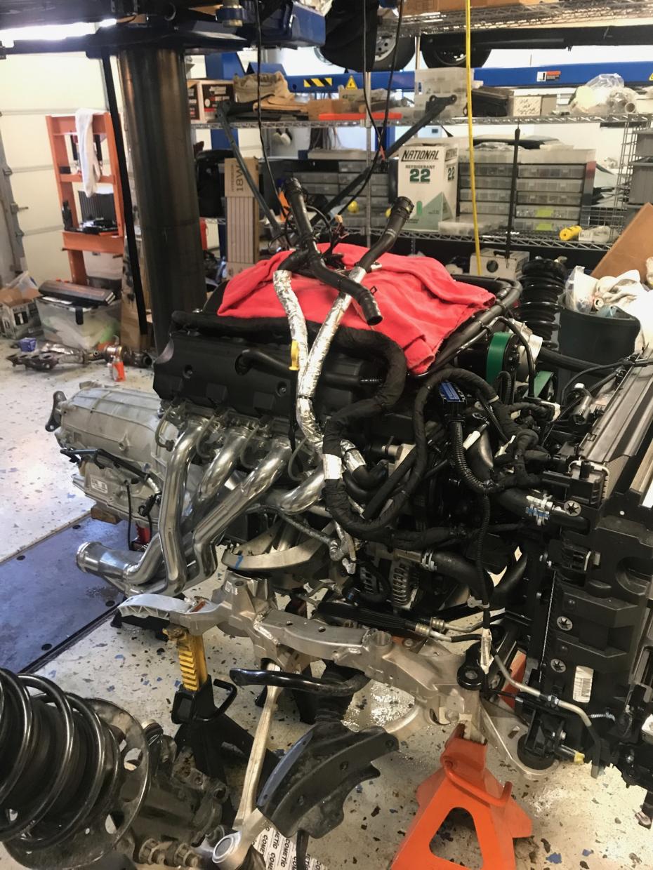

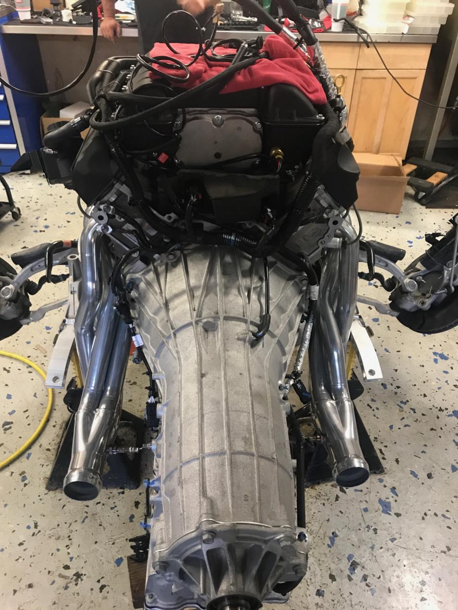

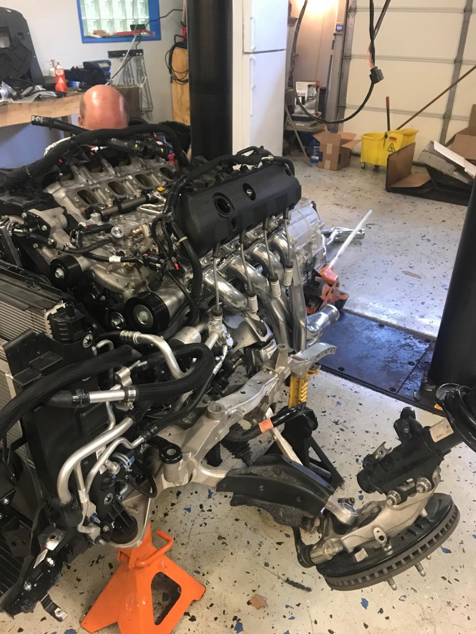

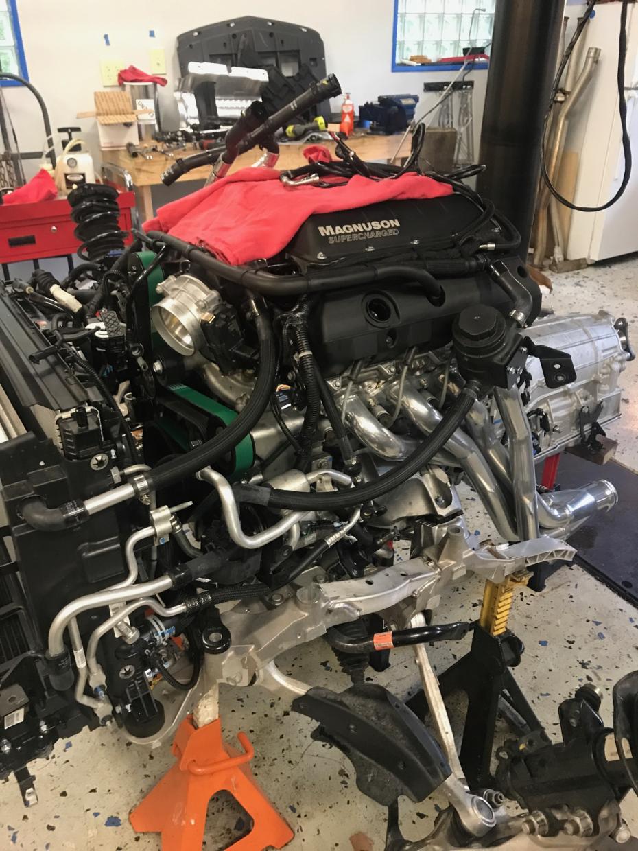

Everything is moving along pretty well. We dropped the motor, installed the cam, pistons, headers, front seal, e85 sensor, for the catch can we need a couple hoses...for the boost a pump, the directions weren't good, but working through it now. The gauges are being installed now also.
The motor is back in the car and we have one problem we couldn't work around. The in-tank zl1 fuel pump isn't a direct replacement so we need parts to be overnighted. If it wasn't for the missing fuel parts, the car would have had its first start tonight.
Hopefully I can get the parts overnighted tomorrow.
Getting close.
Will post some pictures when I get back tonight.

It was two days. Solid. But much of today was doing little things because of our problem with the in-tank pump.
We have one more lighter day to have everything done...but it all centers around getting the pump right.
