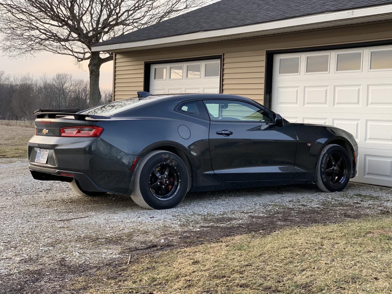

I’d personally do the 15’s. I was starting from scratch and ended up going that route. Glad I did. Install didn’t take long. But note that if you get the Carlyle kit with just the caliper and rotor and buy the BMR toe rods, you’ll need an M12x80 or M12x70 button head bolt. Either one will work. Here’s mine with a 26” tire.

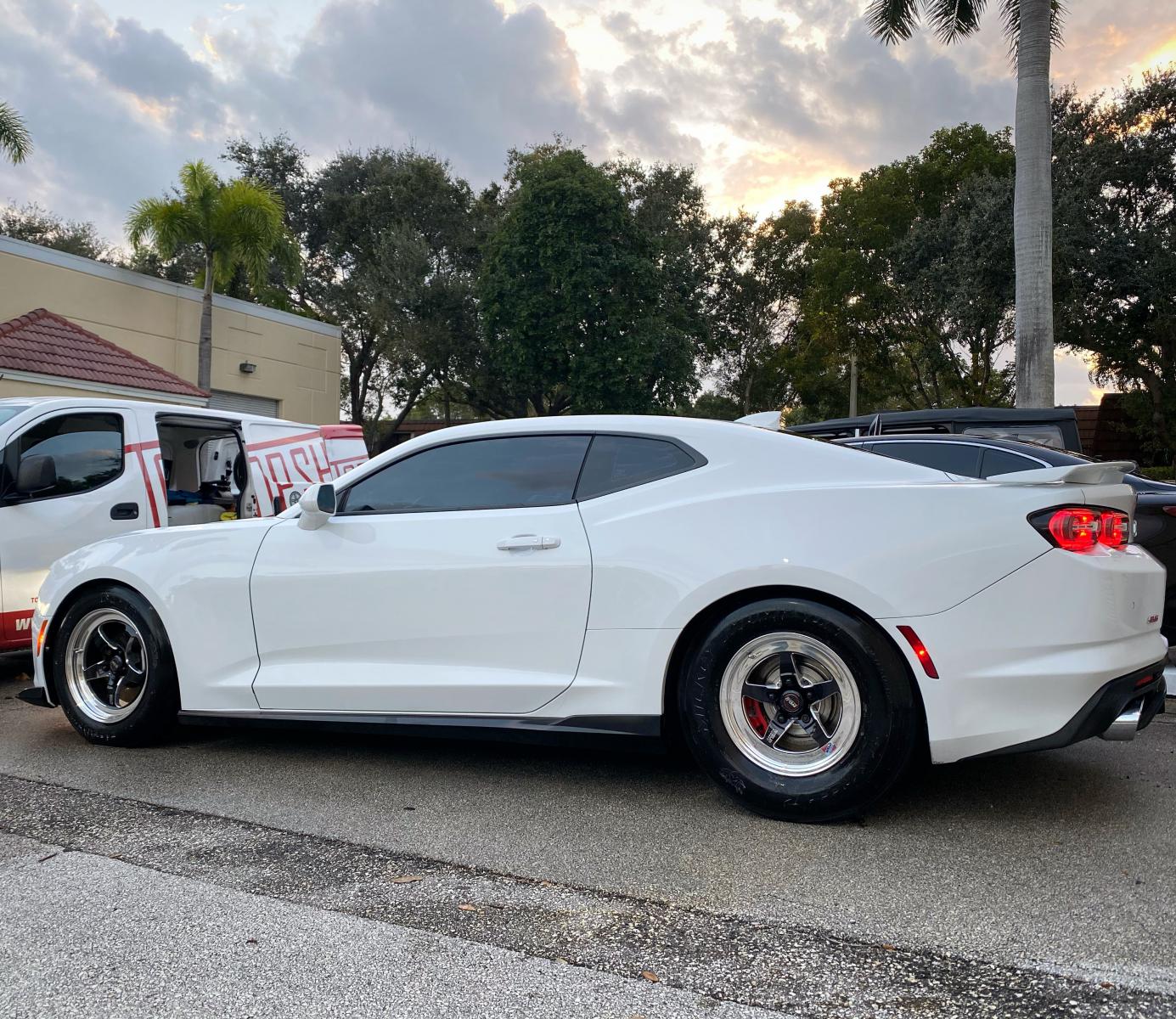

15” front and rear . N/A LT1 . Bias ply in the front for less weight .Name:  2DA78E12-4AD1-45EB-94B0-370EBFE4AA1B.jpeg

Originally Posted by Duramacr1 View Post
15” front and rear . N/A LT1 . Bias ply in the front for less weight .Attachment 1117498
Looking good, you need to get that thing lowered.
2022 Lt1 6.2 A10, Maggie 2300, THPSI Port Inj/10 rib, Rotofab, E, Nickey, SCOL, Griptech, RC Bandits, Hoosiers/MT 9.80@142.96 1.44 60ft, 6.34@112 707/669 RWHP/TRQ. 16SS Maggie 2650 9.41@147 1.35 60ft, 5.99@119. 16 C7 A8 10.90@128 Bolt on stuff
Agreed looks great. It’s a shame how heavy the radial sportsman’s ended up
White with black spear looks great
