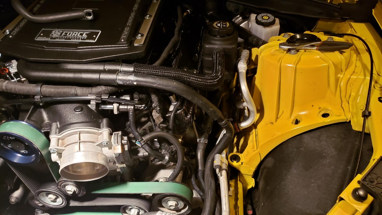

I ordered the adm last month and got it within a week. I emailed first to verify it was in stock. I spent the extra for the adm kit because of simplicity. I took my time time and it took about an hour. 200 miles so far and working well. Fwiw I have seen a 10* drop in iat2 on the street since adding the reservoir.

I had the cordes reservoir installed in April and really like that it’s easily accessible and sits out of the way in front of engine on the radiator support.

Another vote here for the ADM (Edelbrock) rez. I also have the Prospeed fender tank. Had air pocket issues and solved it by adding the little rez over the drivers side header. I’m running 2” LTH’s with no coating or extra heat shield and have had no heat problems with the ADM rez. Plenty of 100+ degree and crazy humid days here in Texas and I run it hard.
I was actually considering just adding the ADM and keeping my Prospeed tank as well. It has massive volume but it’s a real pain to get all the air out with how the barbs are placed. Glad to hear it’s working. I have been noticing this summer vs last summer that iat2 temps are coming up faster and coming down slower. This is leading me to believe that I have air in the system

I have the weapon x triple heat exchangers and the ADM and it solved all of my air in the system issues . Runs great on track with no noticeable loss in power as it nears the end of a 30 minute session

The ADM kit was in stock as of last week. I ordered one and had it in two days. Nice kit......super easy to install!!

51-7100 Edelbrock Tank
79-9177 for the bracket (may need to modify) Now that the 2650 Kit is out ask for braket for the SS make sure it include this reseervoir..
Gates 19839 premolded heater hose
Gates 28479 premolded heater hose
2 5/8 to 3/4 coupler heater hose
2 24mm constant tension spring hose clamps
6 26mm constant tension spring hose clamps
Coolant cap C6 vette
this is what i did because adm was out of stock.. He did lead me on correct path!
Talk to Celeste Speith at edelbrock to order
