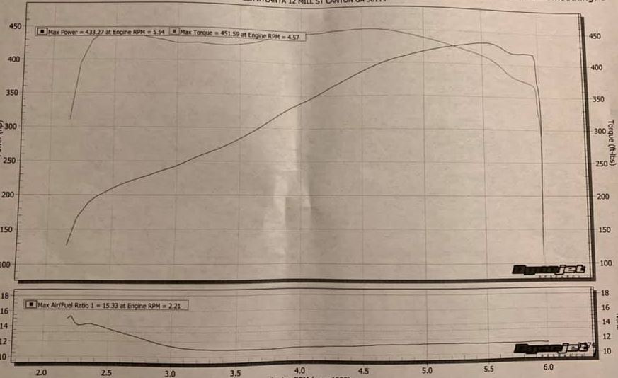

Hey everyone,
So I recently got my car dyno tuned and I was kind of disappointed. My car made 433 whp and 451 torque so I posted it on Facebook to get some opinions on why I ran such low numbers. I was repeatedly told my car was running too rich. I went back and talked to my tuner and he said he tried to go the lean route but my car would pull timing, as much as 6 degrees. I'm currently unsure of what to do and I was told running rich on these DI motors are not safe, it is safer to run lean. What are your opinions?
My mods are:
TSP headers 1-7/8 inch
Rotofab Intake (dry filter)
Mishimoto catch can
Flex Fuel Sensor (at the time of tune I had 58% ethanol)

That's a 12afr-11.8afr which is way rich for a stock LT1. I posted on your fb question and you need it tuned again at the correct afr. I'm 9psi at 12-12.2afr and zero knock retard.
If you're local to Chicago, I can get you dialed in no problem. I can also remote login if your tuner is having issues. Put the timing back in that they took out, lean it out, and watch the knock go away......

Sorry to say, but you need a new tuner if he just gave up on correcting fuel mixture...
Also you have a 1LE, people don't take into consideration that we have ZL1 in tank fuel pumps....
When I tuned... Pray also had the same issue, but he figured it out with my car on a dyno and remotely tuned. That was about 2 years ago which im probably sure i was 1 of the first 1LE's he had tuned but he never quit till the car was right.
Its that simple.
That being said, a baseline is very important... because gains will tell you better if you are on par with the avg hp gains... the peak HP is just a number based on dyno calibrations... but looking at your graph you are leaving at least 15hp on the table.

As previously mentioned, the numbers themselves mean nothing unless you have the baseline numbers from the same dyno.
That said, something looks wrong with your tune. The big drop off after 5600rpm is very strange, it should pull to a higher rpm than that, and then have a gentle fall off. The AFR shown on the sheet, if it's based on lambda like usual for an oxygen sensor, also looks rich for a normally-aspirated LT1. Looks around .78, and somwhere around .86 to .88 is probably better for this engine. The AFR is fairly steady so there are other problems besides this going on here (not a rich spot corresponding to the strange dip in power).

The AFR is 11.31 at 433 whp. I’m thinking of going to vengeance racing, Pray porting or lsxperts. Just don’t know who yet and waiting for their responses. Just sucks that I pretty much wasted a lot of money trusting the guy.

This is a sure sign it's false knock. If you have access to the tune, you can go back and do three things:
- Turn off COT Protection (if you don't have cats)
- Increase knock sensor sensitivity threshold (mine are at 5)
- Lean your PE AFR's (target 12.8-13 for gas, 8.5 for E85)
Otherwise, find a new tuner who can do this for you...

RPM just did a experiment with a NA Corvette. Fran did 3 pulls back to back. One @ 12.8 afr, 11.5 afr, and 13.5 afr. Guess what, they were all within 5whp of each other on a 400-430whp car. The AFR isn't costing you power but the timing is. The LT1 knock sensor sensitivity is way too sensitive because GM set the engines up with the ability to run on 87. So that combined with high compression is why they pull timing very easy. You need to find a competent tuner that knows how to tune these DI engines correctly.

It is definitely rich but not going to hurt your numbers much we set them to .86 lambda so you can do 2 mile runs without issue.
Should be around 460 RWHP on E58 but dynos vary so you must first find out what stock camaros show on this dyno so you know the real gains.
