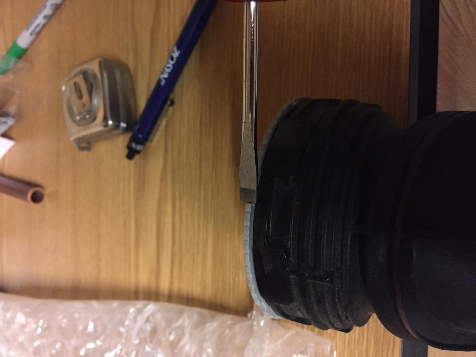

I'm trying to install the charge pipe and throttle body... but I can't not remove the dawn pipe... question when turning it counter click wise, how far do I turn the pipe... do I need to remove any radiator hose. Does the pipe turn loosely but didn't come off. Am I not turning it enough? This is fustrating... any help appreciated

DO NOT turn the pipe!!! turn the grey lock ring! I will post a pic when I get home in 1 hr. I just answered your PM also

this was the simplest install that turned into a nightmare. i kept turning the pipe to the left. it just wasn't working .... i even removed the engine cover, the sensor while charge pipe was still mounted, one small radiator hose coming from the small reservoir and the fuse box cause i thought may be i need to turn the pipe more... nothing worked and it was just a waist of time. finally i tried a flat screw driver and turn the white ring sligthly to the left.... and there it is , it came off. i feel stupid now looking back that i didnt think about that sooner... funny thing is as soon as i was done i received quite a few PM in my inbox with the instructions on how to remove that dawn thing. now im too tired to even go out and properly test my car. lmao

Thank you beast! Okay, I was thinking that all you do is turn the ring. I'm very glad you got it. Glad to hear all those guys helped you out. They are a wealth of knowledge and appreciate their help.
