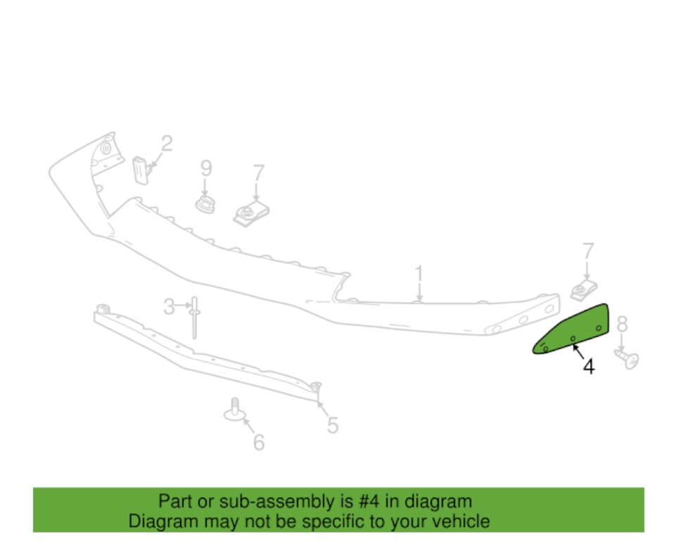

It appears the front facia did not change in order to add the 1LE parts correct? I'm considering just doing the 1LE lower grill and splitter.

You shouldn’t have to change anything to add the 1LE grille and splitter unless you decide to add the pieces on the edge of the splitter. The edge pieces (highlighted in green) have tabs that fit into the bumper so you would need to cut a slot on each side. Also, you would have cover up the pre-drilled holes on the splitter for the edge piece if you decide not to install them. You don’t need those pieces, however, it might look incomplete IMO. I linked a couple of threads that will help you with the install. Unfortunately, I don't think there are any videos out there on that cover this topic.
https://www.camaro6.com/forums/showthread.php?t=508925
https://www.camaro6.com/forums/showthread.php?t=512449
