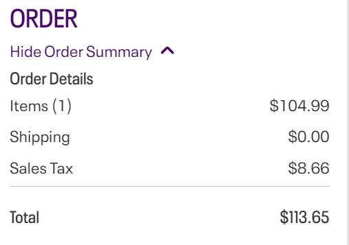

I normally don't buy oil online either except this is so hard to get in the store and the dealers charge an arm and a leg. We've had a couple of threads on this and Speedway came out tops shipped to your door. I've ordered at least 4 times from them and had $20 off coupons a couple times. I've also never paid shipping.

Yes, it's definitely okay but not mandatory like it is for the ZLE. (just listed as an alternative if others are not available) I think most would not want to do an additional change just for a track day if not required. 15W-50 is not recommended for street use in any of our cars so you would have to change back to 0W40.
Attachment 1051585
Oh yeah, if you plan to do street driving then 0W-40 DEXOS 2 is what's recommended. 15W-50 is listed as a dedicated track oil, it seems like.
I saw that the shipping is free... for the continental US. I live in Canada, so I can't take advantage of this. Looks like a great deal for anyone living in the US for sure.

Yes, the supplement you posted is track only and does not cover street use.
No idea what shipping is for Canada but you may have better luck finding it than we do. I get two extra quarts with that Speedway deal so every 4th order I get a half price oil change.
