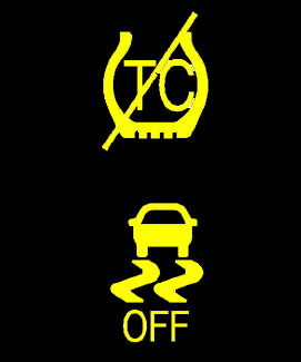

Right. And just to be very clear, keep holding it until the yellow indicator lights for both the ABS Off and Stabilitrak Off come on (see pic below). If you don't wait that long, your nannies will still be active.
Attachment 1074804
Exactly! And picture is worth a thousand words

Just to add one more clarifier here, both lights don't come on at the same time. First the TC Off light comes on, and then the Stabilitrak Off light comes on a second or so later. It is 100% possible to disable the ABS without disabling Stabilitrak, and I have the autocross loss to prove it. Go to 3:15 of this video to see "all nannies off" engaged while showing the indicator lights coming on.

ABS?! As far as i know it is Stabilitrack and TC...

D'oh! Not sure how I went from "TC" to "ABS" in my head. Edits made to previous posts, and thanks for catching that.
