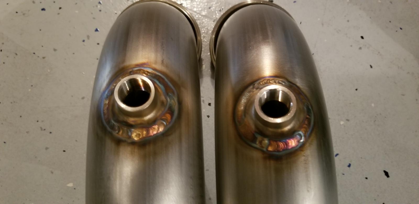

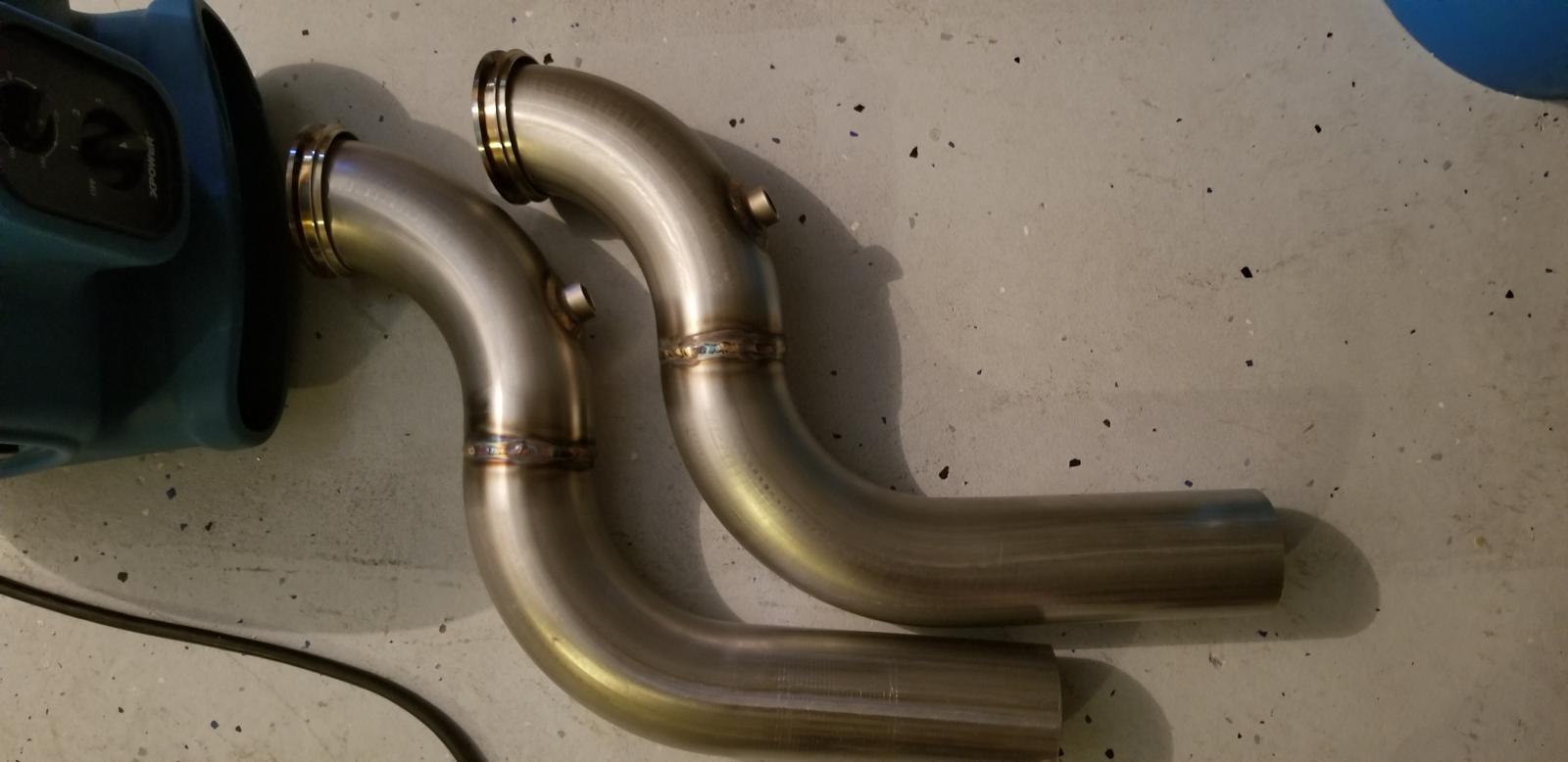

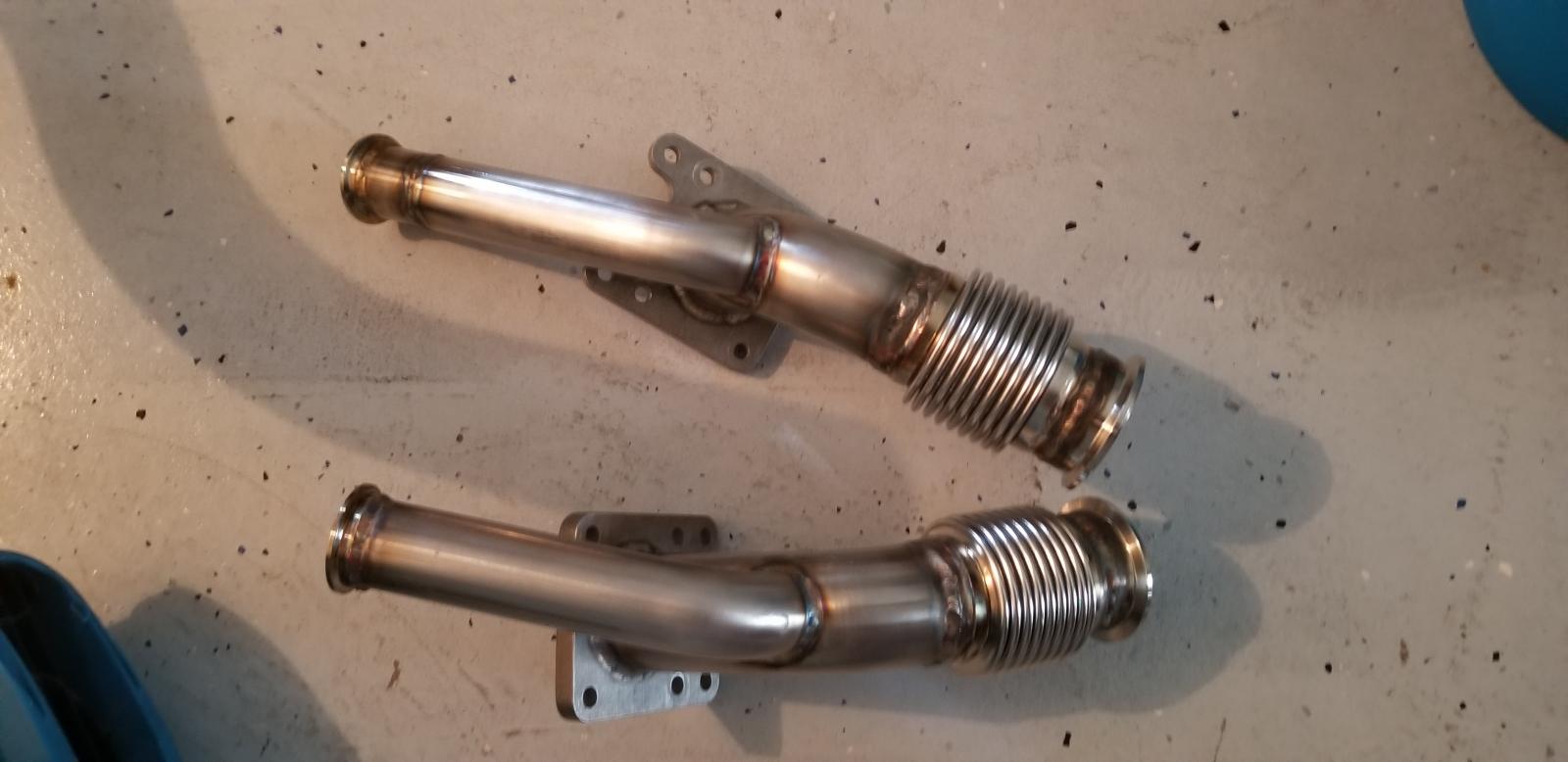

Well, it has been a while since I have updated the thread. A few things have changed on the build. I am no longer going air to air intercooler. I have to build a water to air because space is at a premium and I want the most efficient system as possible. I ordered a new core from Bell 13.4x6x6.1 inches. Should be good for 1300ish. I also could have moved the turbos closer together and run the exhaust but...(you'll see!). Should sound pretty bad ass. I also have a Holley dominator to run my boost, nitrous, methanol, aux fuel, etc. Have been working a lot on the car lately. Here are my current pics.

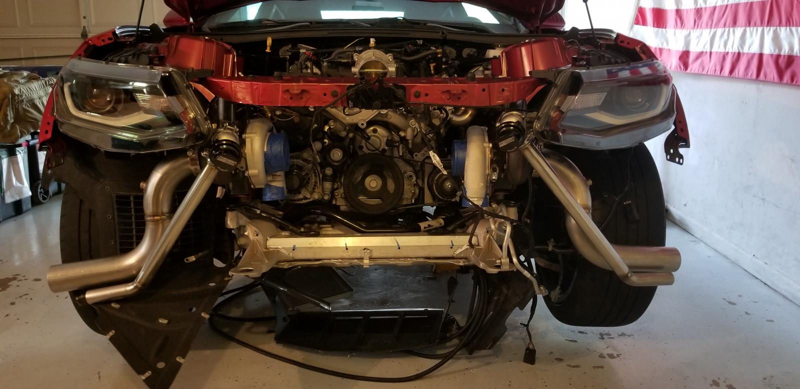

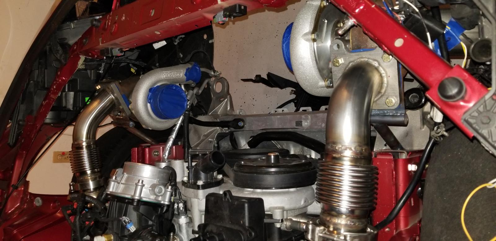

Got everything else finished up and put on the car on the hot side. Just waiting on the intercooler core in order to finish the cold side. Mock up is going well just gotta cut the bumper! (everything is loose in the pics but when tightened down everything looks great)
