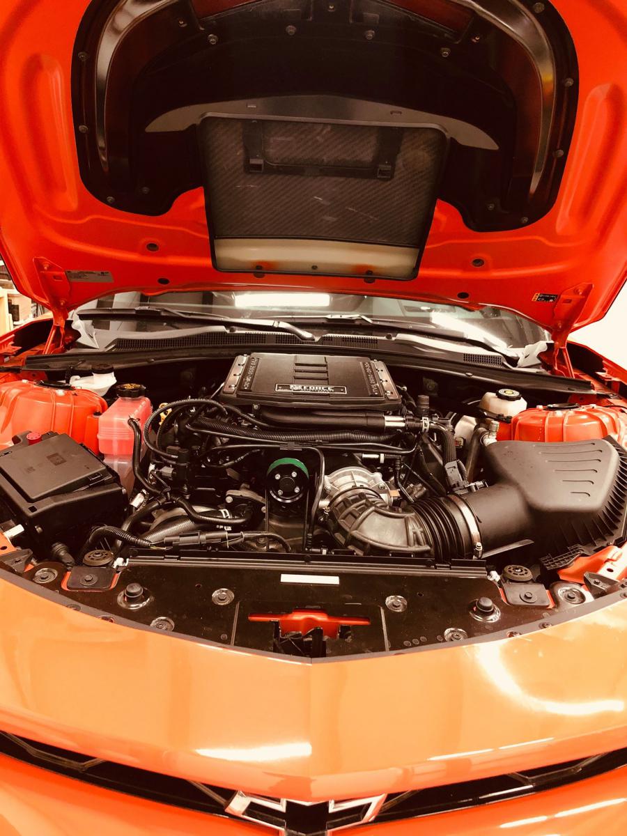

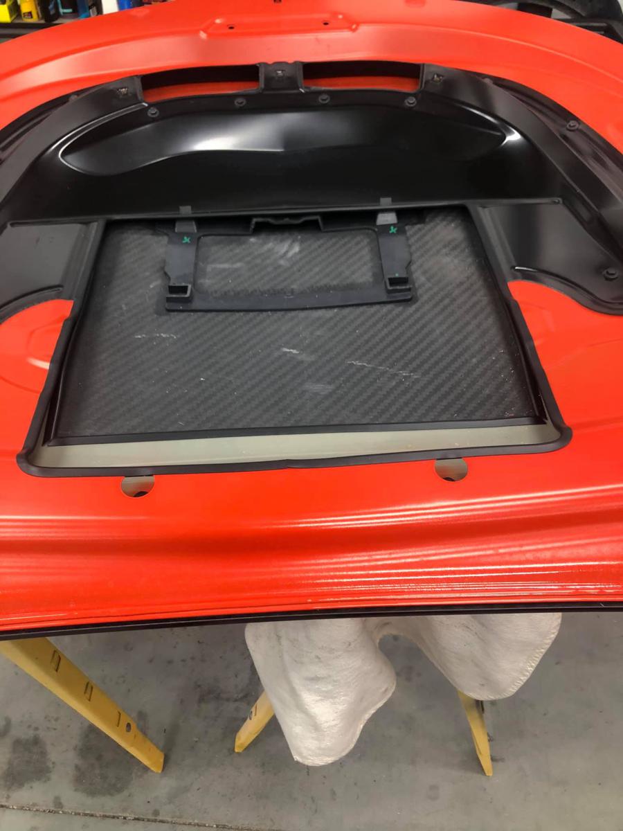

Overall, super happy with the install. Took a touch over 3 hours to get everything bolted in and running. Cutting the hood sucked but I guess it gives me an excuse to get a CF hood. After spending some time with the hood, not so bad after all.

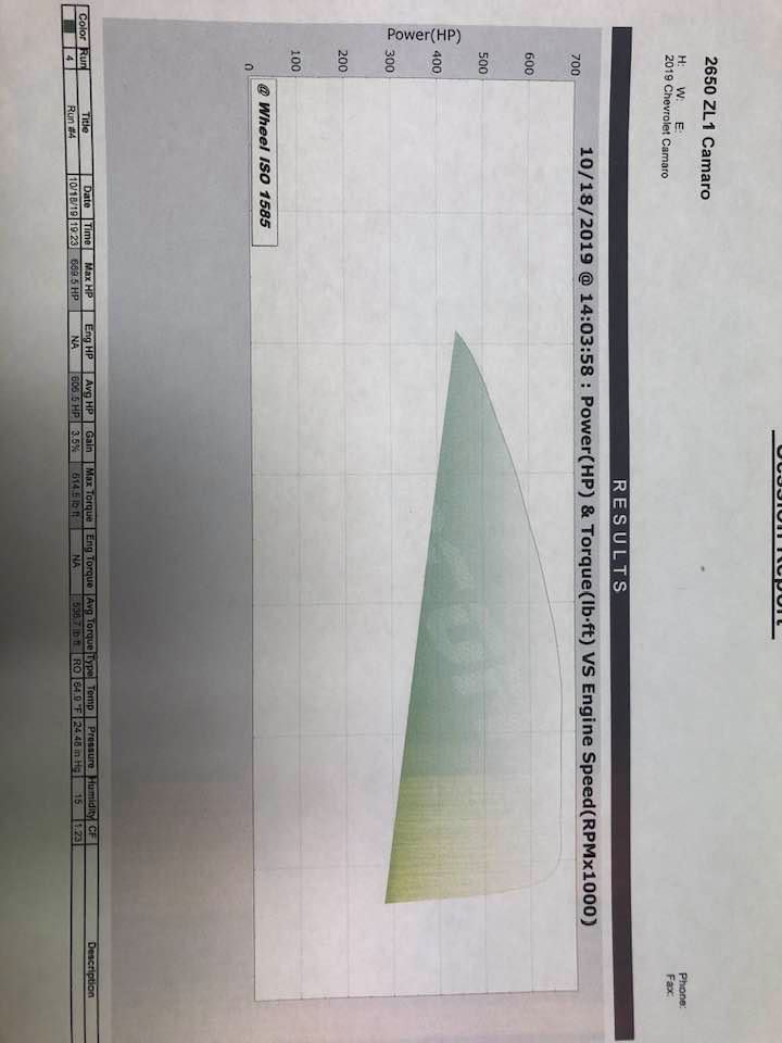

I am 100% stock down to the air filter and our lovely 91oct gas in Colorado
670WHP/615WTQ, tuned by Chapman in Denver. No trans tune, have not sent off the TCM to get unlocked yet. Injector cycle was below 5ms and 0 knock. Landed on the 3" pulley which was ~12.5 psi. IaT's never got above 117 degrees

updated pictures to reflect hood cut

OUCH!!! That hole though! But hey - as long as you're happy, that's what matters. Those are great numbers, too. I like that molding-touch at the cuts. That cleans it up really nice. Was the printout in SAE? I can't see anything but the air temperature.

it is ISO 1585
The hole is actually growing on me, you can see the exposed carbon fiber. Still need to touch up the gray portion with color match paint and it should be set.
