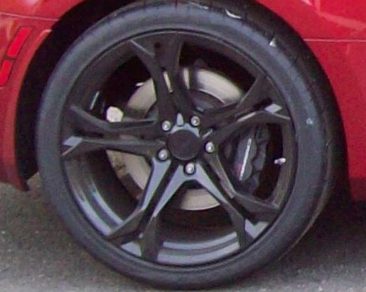

That 12.49 each price is for the black ones, but in a grey/silver color they are priced at 8.99 each. They are indeed pretty light in weight, example, 5 of the Katechs in the pic weighed 4 oz, while 5 of the stock Chevy lug nuts were 12.6 oz on the same scale. Yes that comes out to 2 lbs less than stock for the complete set. Note that a 12-point 19mm socket is needed to install them. Pic of the grey/silver ones in a black MRR wheel below:
