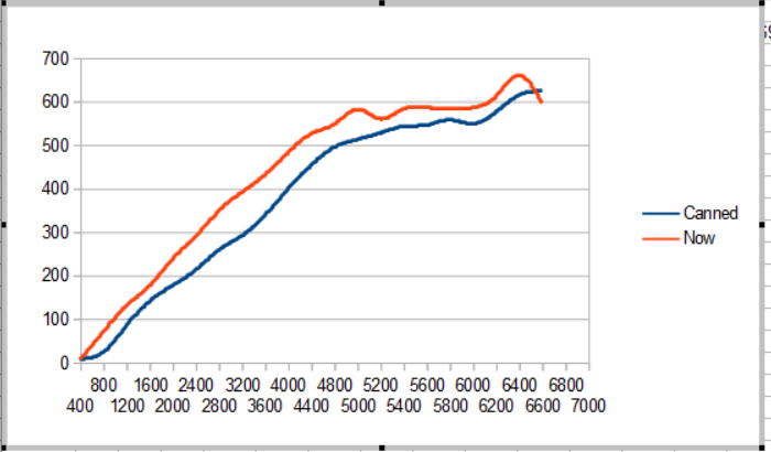

Even used excel to generate a graph of canned vs now.
I'm having too much fun with this. lol...
It official if it looks like dyno sheet right?

That flat spot between around 4800 RPM and 6200 RPM is bugging me in the "now" graph. I feel like that should be more of an arc. Maybe I'll play around some more with timing in that area. It's in the region where I start backing off the timing due to boost. I bet it'll take a bit more timing there.... maybe a different timing falloff curve?

While it may resemble a dyno sheet to some extent, it isn't really one. I enabled this horsepower function and checked 3 configurations in VCM, and all 3 of them exhibited this bump in the upper end just like yours is showing.
Obviously the basic formula for hp is correct, and the reason that this is happening is because the Engine Torque and Delivered Engine Torque channels are reporting higher values at higher rpm than reality IMO.

Its heavily based on the maf curve. That will change the hp reading dramatically

Latest update. I squeezed a bit more timing into that flat spot. Feels stronger, no knock in that area. HPTuners is showing slightly over 600 hp from 5400 RPM and up.
I'm feeling really good about the tune now. Cant wait to get it to the track.
An interesting note... I was having the A8 shudder with the canned tune... once I bumped up the VTT values... I no longer have torque shudder. There's still a constant 200-300 rpm up-down every few seconds, which I think is the lockup clutch slipping? But the rumble-strip vibration is gone. I think what's happened is that now it unlocks the converter at lower pedal input before the shudder happens. Going to look at doing fueling and torque conv over the winter when I wont be driving it much anyway.
