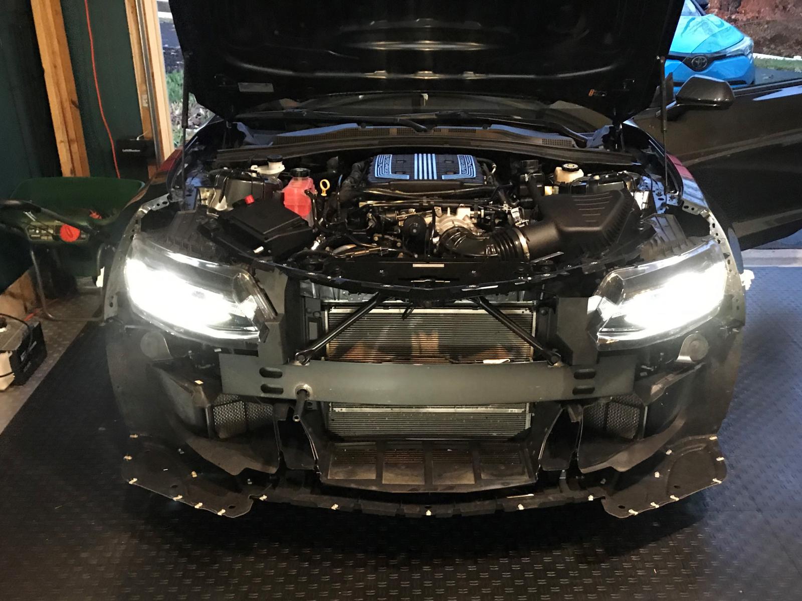

Well took off my bumper this afternoon. It was a lot easier than that C7 Corvette. No clips, all bolts. That dam electrical connection on the driver's side, which marries the bumper to the car was a complete bitxx! I had to get my daughter and her small hands to disconnect it. Of course, that was after 30 mins of trying myself. You all know it is a man thing.
I labeled all the deflector/air dam pieces, along with placing the bolts/screws to a particular part in separate plastic bags and marking them. Will never be able to remember what goes to where in a month or so! All in all, if it wasn't for the aforementioned connector the job went smoothly.
Tomorrow onto taking the grills out, removing the LEDs and splitter.

Removed the lower grill and LEDs, which were fairly easy. However, I need some advise on getting those clips to disengage from the ducts. I tried from about an hour and only got two, top left on the driver side and the top right on the passenger side. The rest.....shall we say are stubborn. I am afraid to keep trying to muscle them, for fear of braking one.
Has anyone had any tricks of success for them?
Those are the first 1LE parts I will be receiving sometime next week, if I cant get them off, maybe a trip to the dealer to have them switch them out might be a better alternative.
Any suggestions or ideas from "those in the know" are greatly appreciated.

If you are referring to those "bear trap" / alligator teeth metal clips, they are a BITCH! I have just said screw it and sprung them open with 2 needle nosed pliers and replaced them with new.....(that's one reason I bought that bag of 20 off of ebay for really cheap) Dodge uses that style too, that's where I got my first taste of those suckers!
Looks like you are the guinea pig.....my tear down is probably not going to be til after Thanksgiving, so THANKS for your marching on and keeping us posted!

No, I am referring to the plastic ones that go around the bezels of the day time running lights. The ones everyone seems to have difficulty removing. The angle of them just seems to be impossible to get them release by hand! And every hand tool I use on them seems to make them more stubborn.
