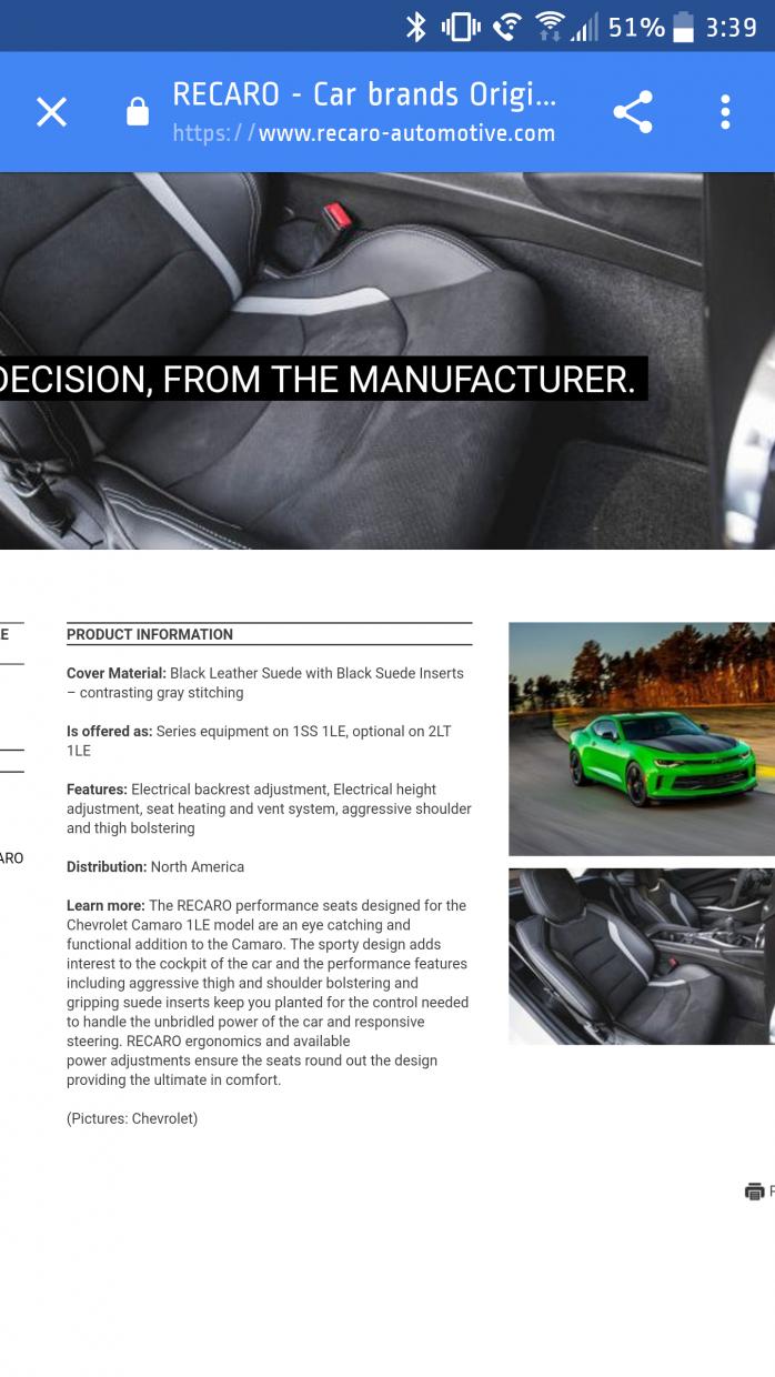

Check it out.
http://www.recaro-automotive.com/us/...-1le-2017.html
Makes me wonder. I contacted both Recaro and GM about our situation.
