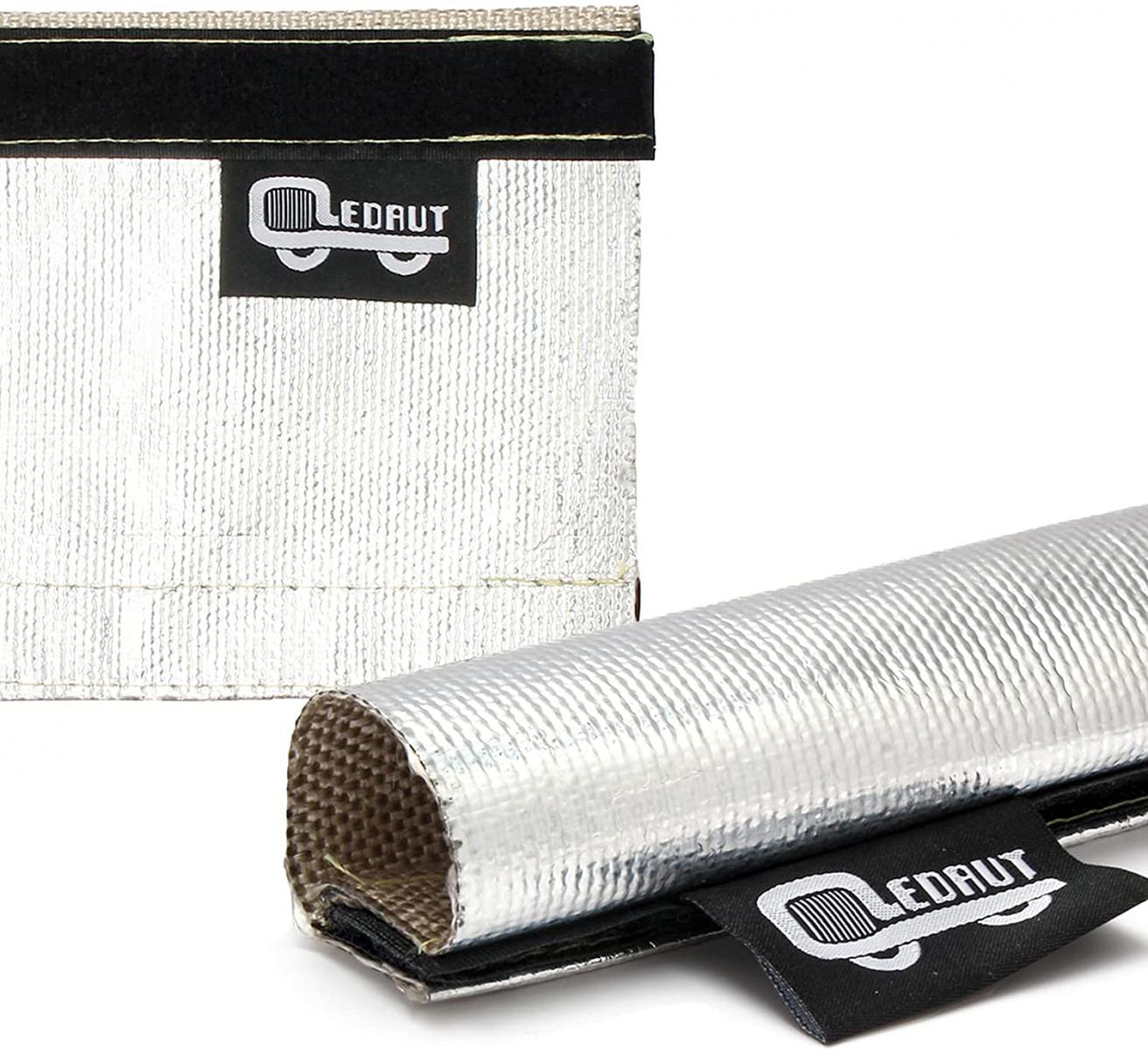

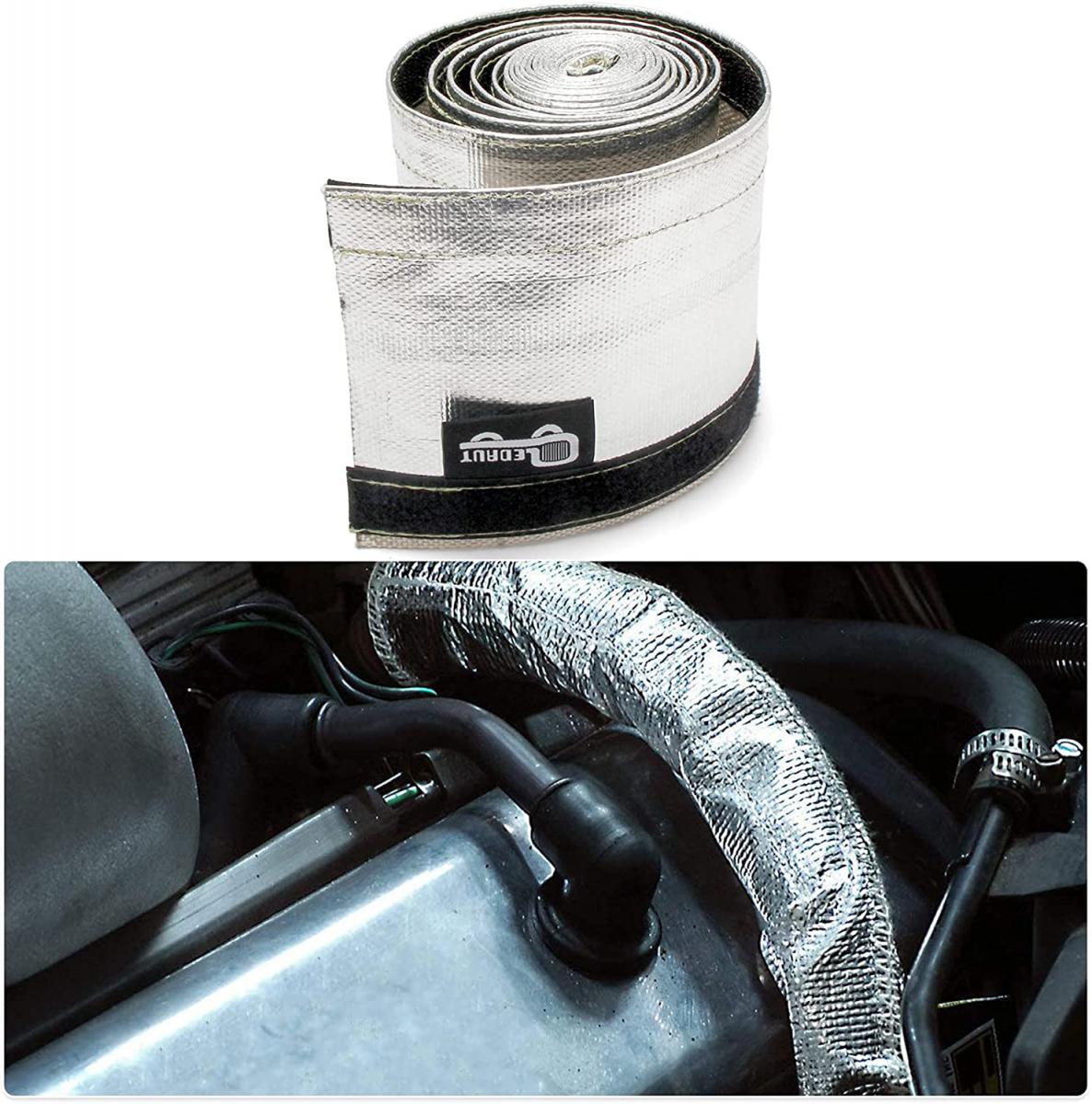

I'm doing some more testing, I am fully insulating all of the lines with this wrap i found on amazon. I wrapped about half of the lines today in the engine bay and I brought down the water temps 10F more then they ever were. It was 85F today, and i was pretty much averaging 85-88F MAT temps cruising with some throttle.
I am going to wrap the rest of the lines take some pics and show some results. I think the chiller is fighting the hot temps of the engine especially the lines around the headers/reservoir and this stuff is definatel'y working.
Here is what I used.
Thank you.
