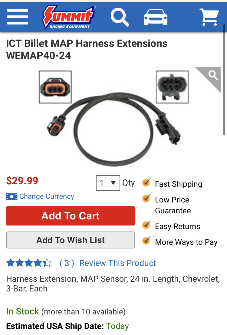

Originally Posted by lt4camaro View Post
That link says no page found?
Read the one below that one. Go back to previous page.
Here’s the right one.
https://gwatneyperformance.com/produ...old-126977114/
Actually Summit Racing has it to at a better price.
https://www.summitracing.com/parts/i...0-24?rrec=true
And if u check the bolt lengths it will be greatly appreciated.

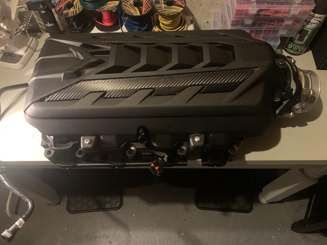

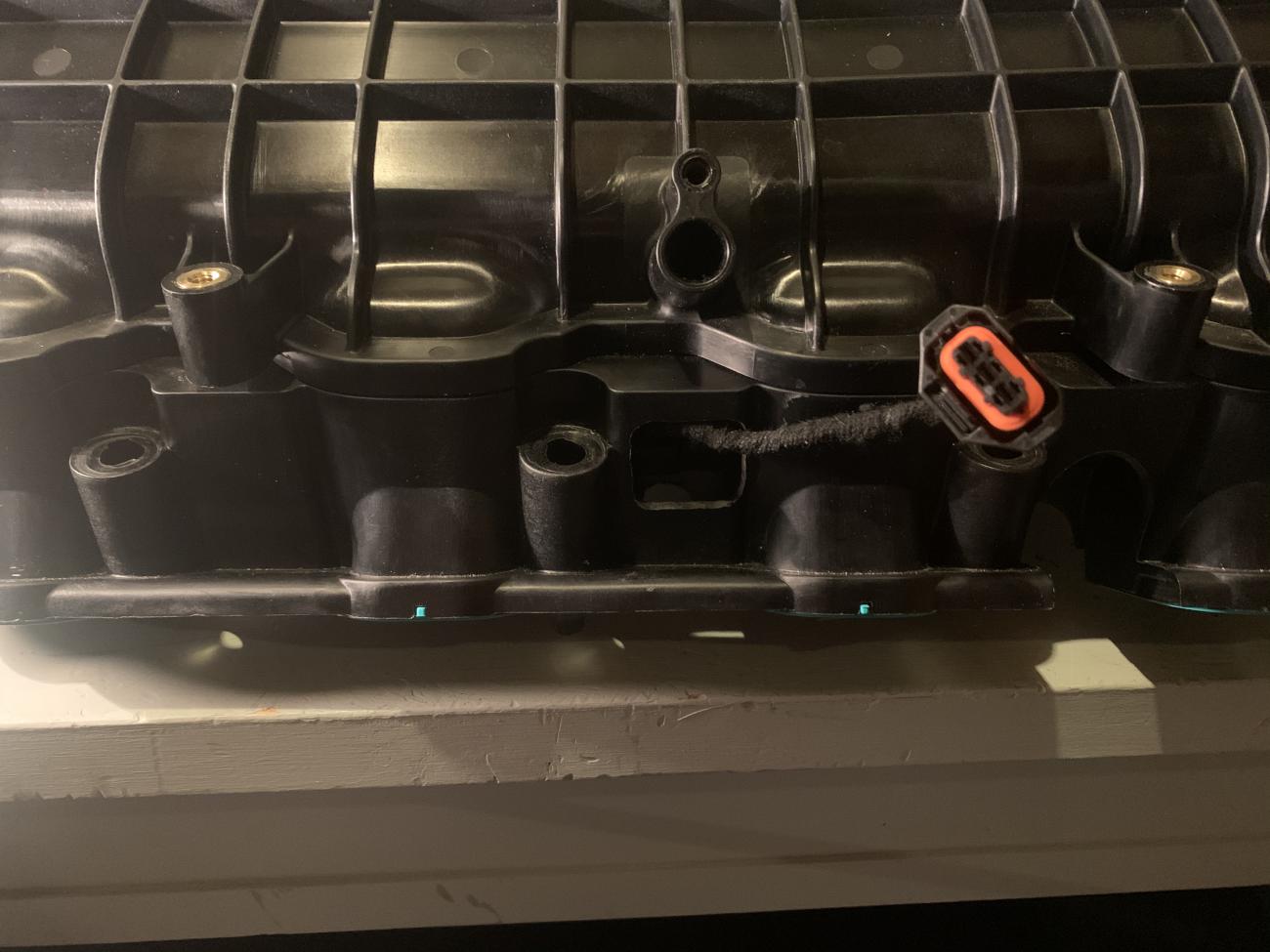

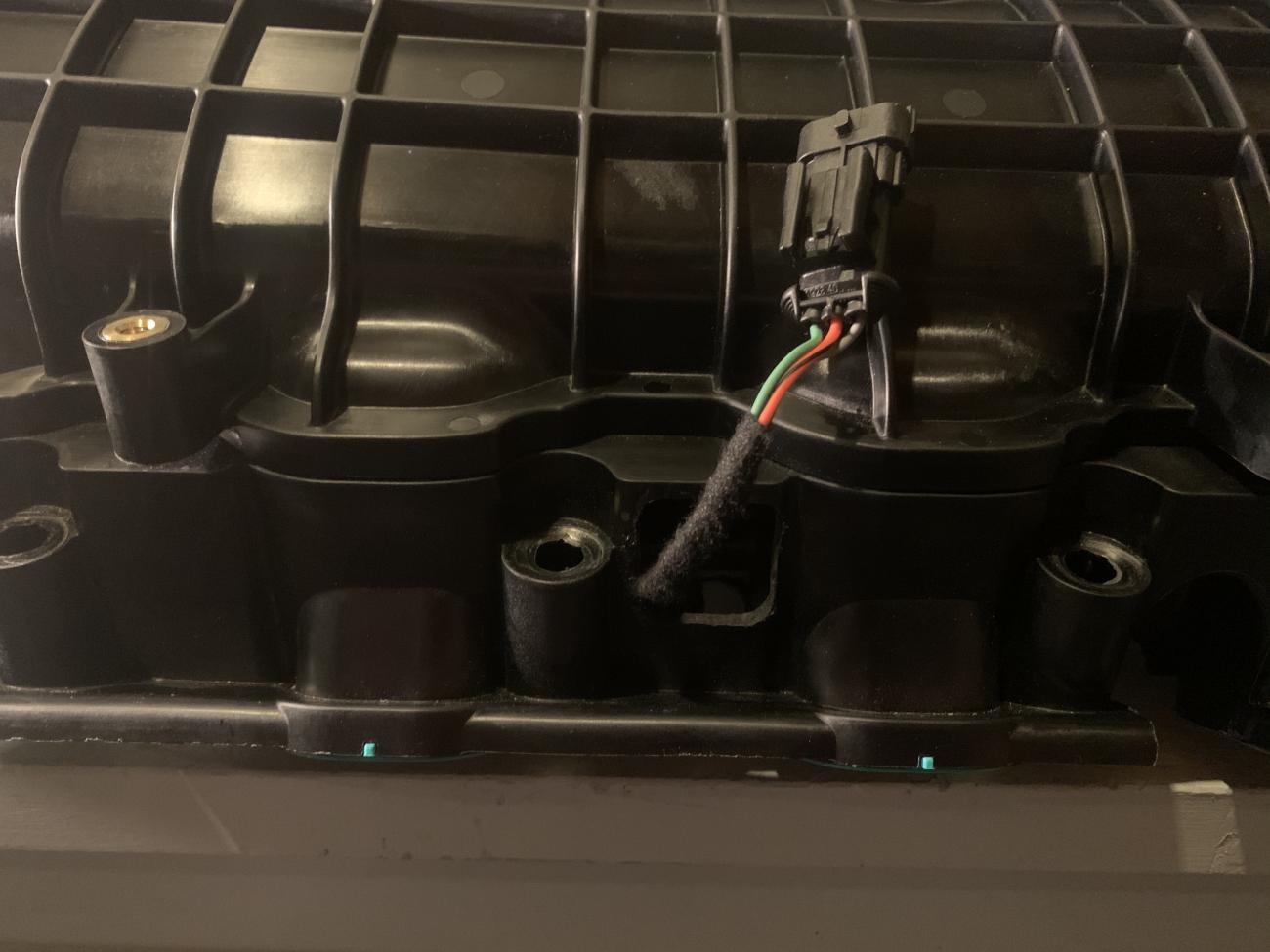

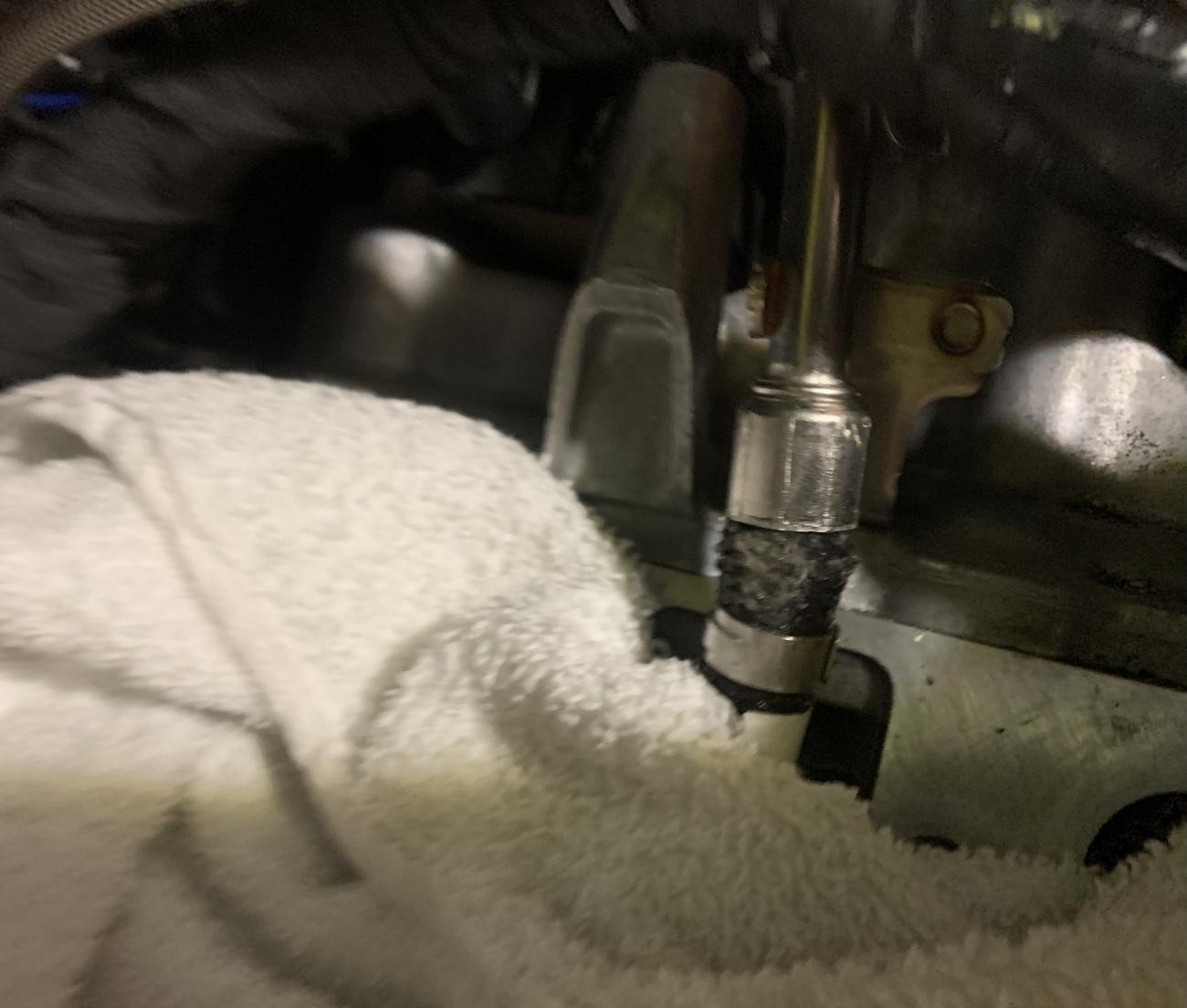

Did a Test fit with new routing of wire.
Tried out the new routing of the wire and it fits nice. I put back the soft absorber foam over fuel injector system and it fits nice with the bottom of the LT2 shaved. I wrapped the wire line for map sensor it the heat foil tape. The height of the wire is actually lower then the plastic parts shaved off.
This set up allows the wire underneath with no chance of pinching or chaffing the wire.

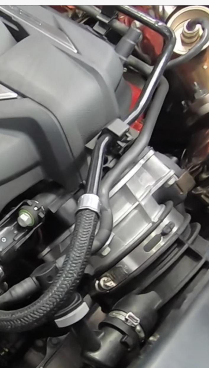

Mystery solved.
That front screw hole on the corvette cover looks like it’s used to clamp down a hose. Might be useful to our application maybe. I can’t find the part number for that clip and it seems that parts for the 2020 Corvette is a national secret. I go to GM parts and they don’t let you view the parts list.
It almost looks like it’s our dreaded draped over the cover fuel feed line. At least the corvette guys had the smarts not to route across the top.

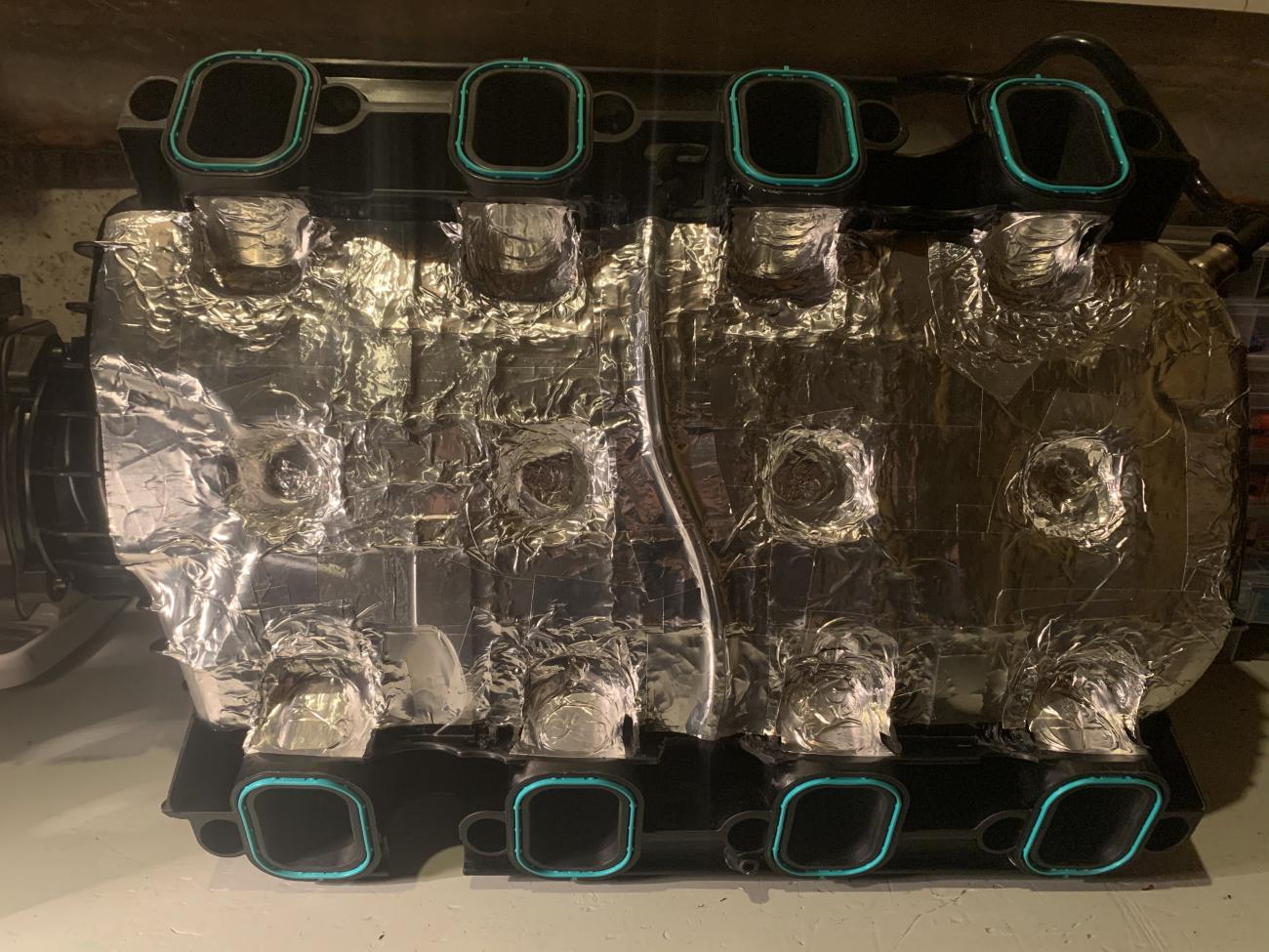

I was not happy with the Map Sensor across the top. I original lengthen the sensor wire and it worked fine for awhile. Then I started getting voltage problems caused by the wire on my map sensor and a few codes. I switch backed to the shorter version and it was fine. Now I decided to tuck underneath the manifold after someone else did it. I am concerned about the wire compressing to much on engine and manifold. So I decided to shave the bottom and put two side port windows on manifold in order to pass wire thru the sides without any compression. I was originally just going to make a small channel for the wire to run underneath, but I got carried away and shaved the whole bottom. I then decided to wrap the bottom in heat foil tape.
Basically I did this because of the wire, don’t no if any benefits of wrapping bottom with the foil tape but it certainly can’t hurt.

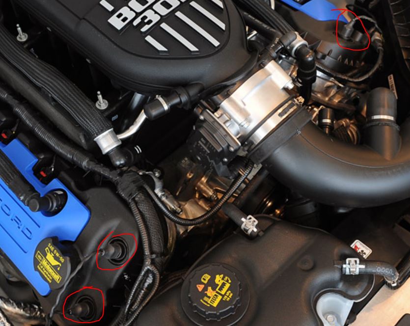

Yep, plus add in an additional connector/pin joint
What I mean with the heat-shrink is as below. Ford did this with the TiVCT sensor connectors after the first season of competition of their Boss 302R/S cars as they were finding that engine vibrations from sustained high RPM's would cause continuity/resistance changes and create minor power losses. For the street cars, the connectors were changed for 2013MY+ 5.0L's (Coyote and Road Runner) and the race cars got their connectors heat-shrink tube wrapped.

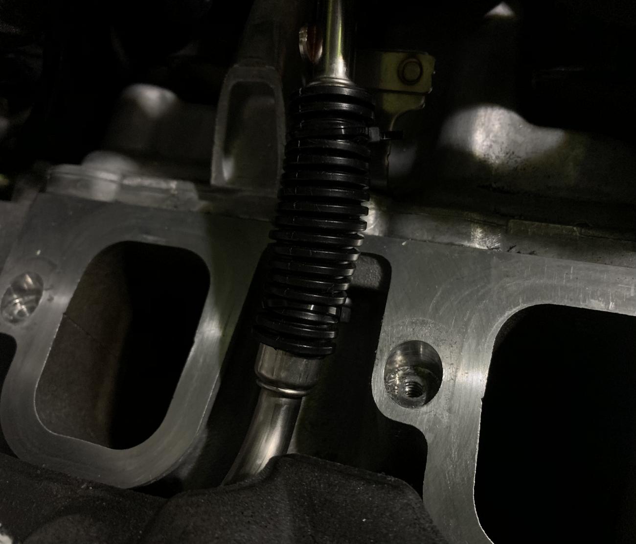

Rubbing Issue?
Might be nothing but might be worth checking. I noticed after removing the intake manifold on the drivers fuel side that in was worn a bit. Not sure if it’s just me taking the manifold on and off a few times or a rubbing issue. Either way I decided to just put a plastic sleeve on that part of exposed rubber fuel line with a few zip ties.
LT4 1.7 Supercharger snout ported & 100% Meth
103 Katech TB, KATECH Custom Heads, DSX In-line fuel
TSP Headers, Spec P Super Twin Clutch, TSP EL C7 CAM
Diamond Piston & Manley Rods, Roto Fab Big Gulp
BTR Push Rods,LS7 Lifters, ARP, FI Chiller, Kirkey Seats
SJM Line Lock, Hurst Pistol Grip. 747/739 RWHP street tune - 821/794 RWHP track tune 101 octane.
2014 Mini Cooper countryman S All4 M6 daily driver
BlackbeastSS2 is offline   Reply With Quote
Old 12-06-2020, 03:34 PM   #112
6spdhyperblue
Drives: 2SS 1LE
Join Date: Aug 2013
Location: US
Posts: 3,794
Yeah that’s not good
