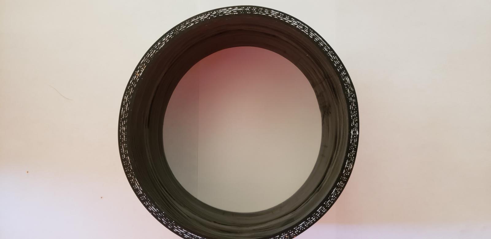

I had 4 reducers made to go from 5 inch (big gulp) to 4.75 (NW 112mm).. so 3 to sale if any other TBs out there.
No one in USA wanted to help or sale so I went to there source directly.
4 ply silicone 127mm to 120mm or 5 inch to 4.75 inches..
About to get back on it..
