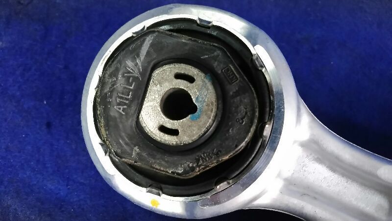

The castings are all the same, the entire point is bushing changes. FE4 bushings are stiffer than FE2/3, but the FEA's are stiffer yet.
As an example There are 3 sets of part numbers for both front control arms, since you cannot buy the bushings separately.
Here, I found an FE4 front "trailing" arm on eBay: https://www.ebay.com/itm/2016-2017-C...-/282760176103
And here's the picture of the bushing. Clearly different than the FEA bushing, which has a much larger bushing ID and thus cannot deflect as much regardless of rubber durometer.
The FE4 suspension also has no spherical bearings, the FEA has 4 (one in each lateral lower control arm, front and rear), 6 if you include the strut mounts.
All of this combines to improve the dynamic alignment of the FEA over the FE4.

See, I'm thinking more about the sphericals. I thought the FE4 had the added sphericals. Case in point, if you buy the 1LE suspension upgrade package or the sway bar package from GM PP, it comes with the front, lateral (or "rear") link that has the sperical. These kits, and that link, have been stated by GM to be the same as on the SS 1LE and ZL1. That, plus GM states the bushings in the SS 1LE and ZL1 to be stiffer than the SS, but I don't recall GM specifically saying the ZL1 1LE suspension bushings being upgraded over the ZL1 (obviously from that picture, they are). Only the solid mounted rear cradle and solid top mounts for the front coil overs.

OK, so something is up. I have a list of parts to potentially upgrade on my SS. Of which, are the OEM FE4 suspension links. In example, the front, lower radius arm, the one you have pictured, for the left on a'17 SS 1LE is service part number 84051641. Take a look at this: http://www.camaro5.com/forums/showth...=505806&page=4
A few pictures look to have the more solid bushing, like the "ZL1 1LE" kit has, but the others have what you posted. Unless, according to the guys comments, the initial pictures are some "standard SS" ones he got a hold of?
