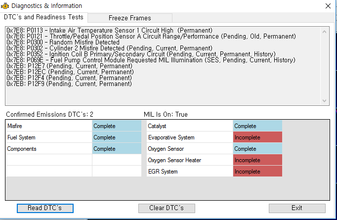

I get these codes. Do you think what cause these troubles?
codes marked permanent will take up to 8 successful key cycles to disappear.
All codes are hardware related.
You removed the exhaust control valves which is casing the last 4 codes.
We have modules to eliminate those codes.
What hardwares should I check first? Coils?
Should I purchase a module to elminate codes related in exhaust control valves.
Thank you.
Jay
Thank you.
Jay
Coil Number 2 indicated by the codes.
Thank you.
I will check and may replace that coil tomorrow then let you know what happens. Thank you for support, Ted.
