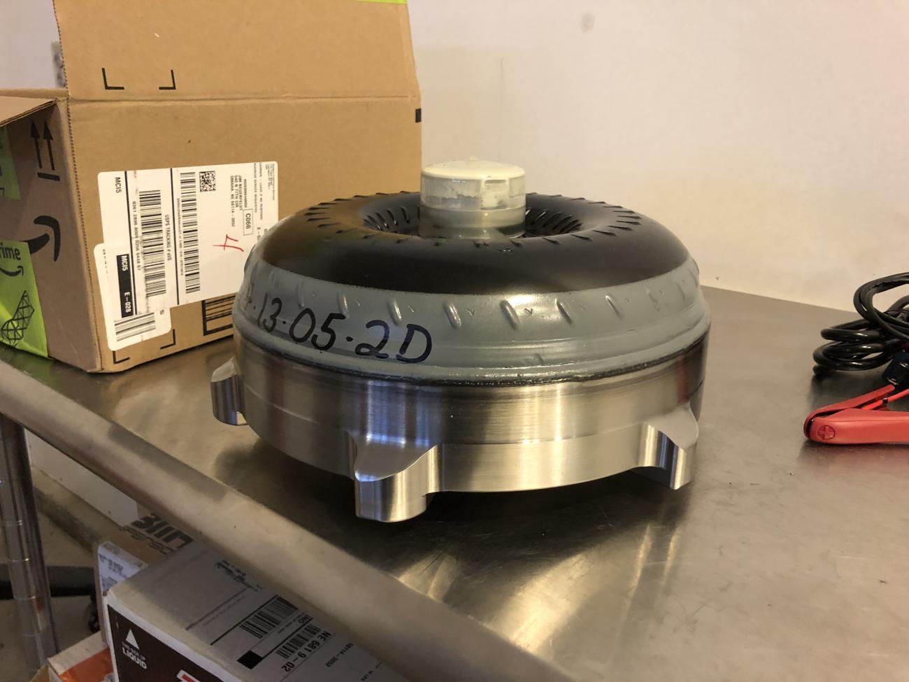

I have a new plan compared to 2 posts above. Most of this will be done by spring.
Circle d converter
Gforce axles and driveshaft, stock diff
Still doing the f14 drag pack
42 autosports trans build
Cms drop in rods and pistons
Patrick g spec cam, dod delete, head studs...
Cut outs
So far I have the converter and am pulling the drivetrain out of the car.
