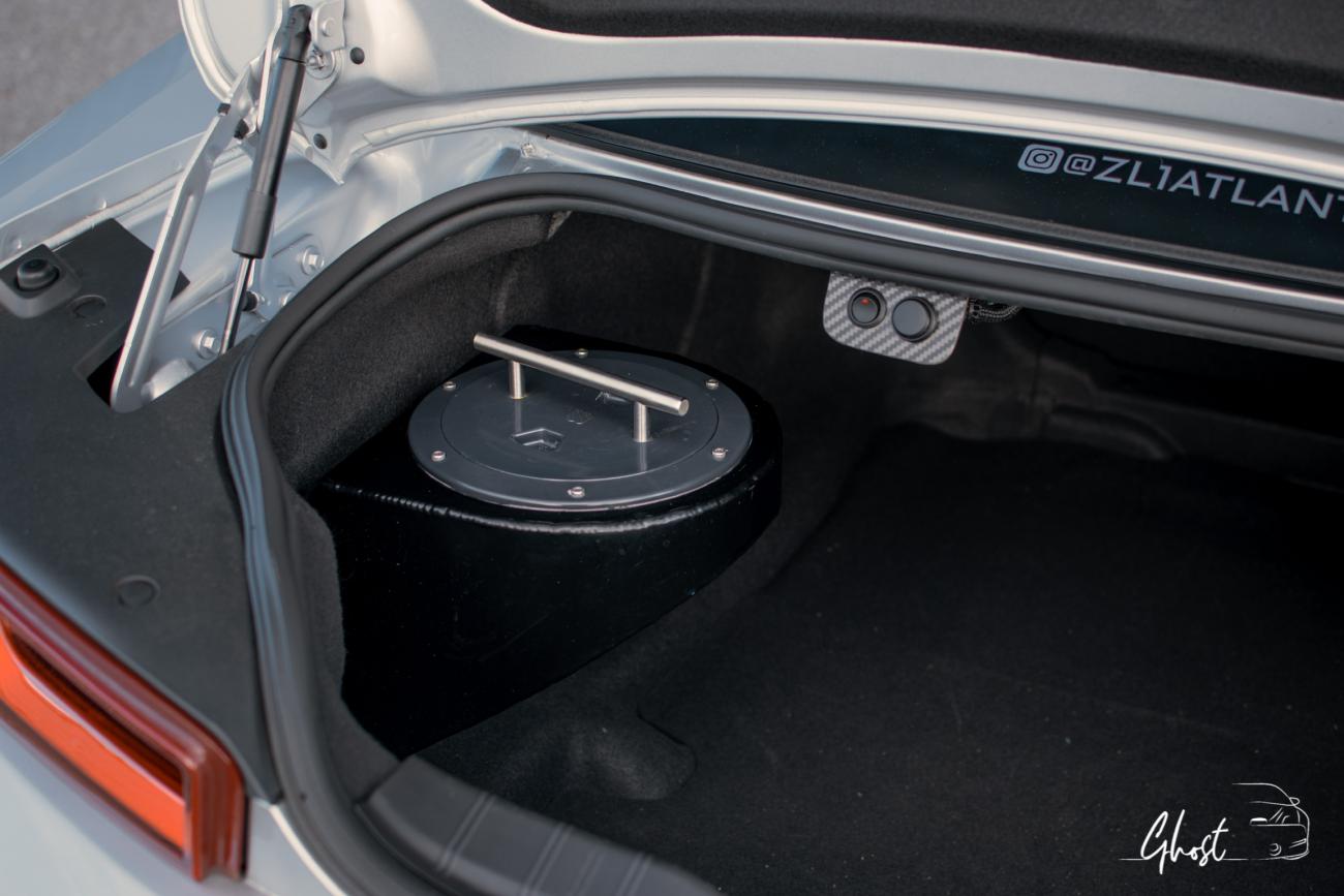

This is the best explanation I've seen on this topic, thanks. At least on ethanol, we have proven that a 1400 RWHP ice tank car with hot water flowing will gain 25-30 RWHP with ice in it. Every bit counts though.
Does your system only run when the car is running, or can you also circulate water when the engine is off?
2020 ZL1LE A10.
100 octane: 1045hp/1055tq.
Old 05-12-2022, 02:50 PM   #95
ZL1Atlanta
ZL1Atlanta's Avatar
Drives: 2017 Chevrolet Camaro ZL1
Join Date: Jul 2018
Location: Canton, GA
Posts: 475
I can drain and circulate from the trunk but it runs all the time with the ignition on.

So, you hook up a 12v generator and a battery charger while in the pits, or?
No, it doesn't take that much power to run the pump and the actuator that dumps the water. You run it just enough to where you feel the lines going to blower being cold.
