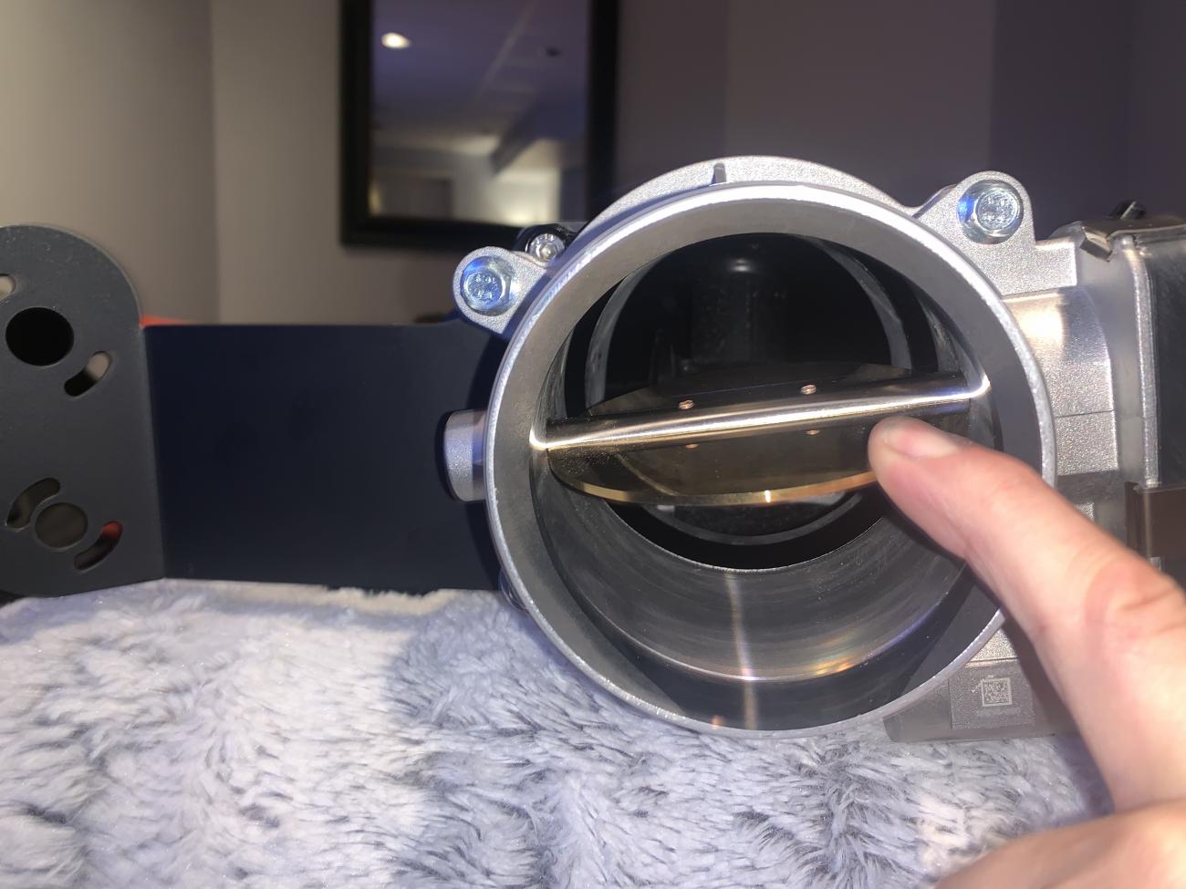

Finally received my intake, think I'm going to do minimal porting to it as everything feels really good. Most of the seams in the plastic seem like they step up larger, so the air seems like it wouldn't be affected much.
I also have a 95mm throttle body and dont think I'll actually be putting it on for two reasons.
#1 the altitude I'm at I don't have an issue with map vs ambient air as it is. My altitude is 6400+ and I don't believe throwing a larger throttle body will do much.
#2 I saw the intake is kinda thin on the throat so you cant fully open it up to utilize 100% of the 95mm.
I have access to a milling machine so the TB wont need a adapter if I do decide down the road to install it. I also machined some ofr the cross bar in it just like I did on my stock one.

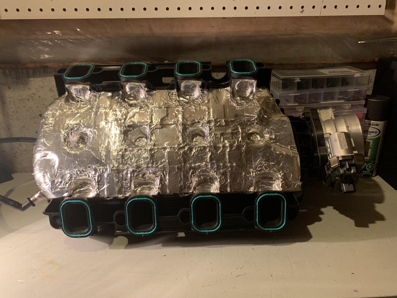

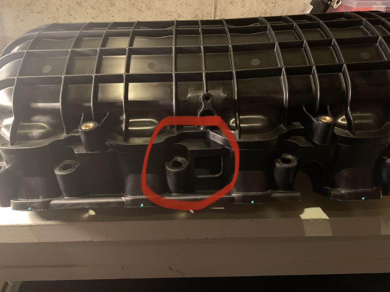

I took the LT2 Intake Manifold off today.
I was not happy with the Map Sensor across the top. I original lengthen the sensor wire and it worked fine for awhile. Then I started getting voltage problems caused by the wire on my map sensor and a few codes. I switch backed to the shorter version and it was fine. Now I decided to tuck underneath the manifold after someone else did it. I am concerned about the wire compressing to much on engine and manifold. So I decided to shave the bottom and put two side port windows on manifold in order to pass wire thru the sides without any compression. I was originally just going to make a small channel for the wire to run underneath, but I got carried away and shaved the whole bottom. I then decided to wrap the bottom in heat foil tape.
Basically I did this because of the wire, don’t no if any benefits of wrapping bottom with the foil tape but it certainly can’t hurt.
My next mission is get a 2020 Corvette Intake Manifold bolt or just go down to the dealership to see if ordering it is the same. I am a bit concerned if the bolts are the same length or not. It’s piece of mind for me. The Corvette manifold is taller so I almost think the bolts are longer.

Do you think the stock LT1 intake studs are too short? < how much taller are holes versus the LT1 intake?

Great job and feed back, so the stock map sensor wire will reach no problem going under the shaved bottom and thru your port holes, no need to buy the extension for the map harness?? I would say keeping the intake cool is the way to go. I am following your lead, am close to doing this on my 2021 LT1
Sorry but that’s with the GPI map sensor extension. The stock one would never reach.
I actually think they are to short but I have to get the info on the Corvette intake manifold bolt. Either way I really do care if they are the same length or different lengths I just want to know the correct info. Because when I torque them down it just didn’t feel the same as the stock Camaro set up. Could be just me.

which extension did you finally get and use, I am going to order one very soon. I can check with a chevy dealer on the intake stud part # versus the LT1 part #. So you do not like the way it feels when you are torqueing the bolts? are you using the barrels also?
I tried both with sleeves and no sleeves. Just didn’t feel right. Ended up with sleeves in.
Map Extension Harness for LT2 Intake Manifold
