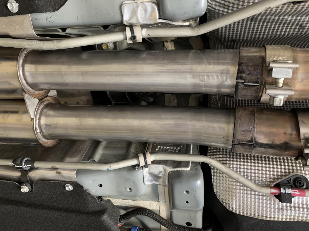

Bringing this back alive... I just removed my cats, its loud .
My Setup
2" Kooks Headers
3" Borla Cat back w/Stype Mufflers
My question is, what kind of fabrication is needed to fit the magnaflow in place of the 2x pipes that come with the borla kit for each bank? Almost seems like by looking at the lenth of the magnaflow and the straight pipes it might be a simple swap?
If anyone has similiar setup let me know. Thanks.. I have the magnaflow in the garage.

Borla system is in pieces, not like the stock exhaist.. Shouldnt be anything to cut out.
See pic.

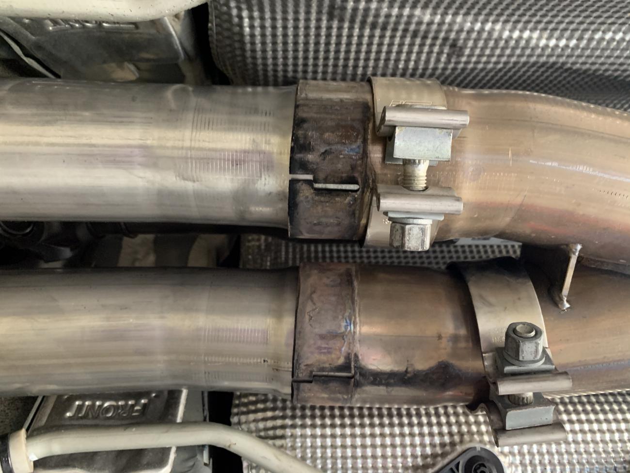

I just wanted to update. I got the borla 60608 today and had a local shop for it for me.
Basically the rear section was expanded to the same size as the 3” borla mid pipes which fit right into the rear section. The front section they made a reducer to 3” and welded it onto the resonator and my front pipes after the cats.
The good thing like this is I can still easily remove the back sections as well as the front. The front however will just come off as 1 piece with resonators.
I forgot to get completed pics, and just got the rear part after they expanded it.
Sound is much more mellow and rasp gone/deeper tone is back.

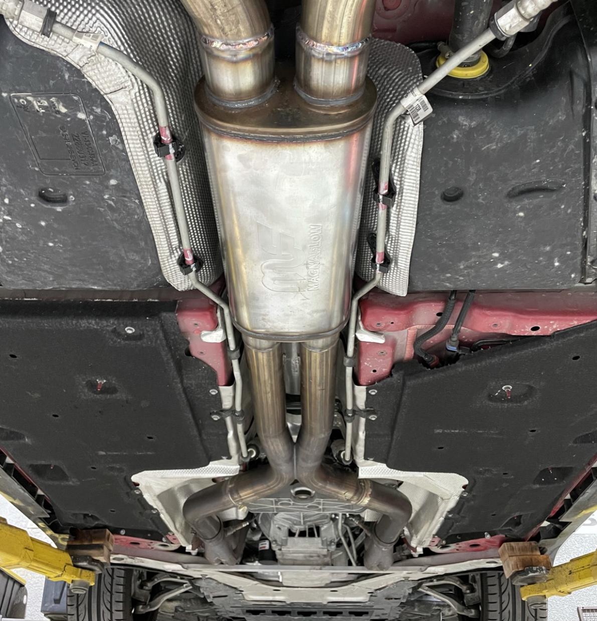

Instead of doing a double-Y internal muffler, just use Magnaflow 3" by 18" dual resonators. They will fit and achieve the same thing with way more flow.
Setup below is two magnaflow 3" x 18" resonators, corsa sport, catless mids, 2" longtubes. Mild startup, tame cruise, wrath of hades WOT.

I was going to go this route, I still have the X-Flow muffler sitting in my garage but when we looked at it at the exhaust shop, the clearance was just too tight for my liking. I don't want the exhaust to touch any part of the car or those lines that run right by the muffler.
No lines touch
However, a little of the transmission support edge was taken out with a grinder to clear the resonator
All other lines comfortably clear, it took 6 hrs from start to finish. Got rid of the catback clamps and everything was tig welded as a single piece
