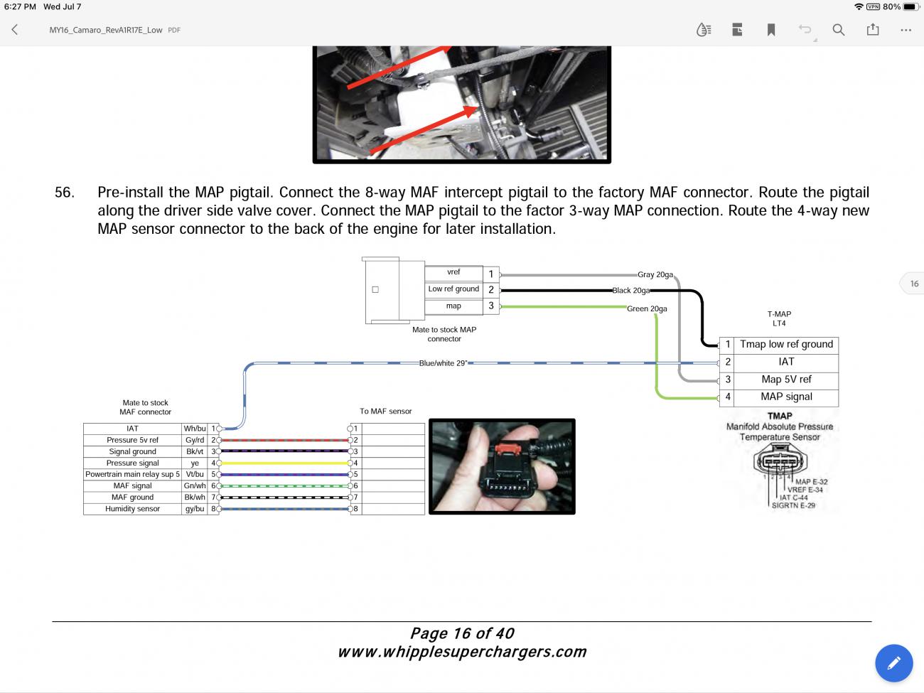

Yes set to GM standard everything but boost is reading well it reqd 0.0 all the other pressures like map and absolute manifold pressure read but its not boost lol and its usually in HG. I'm not sure if it has a built calculator from map to baro. Or it you have to have a certain map sensor from some threads I read on the aeroforce. I'm using the boush 0261230042 map sensor.
Seems to be a SS issue vs zl1 not having any problems on the Z.
Also what did you select under the pressure category?

No problem reading boost on my iDash...
Care to explain how you are or what your setup is please?
So in case it helps others, the Whipple setup comes with an LT4 TMAP and a harness that breaks out the IAT out of the MAF (and to the LT4 TMAP). When I setup the iDash, I believe I just selected generic GM car and it’s always read boost no problem. Pics from the install manual attached.

No issues reading boost on mine. previously LT4 blower, now whipple
Do you remember what you selected on the guage?
Map Psia
MAP in HG
Boost Vacuum
Boost
Absolute manifold pressure
And so on..
Honestly it reads it but not correctly which I believe the formula is calculated with a 3.5 or GM MAP sensor especially since I've seen some threads where Jannety sent a map sensor and file and there guage worked.
Map Psia
MAP in HG
Boost Vacuum
Boost
And so on..
I too can't seem to get boost to show up correctly on my SS procharged setup. Does anyone have what they select to properly show it? TIA

I'm still not reading boost on a 2016 SS procharged. Does anyone know the settings I should use to get the boost to read? I can read everything else including ethanol.
