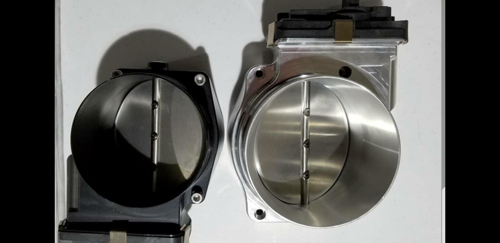

It’s too bad NW won’t build a 132mm for us. I’m not sure I want to spend $600 bucks only to gain a little over 3/8 of an an inch in throttle body size. Let these blowers breath already. Why do Coyotes get to have all the fun? I guess 9mm is a start but really not much of an improvement.
I had a 132mm TB on my Coyote

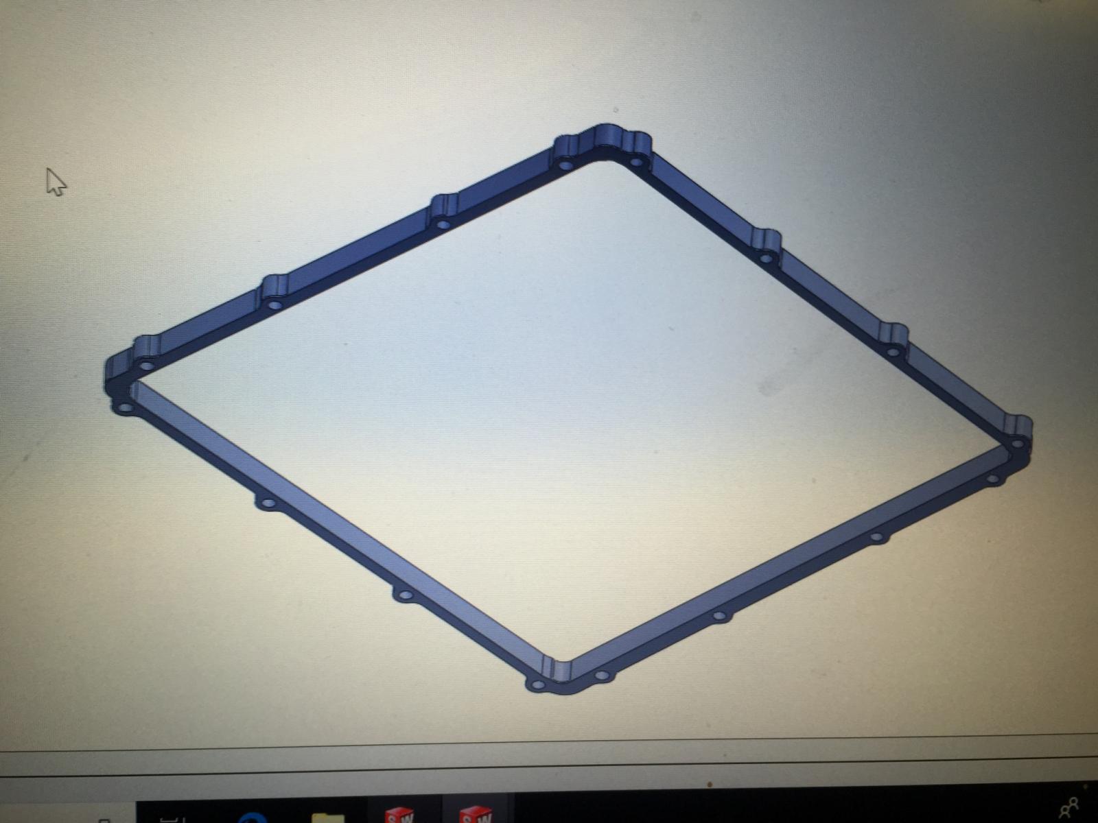

Lid spacer file ready let's add some plenum and cooler air!
Heads here Wednesday!
112mm already Here!
Adapter from LT4 to Ls Finished!

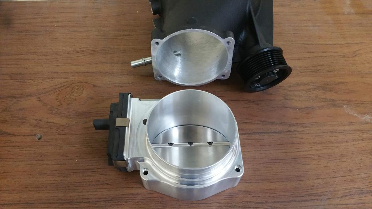

Roto_fab1, what is the OD of the tube and what kind of couple and what are its specs? Does it come to fit an OEM TB, 103mm TB, or in my case what do I need for a 112mm TB. If I remember Nick Williams told me 4.75 inches is what the coupler needs to slide over.
I been trying to reach yall.. no one answered not even Jennifer.. tried Friday and yesterday.. look for the 817 number in call history.

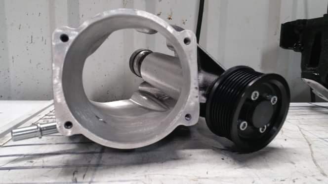

112mm TB fitting the adapter

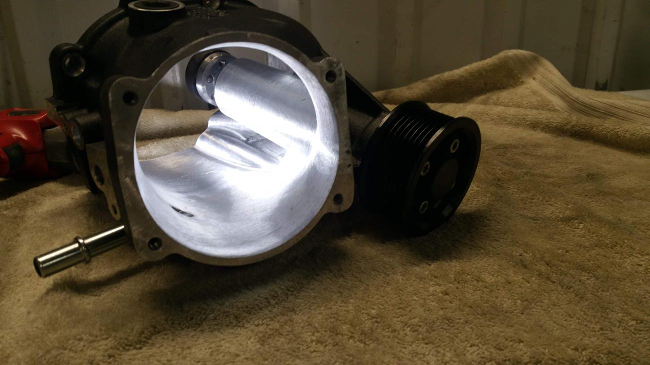

Finally finished Thanks to David at Boostmode Racing! Snout and adapter fitment work turned out Amazing!

Posts: 247
That looks great. What does Boost Mode charge to port a snout?
ramairroughneck is offline   Reply With Quote
Old 03-01-2019, 04:01 AM   #94
EDFHOBBIES
Dyno Show Queen LOL
EDFHOBBIES's Avatar
Join Date: Jan 2014
Posts: 4,354
250.00 Also when I was considering the LT4 route he was going to do 1000.00 for max effort. They have some fast cars looking at there FB page.

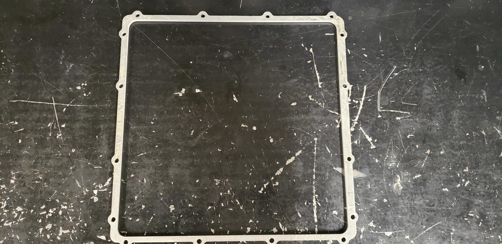

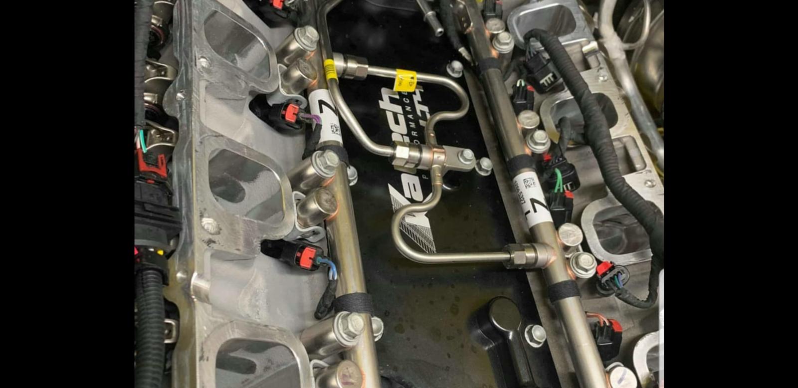

Spacer 1 of many..
