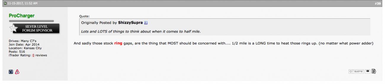

Describes my issue. But I have not monitored any fuel pressures while driving it since it was tuned last spring.
http://www.camaro6.com/forums/showth...ing+gap&page=3
