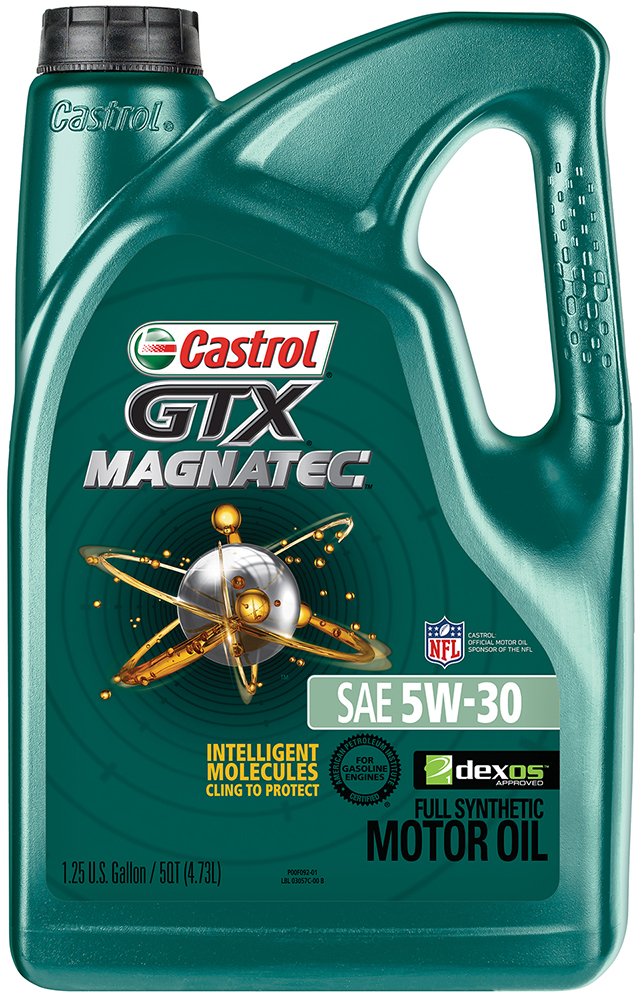

This stuff any good?
I saw throughout this thread that Castrol was rated pretty good overall, but there are so many types under each brand it's hard to know if it is still a true statement for each type.
Castrol 03057 GTX Magnatec 5W-30
Probably OK for Dexos1 use. I wouldn't run it if you track your car, though.

If it says Dexos 1, and it's 5W-30 weight...it's good for street use.

Hmmm, cool thanks! Another thing that had me doubting is it's $17.88 for 5-quarts on Amazon right now.
