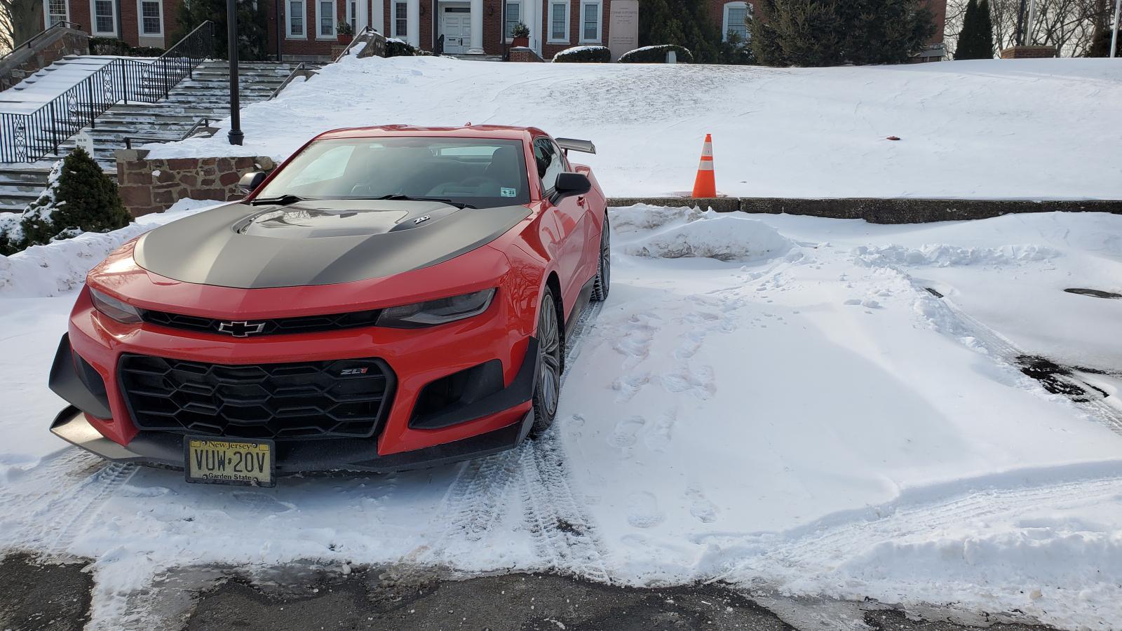

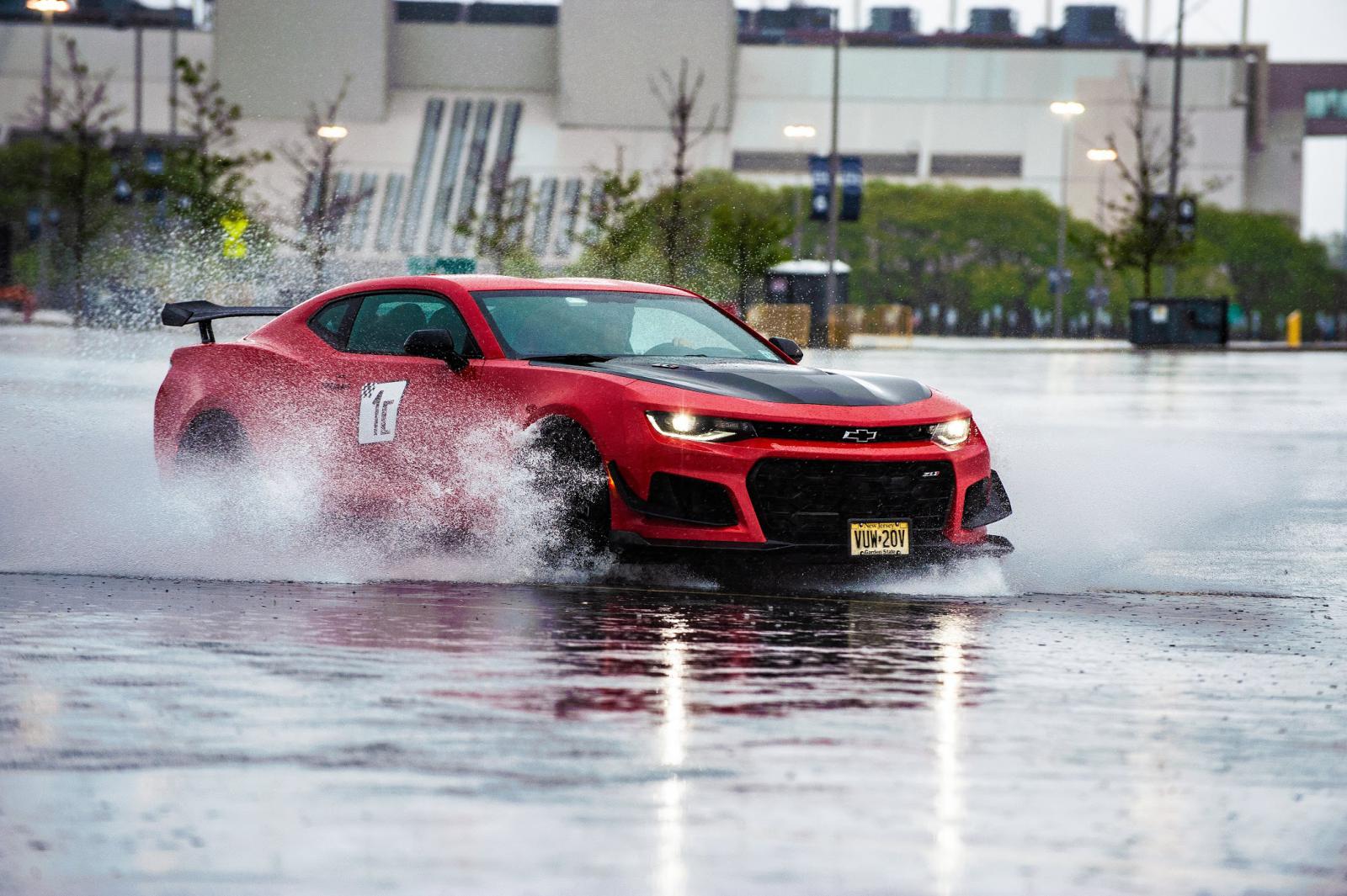

Aug 2020 - pump failed and was replaced under warranty @ 22,000 miles
Feb 2022 - 28,000 miles, still going strong.
Driven year round. Waxers.. look away

Wow i respect your willingness to drive the car thru salty roads.. but hey i think the previous owner of my ZL1 did the same lol.

If that was my car I’d have chest pain. I don’t take mine out when there’s a possibility of rain.

No worries, it gets occasionally washed.

Admittedly I don't see the logic of driving a ZL1 in salt/snow/rain - it's not any fun (potentially dangerous) and trashes the car (especially the paint). In Michigan we called it a "salt ride" or daily beater, but everybody needs one. In my case it's a 2014 V6 Accord I picked up for $9k with 50k miles and it's been faultless.
