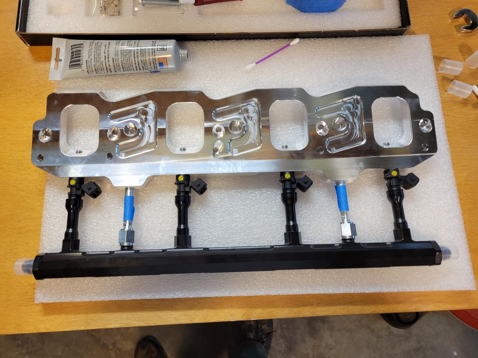

Got some work done on this today. I have some additional thoughts and notes that I'll write more about in the next day or two.
Summary is: Plates are assembled with injectors. I stopped after the passenger side test fit. I cant go further until i get the rest of my fittings.
