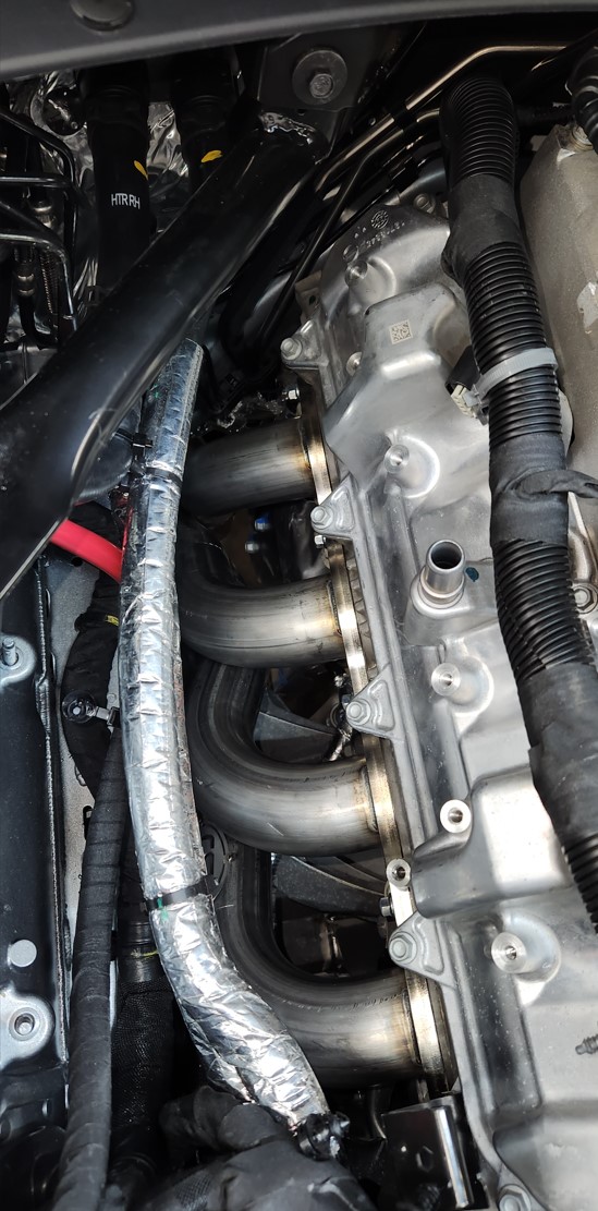

OK, didn't take a pic of it but I was able to repair the cut O2 sensor wire. I added a length and soldered to the cut end closest to the connector first. Then, I took the other end of the length of wire and soldered it to the other cut end. Used heat shrink around the repair and it looked good! Got the first set of cats removed and was able to get the headers bolted up! The drivers side was a breeze! I just removed the steering column link and the drivers side header slipped straight in from the engine side! The passenger side was close to doing the same, but the starter heat shield bolts were in the way. I ended up drop the entire sub-frame under the front of the car and had the slide the passenger side header up from the bottom. Got them torqued to 22 Ft lbs. and ready to started the rest of the exhaust tomorrow. Also, I decided to open open my catch can to see what it looked like. I was a bit shocked with the amount of fluid in the can with so little miles on my car. But, those so little miles were hard and fast miles.

Last evening, I was able to get the engine side of things buttoned up. Just need to reinstall air intake and tighten clamps, then ready to finish exhaust. I might do a video on startup with ONLY HEADERS before completing the exhaust! After that, I’ll get my remote tune! Also, ran into a snag while double checking all the bolts that needed torqued. I realized I didn't have my oil dipstick bracket attached to the valve cover. Then I remembered, it wasn’t attached because the new Katech valve covers don't have the threaded bolt hole for the bracket like the stock one does. I can't just push it over to the right valve cover bolt as it puts a lot of strain on it. It also 100% blocks the spark plug, and the plug wire from connecting. I reached out to Katech and waiting to hear back from them. But I might be making a bracket I guess. Hind sight, probably should stop progress where I'm at. As I decided to order a complete CAM kit and would like to get it installed now before the weather starts getting too nice! All for now. I’ll take better pics of the completed engine side later this weekend! Take Care!
