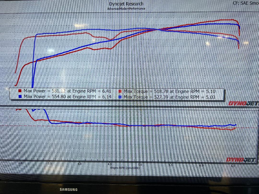

Well as you can see from the DYNO chart, the car makes MAX power around 6200 so I dont think we will go much past 6600.
If we switch out to MSD and 103TB then MAX power will be 6500-6600. I didnt ask what the limiter is set to but I will find out LOL

updated DYNO 5-28-22
Name:  dyno with MSD.jpg

FEEDBACK on UPGRADES after TRACK DAY
Yesterday was first day to track since the upgrade to the track seats and LME416. I managed to go off HARD and I cut a tire on my AZENIS RT660 track 200TW tires so I had to switch to my street setup MS 4S 300TW tires. I thought the timing loop was ON at the track but it wasnt so my transponder was usesless so I have to go by my BUTT meter in regards to any comparisons to my PRIOR setup (an LT1). I will get back to that later.
First the track seats worked out REALLY well. I INTIALLY got some feedback from another owner that he didnt like the fact that they seemed to have a little GIVE to them under high G force. I personally did NOT find that to be the case at all. My guess that the attachment hardware I used which was all GRADE 8 bolts probably provided a stronger attachment base for the seats than what he used. I will say that these seats are fairly NARROW at around 14 inches of side to side clearance. If you are anything over 36 inch waist size, these may be too tight. They DO give you as I mentioned earlier another 1-2 inches head clearance as they do sit lower than the stock seats using the PLANTED seat brackets.
The EOS carbon Fiber side skirts JUST INSTALLED survived the track off experience without a scratch. As I suspected everything was kept BELOW the car. The 25 rivets that hold EACH skirt on NO DOUBT did their job. With tape only install no doubt these skirts would be OFF the car in SEVERAL pieces. The EOS front chin splitter DID sustain some damage but that is easily repairable because is painted a TEXTURED black. The CARBON Fiber version no doubt is better looking but probably NOT a good idea on a car that is tracked.
The LME setp has about 100 MORE RWHP than the LT1 it replaced. Can you feel that??? ABSOLUTELY. I was between 10-15 MPH faster on the straights and you could feel the car slide the car around momentarily on the rear at times before it would BITE especially on the 300TW Michelins. What I will have to adjust to is exactly where my POWER on points are because the car picks up speed faster. There are also some of the points on the track that I could go FULL SPEED on with the LT1 that I CANT now because of the increased speed capability.
After ALL of the upgrades the car comes in around 3620 pounds (SEE PIC) including roughly 6 gallons of fuel for a DRY WEIGHT then of roughly 3580. The seat replacement took 40 pounds off the weight and the exhaust system with KOOKS headers and MAGNAFLOW axle back saved some weight and the APEX wheels and tires are lighter. The CLASS 1 trailer hitch ADDED 20 pounds. ALL in ALL I am about 100 pounds lighter than STOCK.
The SECOND picture is what it looks like UNDER HOOD>
