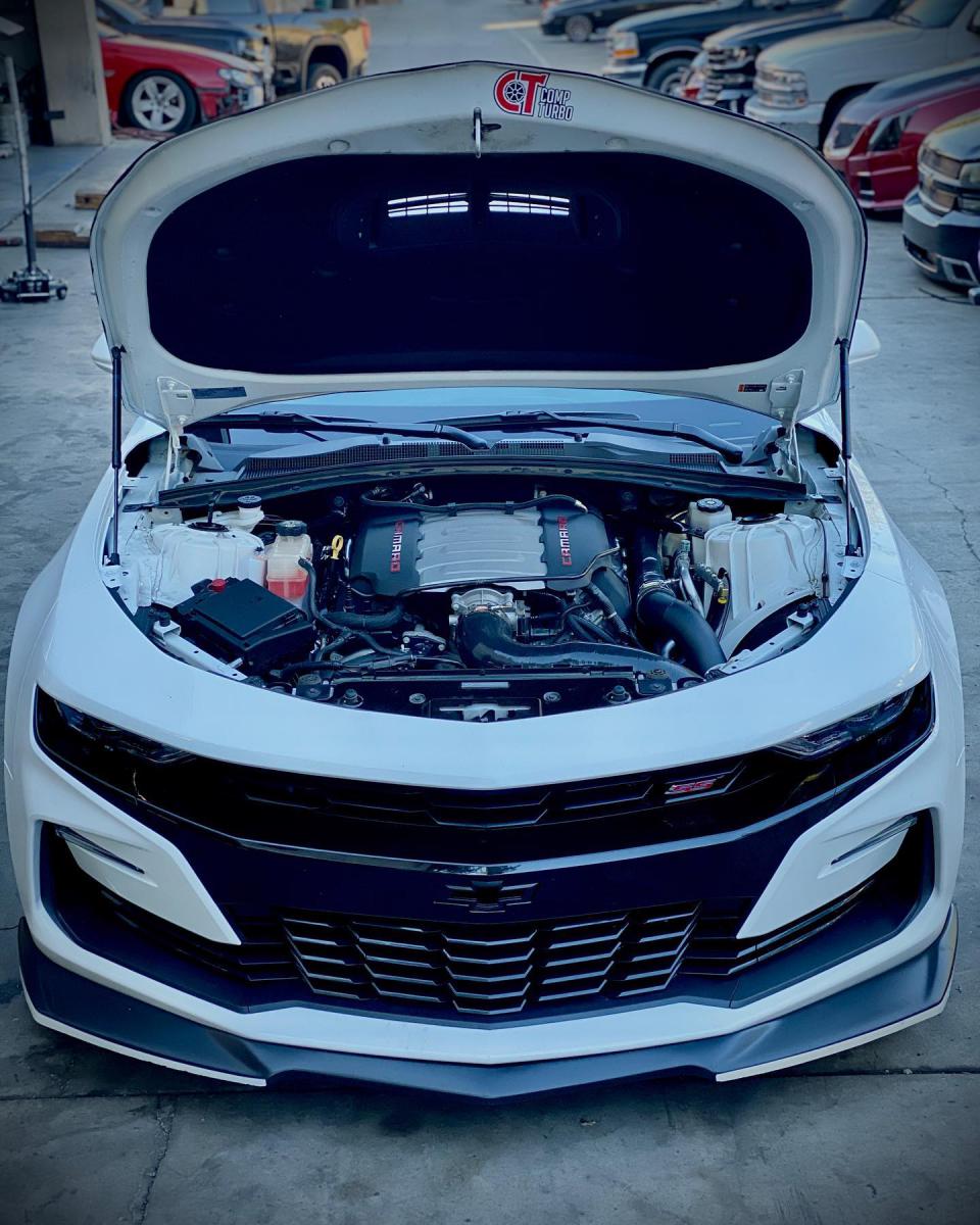

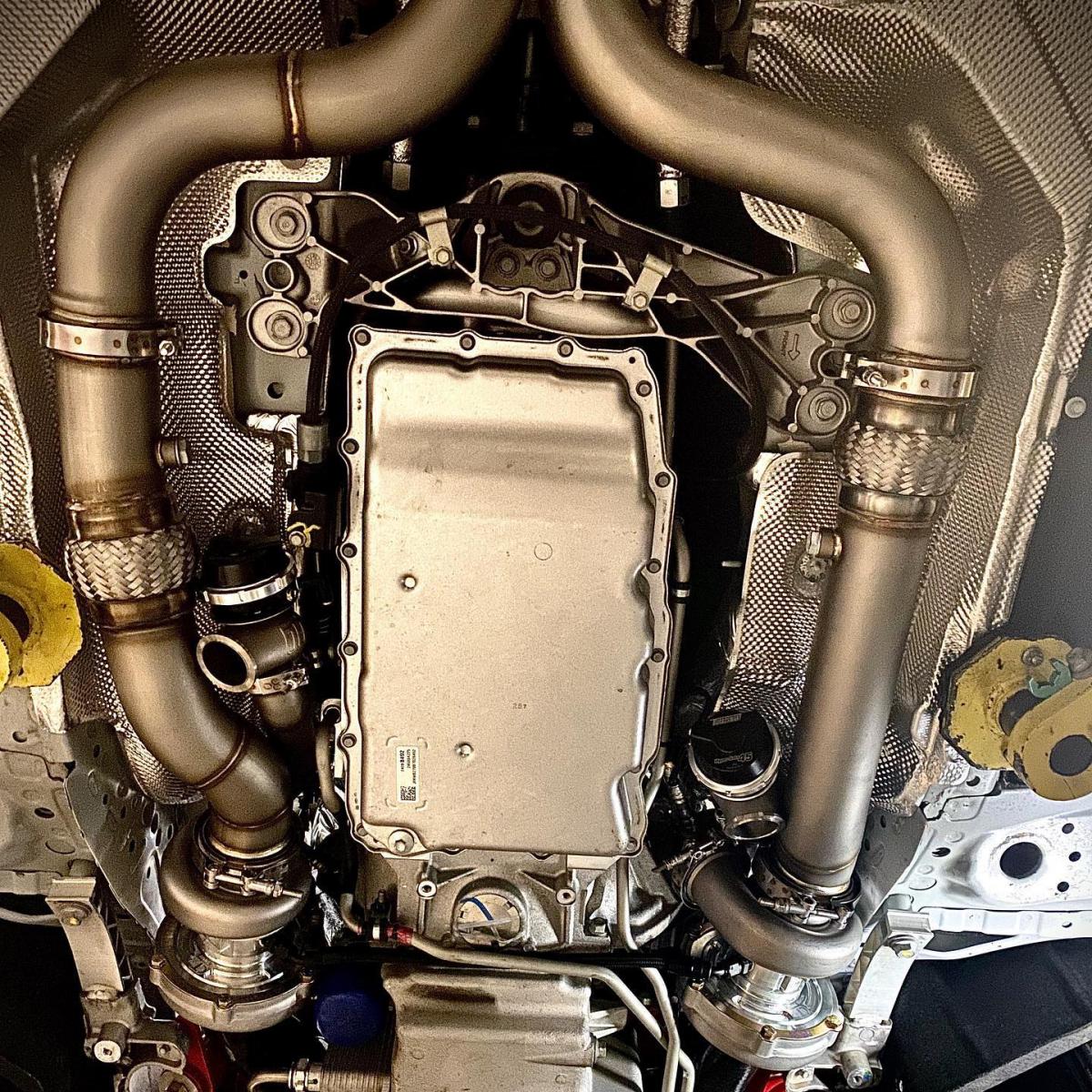

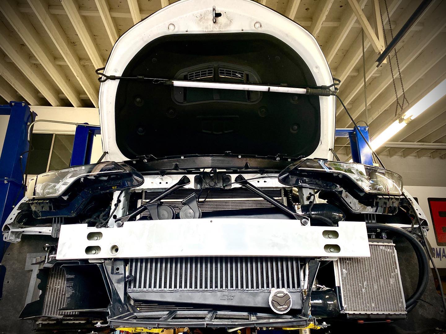

Posts: 689
Results in from New Era!
100% bone stock 2019 SS A10 car
91 Octane
Stock Fuel System
Stock Cam
All Stock!
6 psi (tried 10 psi but ran out of fueling on the all stock setup)
584rwhp, 579 rwhp
(+200 rwhp gain over stock with the twin kit being the only modification)
https://www.facebook.com/neweraperfo...0038509070203/
Huron Speed is offline   Reply With Quote
