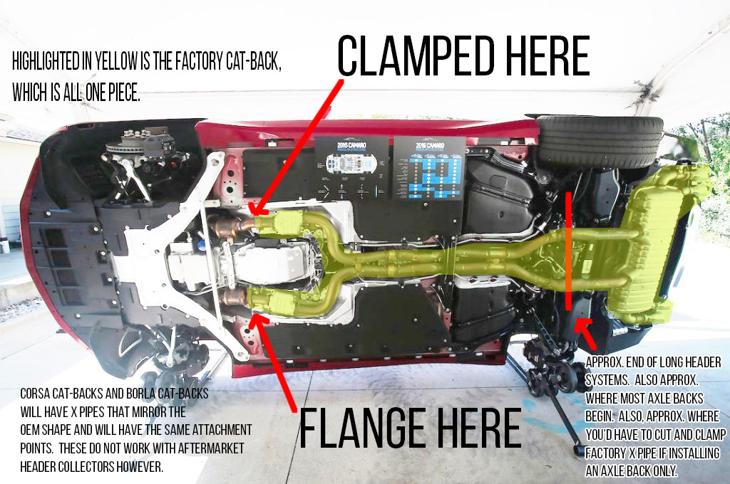

To answer your question, either will work. None of them are going to "bolt right up" to the Cat-back system however. The Collector of either header is going to be further towards the tailpipes than the clamp and flange of the Corsa X Pipe. At the minimum, there'd have to be some basic cutting and clamping or welding to get the LT's to attach to the Corsa X Pipe.
This is why if you're going to do headers, in my opinion, it is better to order the long header system from ARH or Kooks so your Headers + X Pipe are made by the same manufacturer, the long X Pipe from either will go to about the rear axle area where either the Corsa or Borla AXLE back will bolt on or easily be fabbed to attach with a little custom cutting/clamping.
I will attach a picture that may help demonstrate this...Just something I threw together in photoshop.

Kong Ported SC, 2.3 Grip Tec, Roto-Fab Big Gulp, NW103 TB, Mighty Mouse CC, ADM Expansion Tank, ARH 1 7/8 Headers, Catless 3" X-Pipe, Corsa Extreme, Eibach Springs, BMR Cradle Lockout, BMR Trailing/Control arms.

Thank you very much for your feedback! Much appreciated. The platform is all new to me so it's going to take awhile to become familiar with what is required when modifying for performance.

On the 6gen we really recommend the long systems from header companines. Pretty sure ARH and Stainless Works are the only two that make "long system" that will replace everything up to the muffler. This replaces the "crush pipe" in front of the muffler which is a point of restriction on these cars. Especially when running big power. Also, they are the easiest to connect to aftermarket axlebacks down the road if you decide to change out the muffler. Every aftermarket catback we have ran has needed to be welded when added long tubes or vice versa. The connection points just don't match up with the catbacks.
