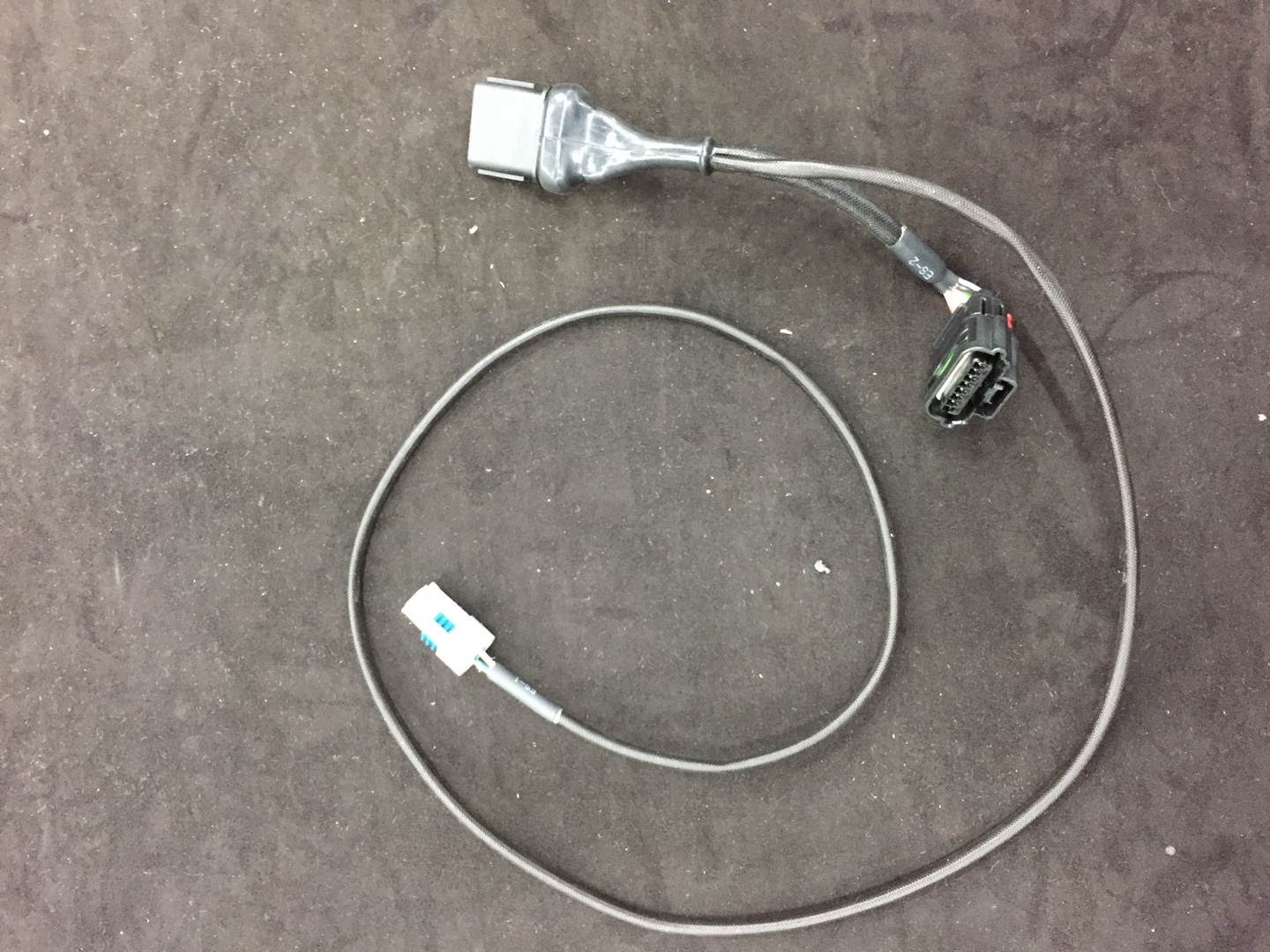

Posts: 191
I got this part left after installing Maggie HB. We could not find any left or missing plugs. Oh, this part was provided from Maggie kit. I am not sure 2017's hardwares are different from 2016. Anybody know where this part should be in??
That is your Air temp sensor relocation harness that will go between your MAF harness and MAF sensor then plug in to the Air temp sensor on the supercharger.
Love it when that happens..... "Where did this extra bolt come from?"....
Aren't forums great. Ted had your answer.

Posts: 191
Yes, uncle Ted helps me a lot. I am still looking for Air Temp Sensor in Superchareger but I could not find yet. I am a handicap who us wheelchair so I cannot look inside of the hood so I am just translating his saying to my engineers so it is an issue. I am a only a person who speaks English but even I am not perfect for English. Anybody tell me where is the Air Temp Sensor in Magnuson Supercharger? It is bit hard to find with instructions only since I cannot look hood inside lol

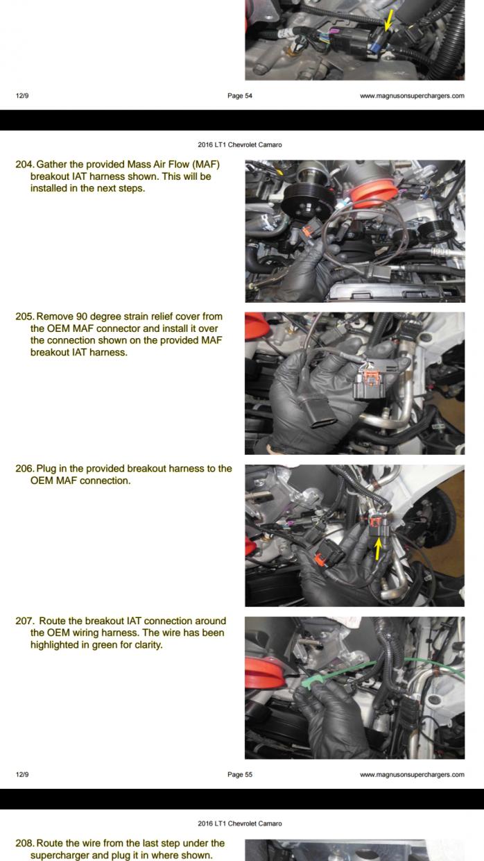

Follow the wiring harness line from the intake elbow to the blower they give you a connector in the kit that ties the maf to the iat sensor located in the blower atleast that's how the eforce is I'm sure they are all similar.

Here is the iat location

The Maggie TMAP sensor is located on the driver's back side of the supercharger head.
You may have to pull the head unit to get to it, not sure though. Get this installed before you drive the car.
And BTW, the E-Force TMAP (IAT) is mounted in the passenger's side manifold adapter over the very back intake port.
