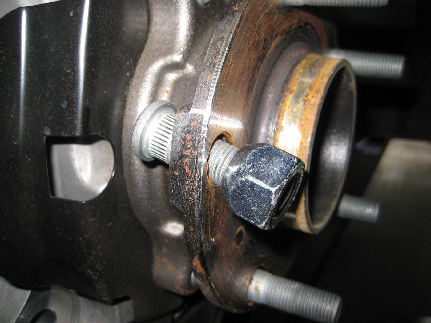

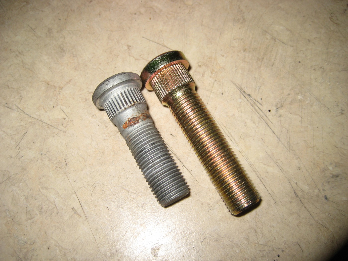

Keep in mind, there are few, if any, spacers less than 20mm with integrated lugs that will bolt on to your existing studs without a need to seriously trim the factory studs. (means no going back). Usually at less than 20mm you replace the factory studs with new longer ones and bolt a sandwich spacer in between. This is not real difficult, but does raise the complexity level a bit..
Studs look like this. Knock them out, install longer ones and you're good..

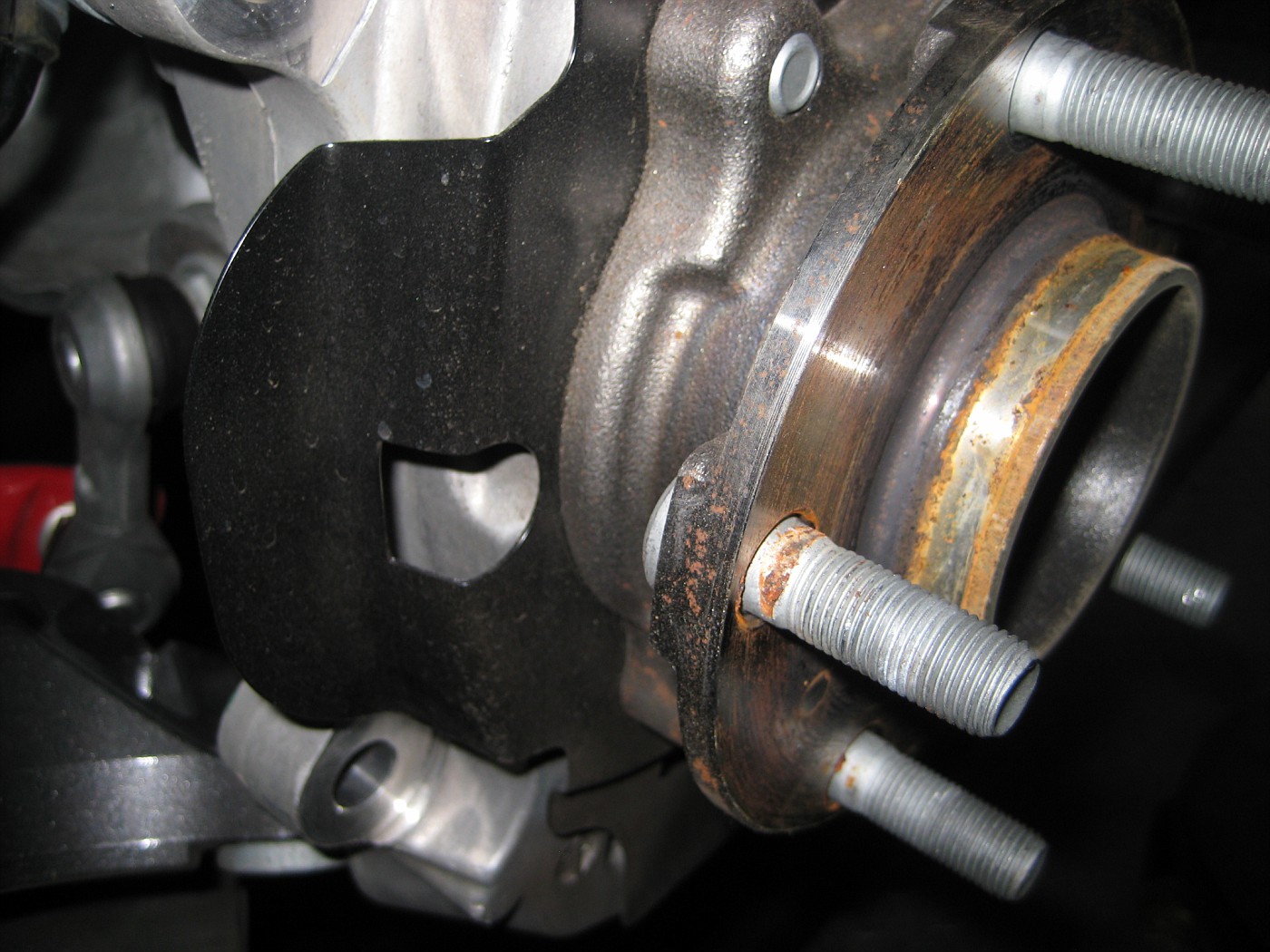

Put a lug nut on the end and pound them out.

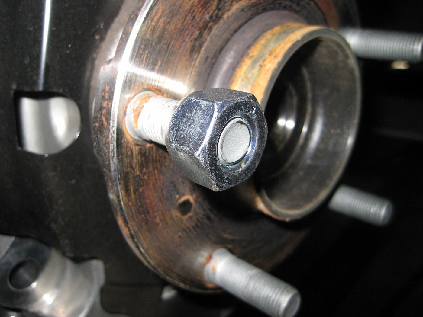

Squeeze the new ones in:

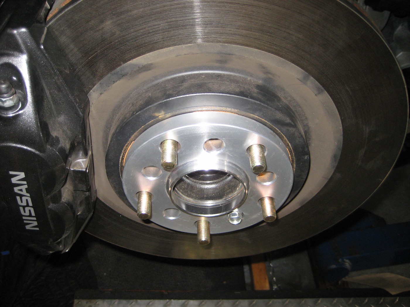

Good to go. In this case with a 15mm sandwich spacer, and lengthened (OEM style) studs...

I have a few part numbers for different length studs. Anywhere from 7mm -12mm longer allowing the safe use of 10mm - 15mm hub centric spacers (sandwiche style ).
