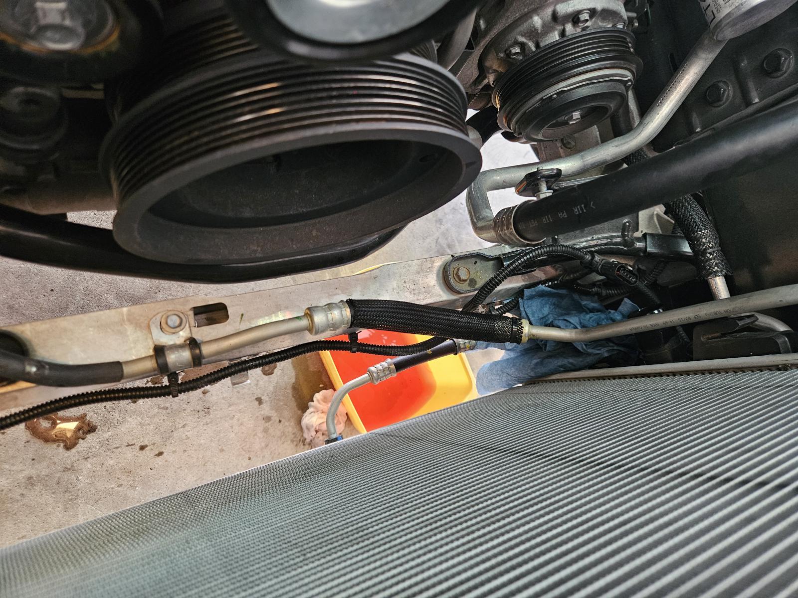

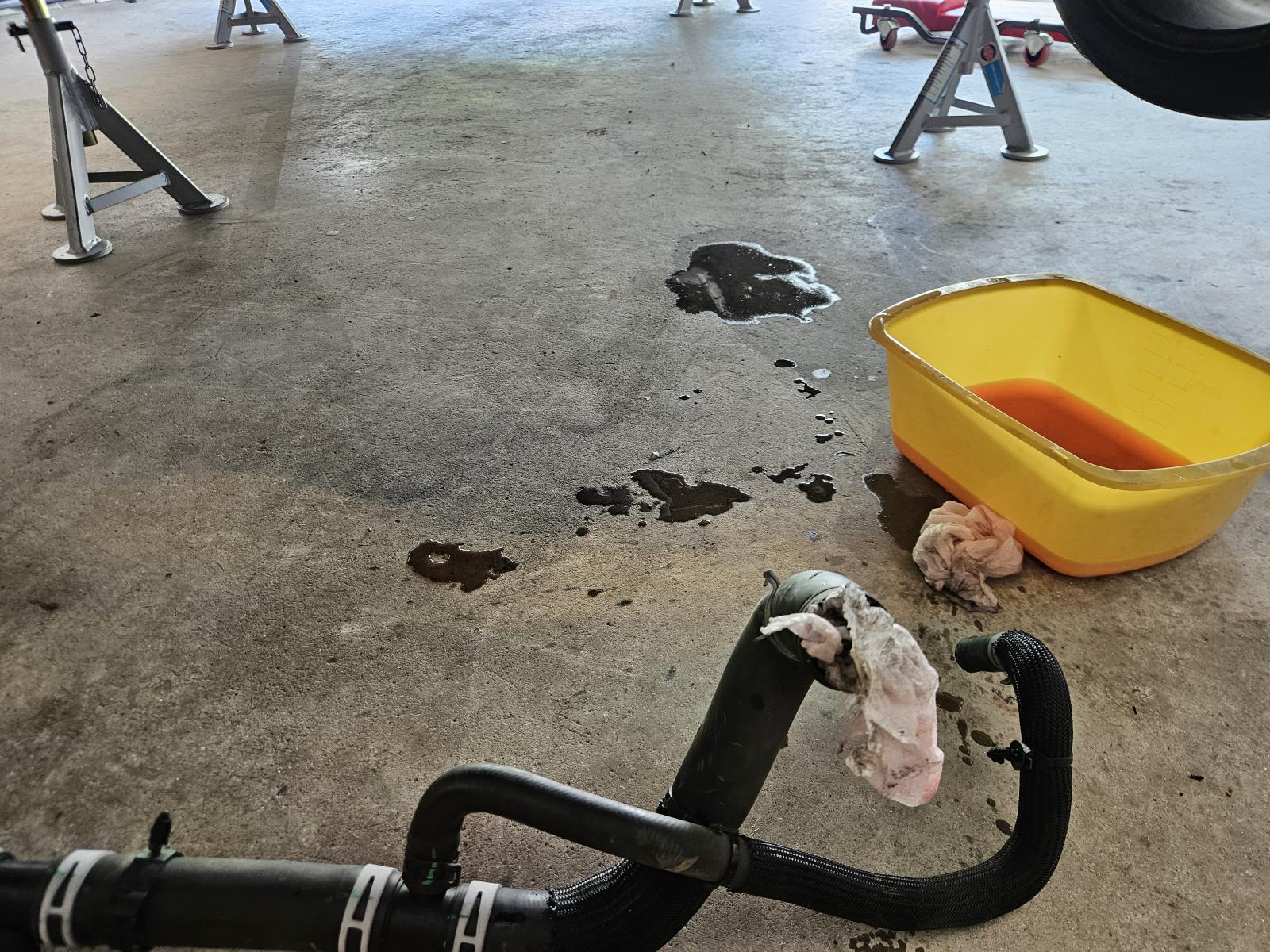

Let me just pause for a moment to express how much I absolutely despise coolant and coolant lines.
That is all.

If you pull the water manifold assembly off the front of the motor, make sure there's a drip pan under there! Still plenty of coolant trapped in the block. Made the biggest mess of all

Certainly felt like it should have been. Coolant kept appearing as if out of thin air.
Thank you! I will pay attention to that when I get there!

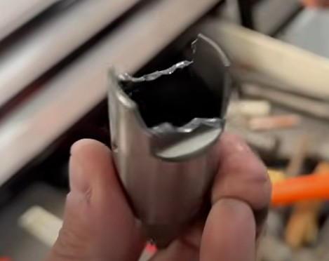

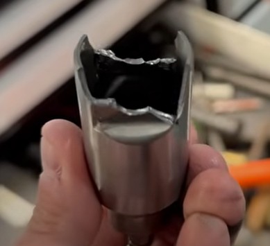

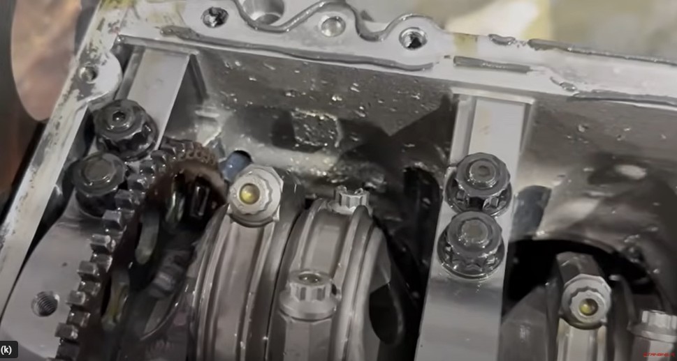

Did anyone see Justin / Stangkilr's Nemo ZL1 that just killed the fuel pump lifter and beat the snot out of the back half of his new $35k LTR motor? Yikes! I was planning on replacing the lifter with a new one, but maybe I'm better off with my old one. Maybe there was an interference/clearance issue in the bore or something, but he said LME has seen a few of them fail. I'm sure it's an anomaly, but dang! I just saw this car in person last month at Vengeance and it put down 18xx on the hub dyno. Really stinks on a fresh build. Let's hope none of us suffer the same fate. Here are some snips from his YT video.

Right?? Maybe he was bottoming out the pump and really stressing the lifter somehow. Who knows? Seems like an odd one-off though. Do most people replace this lifter or just reuse the old one? I was going to get a new one because it slipped out of the guide and I have no idea which way it spun now. I didn't want to put it back in and have the roller rotate the opposite way.

I'm not suggesting that it's appropriate, but it's not a wonder to me why those FP lifters might fail. They're riding on more aggressive lobes they weren't designed for, at probably higher RPMs, too. I'm surprised how they SEEM like the body is stamped; maybe that's just my perspective. If that's right, though, I would think they would make them out of something more robust, but what do I know?

The lifter does look and feel a little light/cheap, but yeah it was designed for a stock lobe and a stock pump, so it's now accelerating faster and traveling farther with more spring pressure on it compared to stock. Probably no wonder some have failed. Plus there may be some post-covid supply chain nonsense mixed in there with just crappy parts in general.
