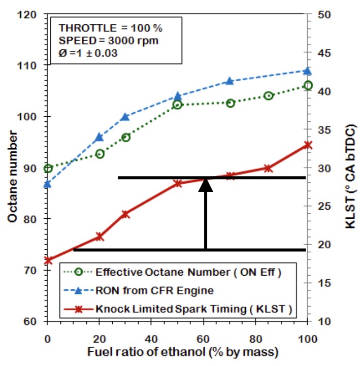

That's the beautiful part of having enough octane on the corn-juice. You can push the timing until you don't see significant power gains, then take it back to where it last picked up power and leave it there, knowing you are getting everything to be had with the hardware you have. You don't have to play the detonation game and ride the edge of the knock sensors to eek out the hp.
Edited to add a neat graph I borrowed from my friend, the internet. I added the black lines and the arrow. You can see the knock-limited spark timing window grows almost 10 degrees from about E10 to about E60. Somewhere in the 10 degree window, you will find your MBT. Thanks, ethanol!
Attachment 1167267
