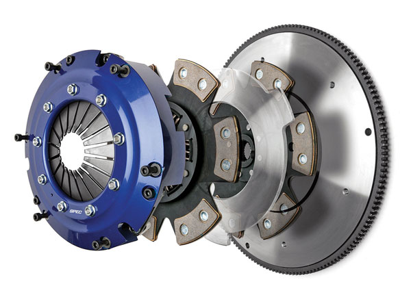

Made my choice of dual clutch and picked out the Spec P-Trim Super Twin. Almost forgot picked up a super damper.

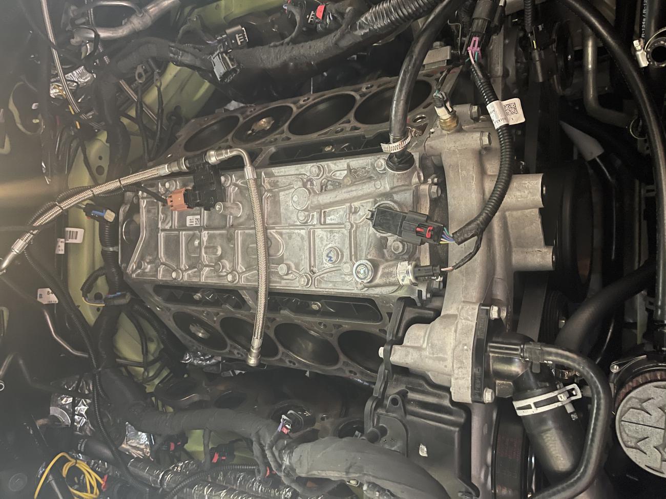

Finally the engine is back in the car after parked for 11 months. What a long slug fest, COVID19 did not help with getting parts and stuff done.

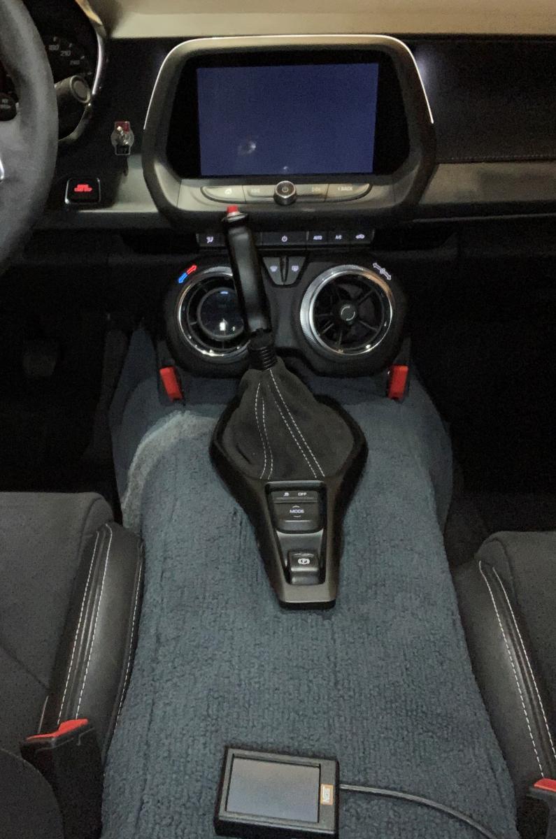

Added toggle switches for line lock and 2 step, in order to do a burn out in the box without two step on. Just cut the power to 2 step with toggle switch. On the line activate both with button on the stirring wheel. Both switches are on the lower part with red safety toggle switches. Plus added a on/off switch for NOS fuel pump just above the engine start button so I avoid dry pumping when do solenoid and fuel pressure checks etc. I also ended up spraying the chrome shifter holder flat black. IMO it just ties in better.

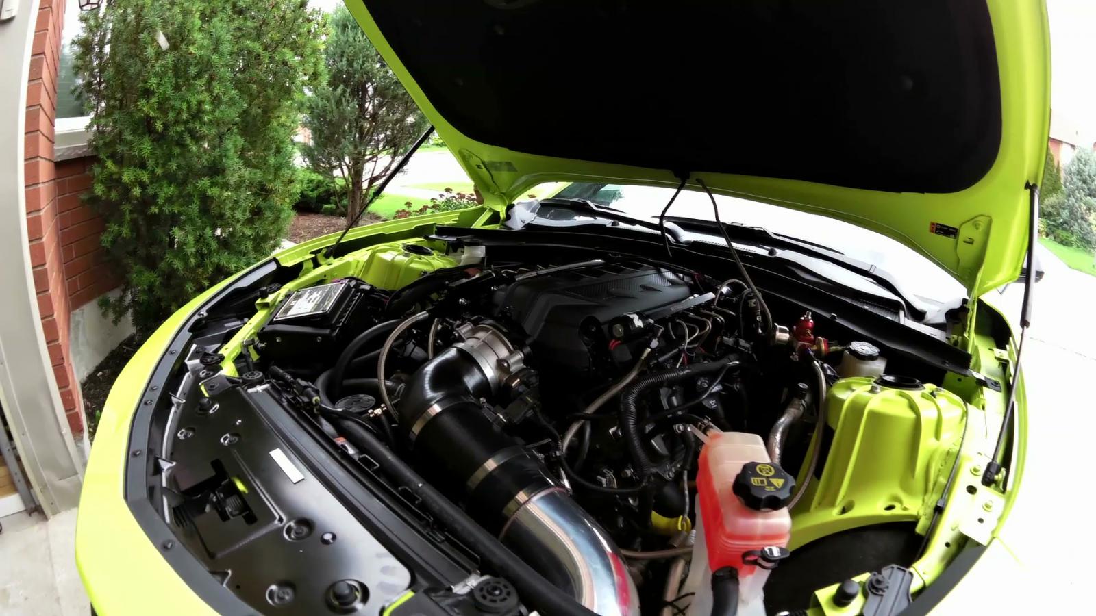

I ended up putting my air intake filter just behind the grille with a four inch custom piping to snake around to the TB. I always wanted to do this in order to get the air filter totally away from the hot engine bay. If you look at pic you can see the air filter just behind the grill. It will help in the cooler months for sure.

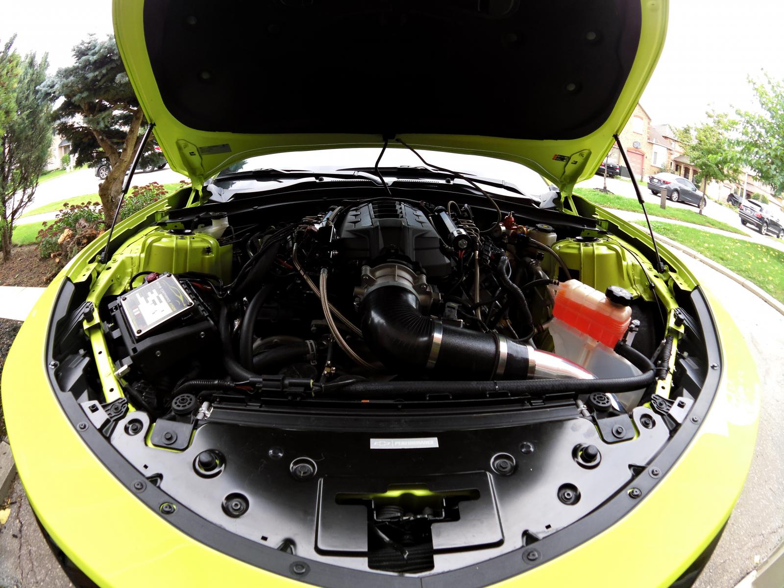

OP: looks like you relocated your coolant reservoir, just wondering why?
Old 11-03-2021, 09:35 PM   #68
BlackbeastSS2
BlackbeastSS2's Avatar
Drives: 2019 Camaro 1LE Shock Candy
Location: Garage
Posts: 1,798
Agreed! Enjoyed reading about this!
Relocated the coolant tank because passenger side is a pain in the ass to check NOS plugs after runs. Just makes it way easier like the drivers side. Plus I was able to pull the lines and wire harness away from the headers on that side.
