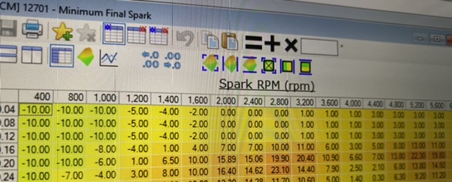

It is the 2019 table exactly. There is additional table that u can set above a certain mph it will cut fuel. So u can copy the 2019 and it will sound very close or exact. I increased the mph/rpm so it does it under 3000 rpm. Over 3k it won't pop
Which 19? At first I was using the 19 auto table and it was a bit much. I found the 19 manual table, it had a bit more timing, and it was more mellow, rolling gurgles, no pops

Originally Posted by 6spdhyperblue View Post
Which 19? At first I was using the 19 auto table and it was a bit much. I just found the 19 m6 table was different and more subtle. I’m going to stick with it
The 2019 file I have is an auto.

Posts: 3,794
This is what I believe to be a 2020 m6
Do you or does someone else have a version of the 2019+ M6 table in a file that I can copy over? Is there somewhere you can download the spark tables by year by model?
Or is everyone just visually looking at it and overwriting hah
The main differences are in the last 4 rows you can see from the previous picture. But you can check out HP Tuner forum and find a stock file someone has posted. U also have to match or adjust the speed at when dfco comes in or it won't change much with the timing alone.
Here is a stock file I believe from a 2019 automatic I found on HP Tuner forum. HP Tuner forum is the place to be, people are great at sharing information as a community and very helpful.
Looks at the top three rows. This is where the decel happens
Ok 17 on top
19 on bottom
WOW My tables are nowhere near to even look like the 2017 tables.
That makes me wonder if my car didn't have a custom tune before I bought it
I ended up copying the entire 2019 tables . I hope it'll work out in the long run. (I don't even have a custom exhaust or air intake).

Have a 2016 SS with stock cat and no muffler with a 3,5 inch exhaust.
In hptuners, I changed everything till row 7 or so. Popping crazy now. Probably a lil too much when driving through cities. I will make it a bit less at certain speeds. But here is a video for those who wonder how it sounds.
https://www.youtube.com/shorts/kqFo7T1Jy_c
Edit: 17.10.23
have the M6, it behaves different than the automatic. M6 revs are dropping faster than on a torque converter I believe.
Anyways, manuals have different values, obviously not that far negative.
In the video above are the values from the newer automatic models, which are to be honest on manual cars way too much.
Now using M6 2020 settings and its perfect, still decent when u want it and u also can drive in peace when u want to
