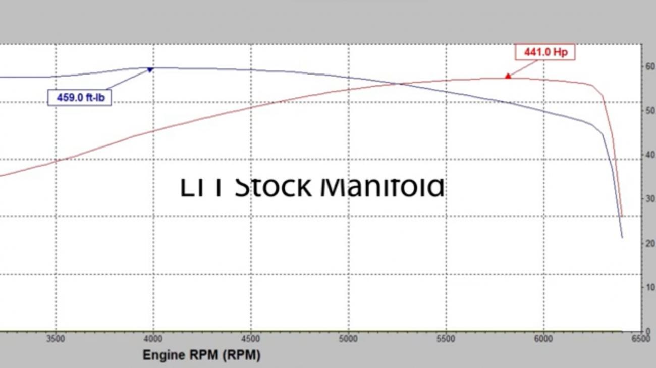

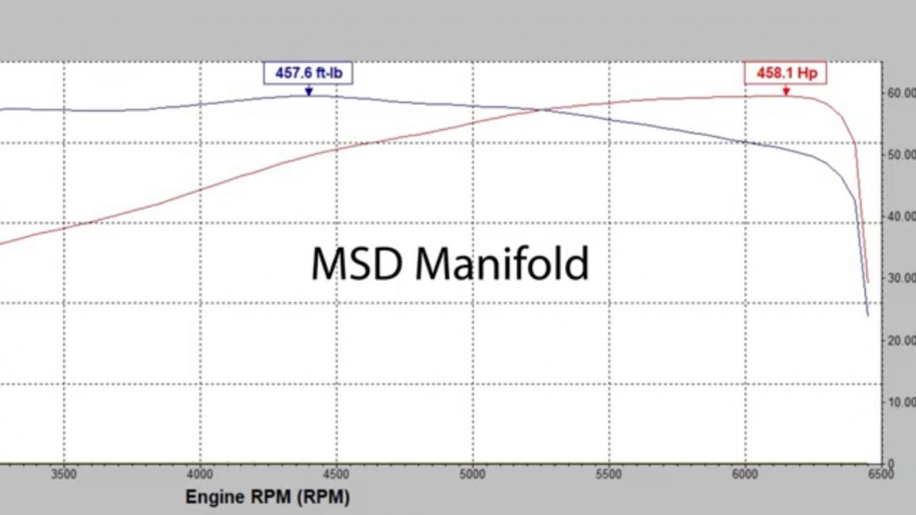

Originally Posted by thescreensavers View Post
LT1 vs LT2
LT1 vs LT2 vs MSD
441 459 Stock LT1
447 461 Ported LT1
455.3 458.8 Stock LT2
458 462 Ported LT2
458 458 Stock MSD
This is what he said in the video.

It has half the power delay of the msd, which is good, but looks like it carries up top like the msd.

Looks like the LT2 intake has basically the same power curves as with the LT1 intake up to around 5500, where the LT2 picks up ~10-15 from there.

It depends on the setup. For a bolt-on car that probably holds water especially for the price, but keep in mind the MSD picks up a substantial amount in ported form. Also with a good Heads/Cam setup, a ported MSD is going to carry the power better up around 7k rpm.
I would assume that as well. You can see the lt2 ever so slightly slope downward as it hits redline where the msd is flat as a pancake. Not enough to make a difference under 6500rpm but just using that tidbit to make the assumption that on a cam’ed car revving way past 7,000 the msd will likely be stronger. Lt2 intake looks like the winner on a bolt on and likely a street focused h/c shifting at 7,000.
